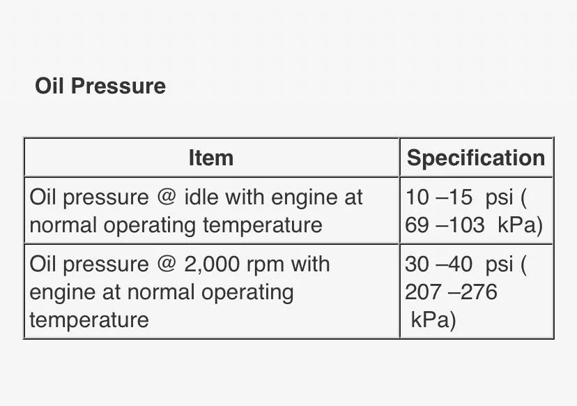

What exactly is normal oil psi range?
Ford just told me they couldn't find a leak from the engine, but there is oil coming out of the frame rails. They said drive it for 1000 miles and bring it back to see if it's still losing oil.
The oil psi specs below is for a bone stock S550 Coyote 5.0 right from Ford:
That PSI info is also based upon the standard recommended oil for the 5.0 Coyote.
Did the car have a recent oil change - and if so did the Tech perhaps miss the fill hole and spill oil down the engine?
Do you have a way of getting it safely on stands, ramps or a lift to really check around the engine - oil filter, oil sensor above it, spacer plate between trans and engine block, oil pan, etc??
