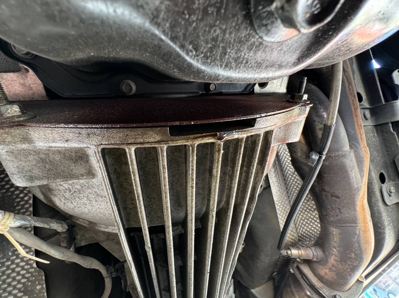

Hey everyone,
I’ve got a 2016 GT that has some leakage, pics below. The car has had a rough life… built and shipped to Italy where I drove her HARD, then to Germany where I drove her even harder.
The first oil change ever done on the car was at an Italian Ford dealership and the kicker was they didn’t put much if any oil in when they changed it, didn’t realize till I was getting intermittent CEL and surging at highway speeds. Definitely drove it to Austria with that issue… anyway, that’s just some backstory of the poor life this car has had. Unsure if related to this leakage, though the burning oil probably is.

Leak from inside of the bellhousing like that is almost guaranteed to be the rear main seal. Not a cheap repair.

Hello; I am with others on the leaks. Very likely a rear main seal leak. Not necessarily from running hard but possible. More likely as a WAG from running low on oil. Might have been some occasional starvation of reduced lubrication from low oil. More likely from loss of cooling effect with low oil. Oil is one of the ways an engine is cooled.
Will have to go deep to do the rear main seal as the transmission will have to be removed. Maybe the oil pan also. So may as well figure on a rebuild, a new long block or a replacement engine.

Definitely not bragging lol, it makes me feel dumb knowing I didn’t check. Just giving context as to why I wouldn’t be surprised if it was a catastrophic failure.
