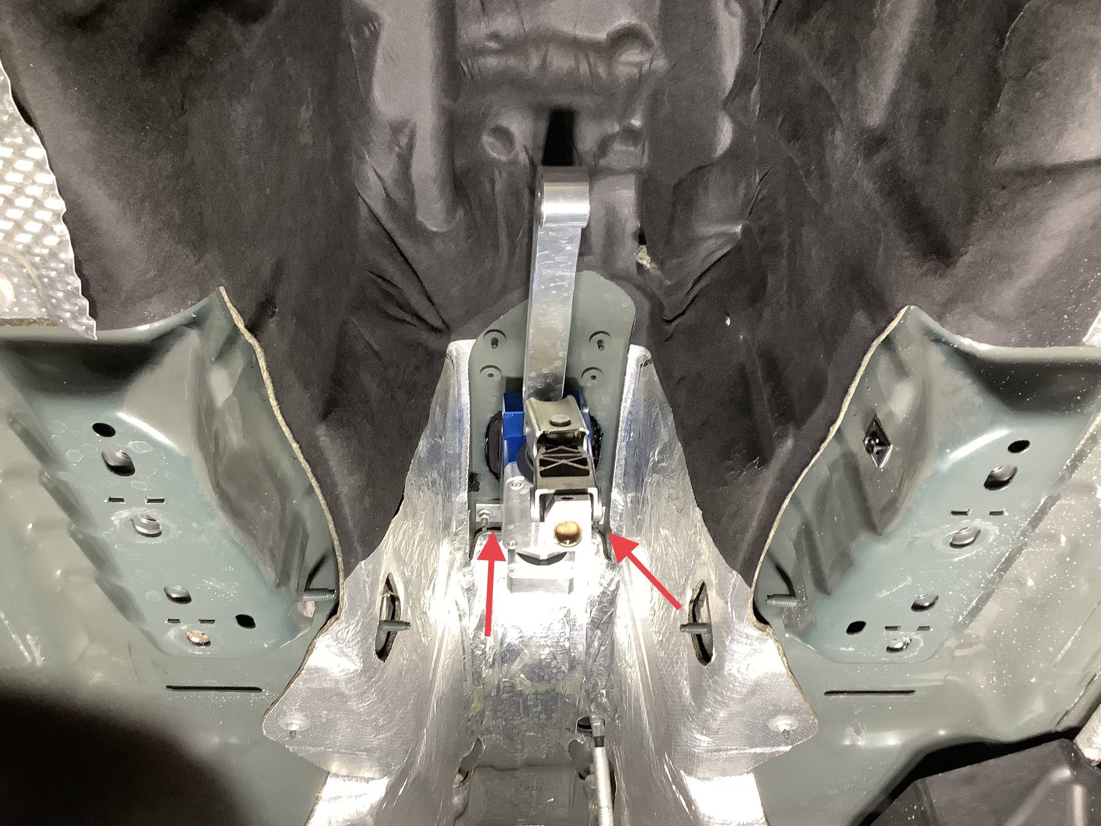

One other thing that comes to mind regarding the shifter moving around. Check the shifter support bracket nuts. They could be loose, allowing the shifter to move around. See pic with red arrows pointing to the two nuts I’m referring to.
Excellent point! I will have it check it out, as I don't think I can crawl under the car anymore....

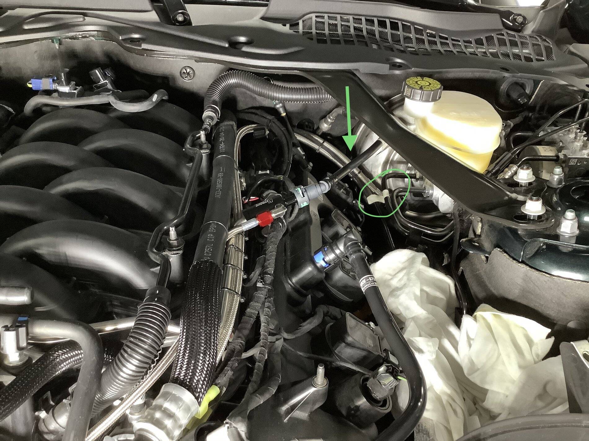

@2019 Dark Highland Green can you look underneath the hood in the area of the brake booster and see if you can locate a stainless steel braided clutch line? If there is one, that means the previous owner installed that as an aftermarket part, as the factory clutch line is plastic. That would also be a reason to ensure that the clutch was properly bled down after that install.
See green arrow pointing to the top stainless steel braided clutch line and green circle around the end of said clutch line that connects to the master cylinder.
Thank you for the great photos. Ford says I have a broken shifter..
You’re welcome. If possible, can you ask the dealer to take pics of the broken shifter and then post it here for us to see? Thank you.
I will request the part back since it is not covered under the powertrain warranty naturally and will post photos...
