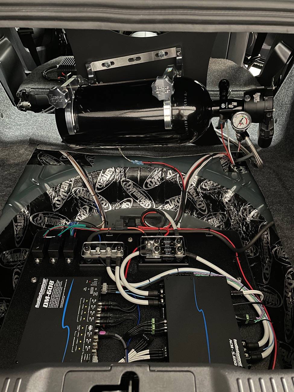

Keep the factory head unit, add an AmpPro FD21 amp interface, Toslink add-on and run a fiber optic cable to a DSP and the DSP to an amp, change the door speakers to Hertz DSK 165s, and replace the tweeters in the A-pillars, install a sub amp, upgrade the sub and call it good. There was someone on here selling a new JL Audio Stealthbox and AmpPro for a very good price.

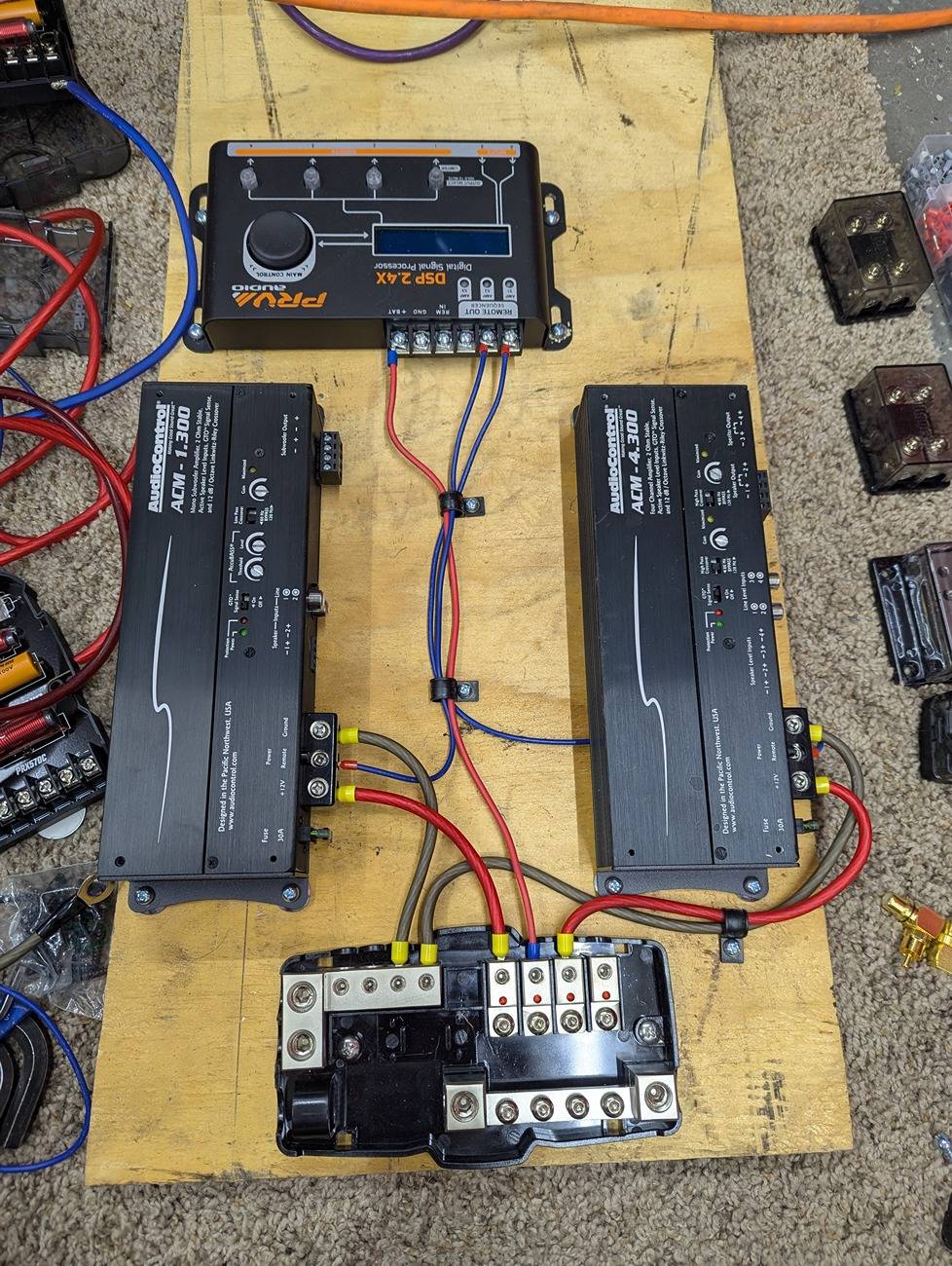

I like your choices....this is my setup for my 95 Cobra I'm working on

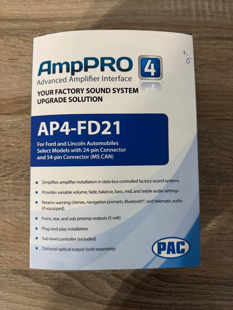

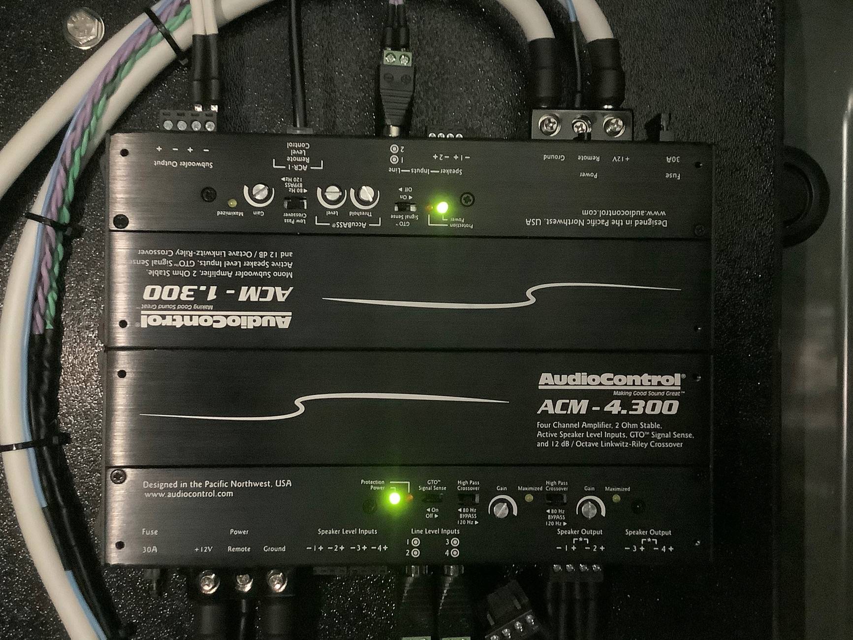

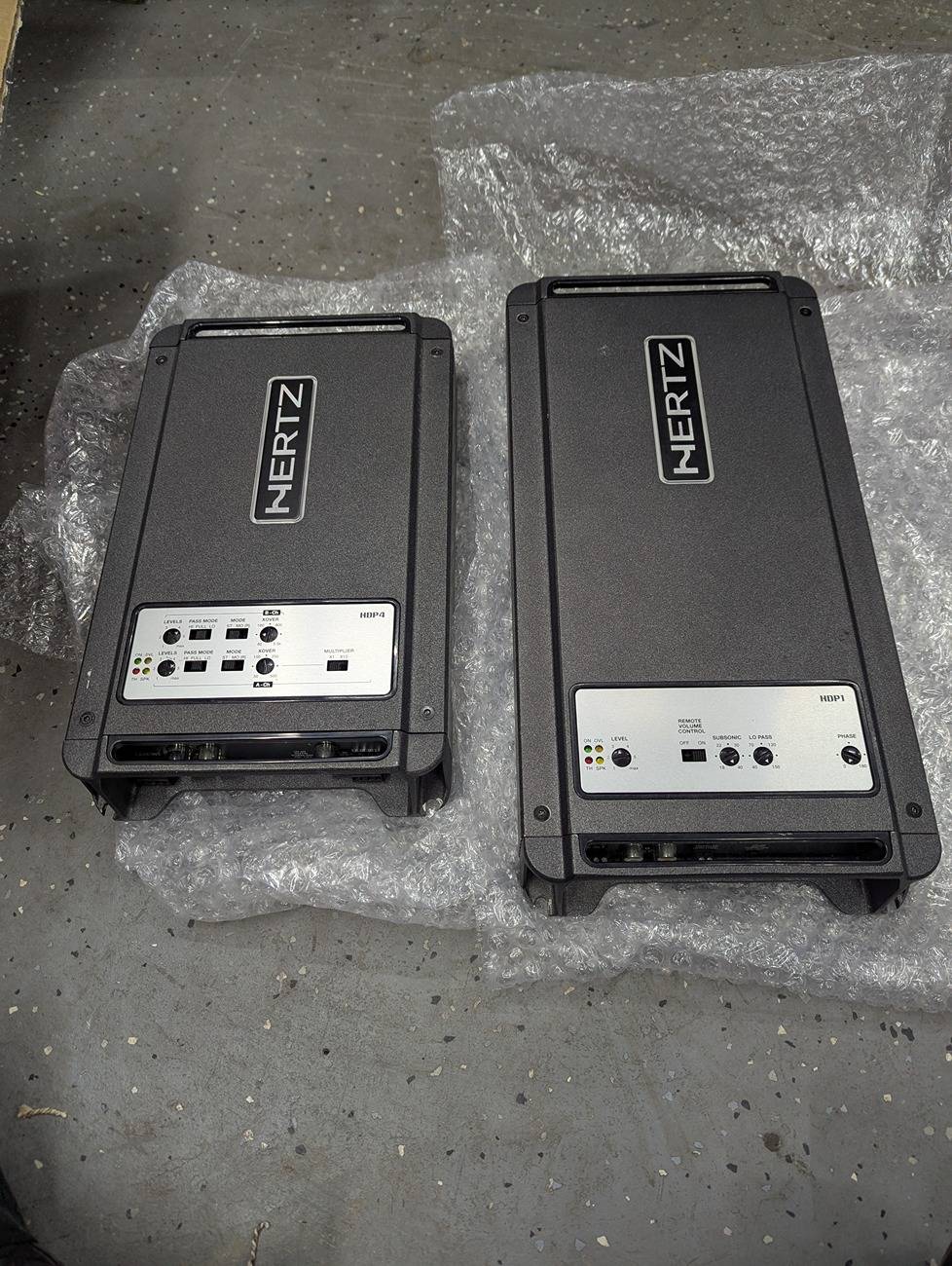

I guess I am wondering....I keep reading on this site on older threads that the signal coming from the head unit is trash. Is this not the case???
Also I have these laying around that I can use:
My signal is clean. No issues or unwanted feedback/hissing etc. I used a single fiber optic cable instead of multiple pairs of RCA cables.

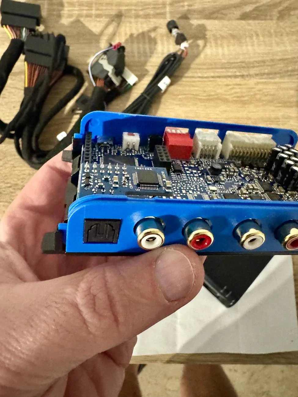

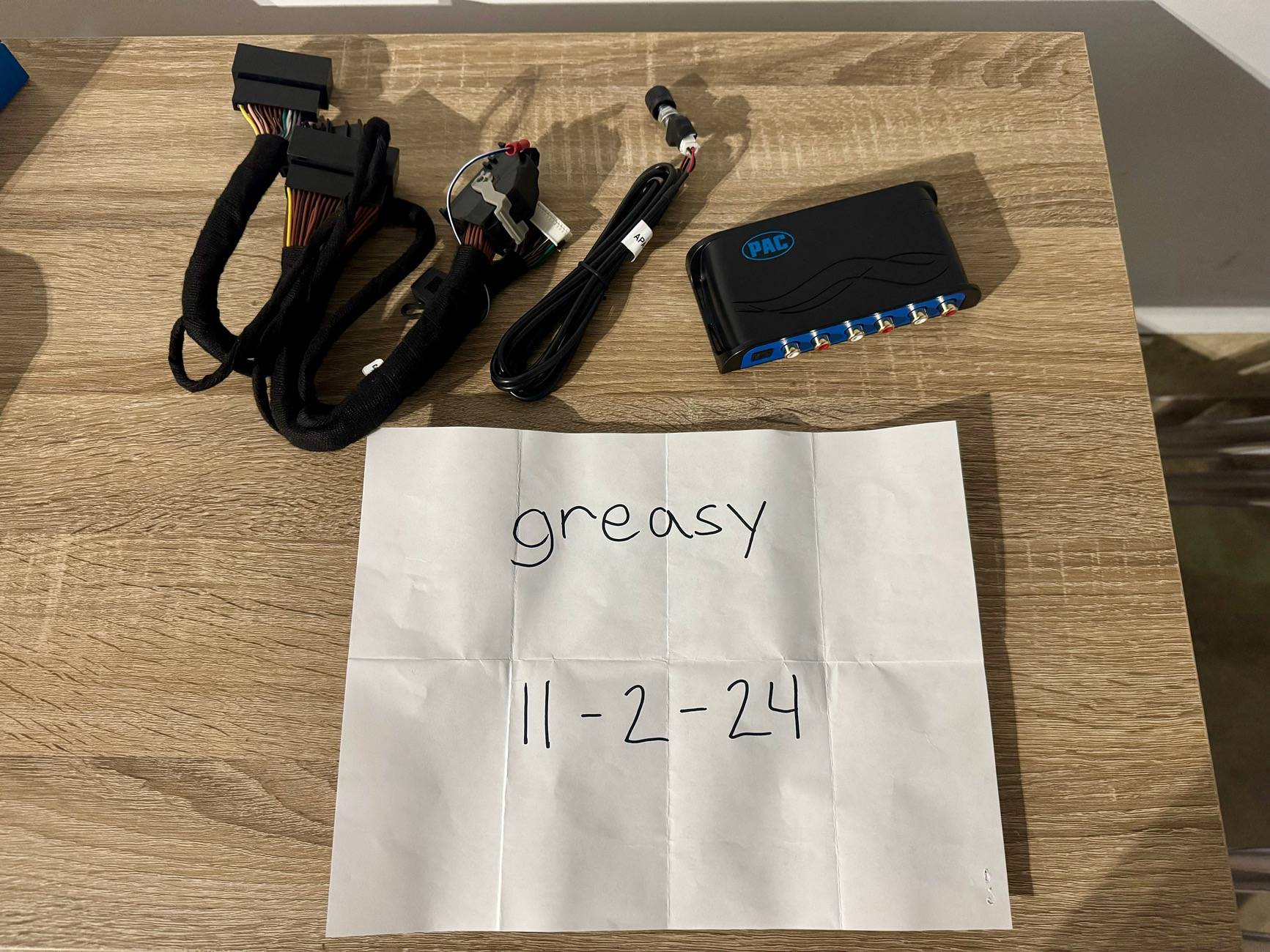

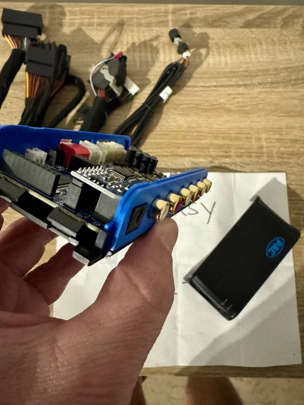

Already bought the module and wiring harness from @driden brand new in box

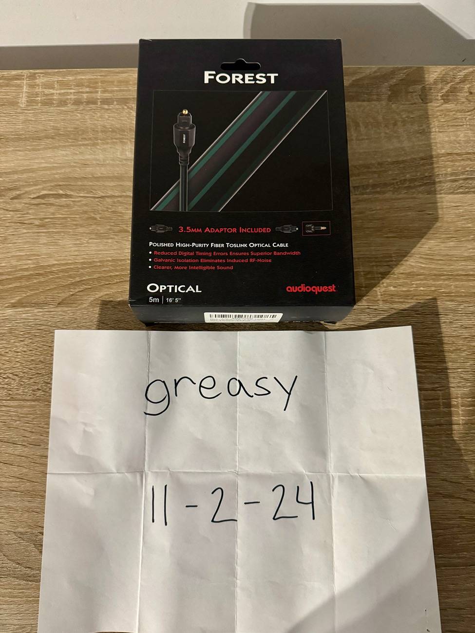

I have never run an optical cable in car audio as I have not had the option....but I like that option for this application. I will have to purchase one.

@greasy I do need that APA-TOS1, but I will just buy elsewhere as I am sure you are not looking to just sell the adapter.
