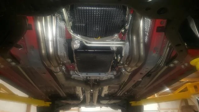

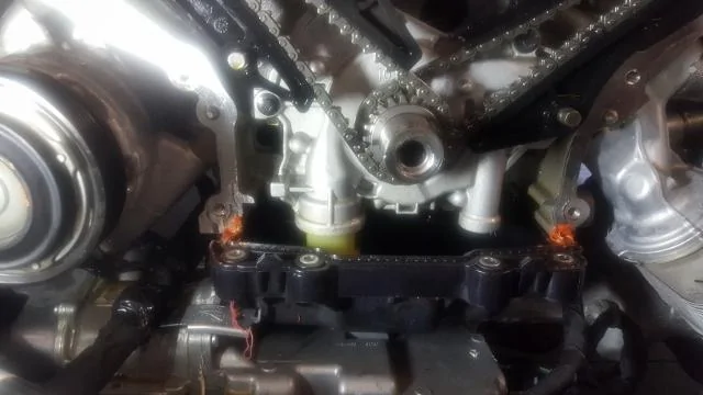

I am halfway through the process and have upgraded the OPG and timing gear.
I can tell you the OPG sucks. There are several additional steps for the install. The passenger head has the DI pump and lines and an additional bracket on the back you have to remove. I also had to drop the oil pan so I could get the new pick up tube out of the pump.

Did you have to remove the pan completely or could you cheat it and just lower a small amount?
I drained the oil first and dropped it an inch in place. Its not bad but there are a couple bolts that suck.

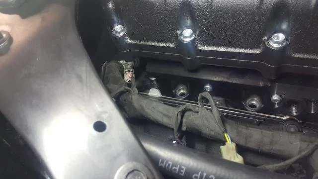

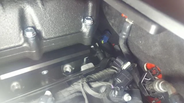

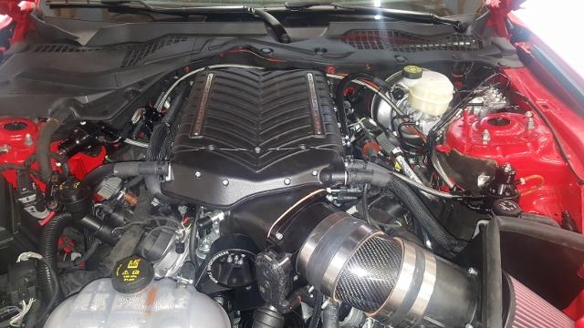

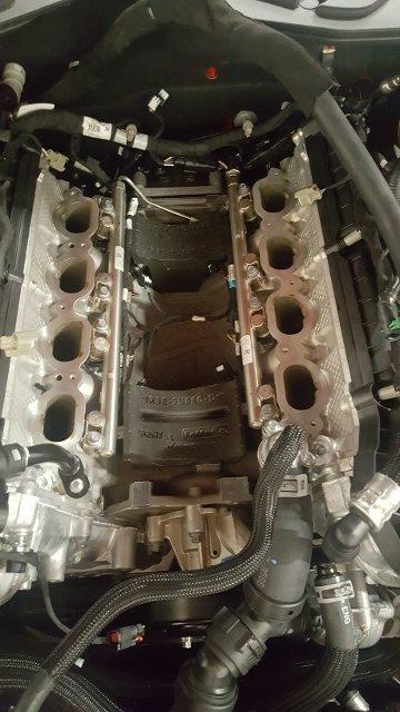

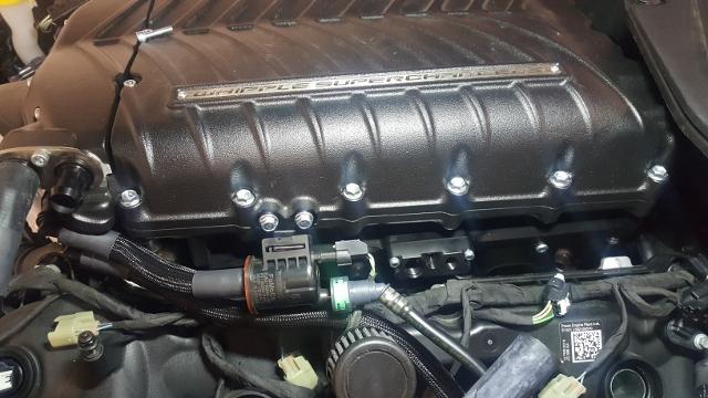

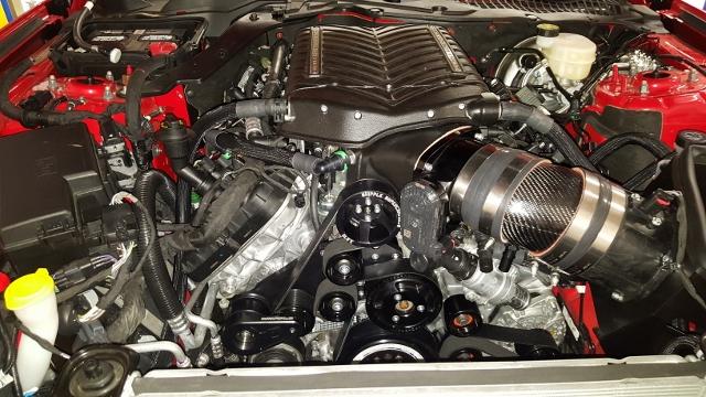

Finished it up today. Here are some pictures I took along the way. The first couple show the fuel rails and the room needed for the fittings. You can't use the Fore rails. I worked with Fore today to customize the fuel system for the Whipple 3.0 kits. There are several fittings needed to make it correct.
We can match any price out there on all these parts. IF YOU ARE LOOKING TO GO BOOSTED reach out for a package quote! Plus we have awesome phone support and the experience to back it up!

Looks damn good Chris. My blower hasn't come in yet but my $2500 Fore fuel system did. I don't understand when you say the fuel rails don't work though. When I saw Anthony's car it had rails BUT I cannot say what kind they were or if he modded them. Either way man I'm excited to see how yours performs as well. Thanks for the updates and pics.
