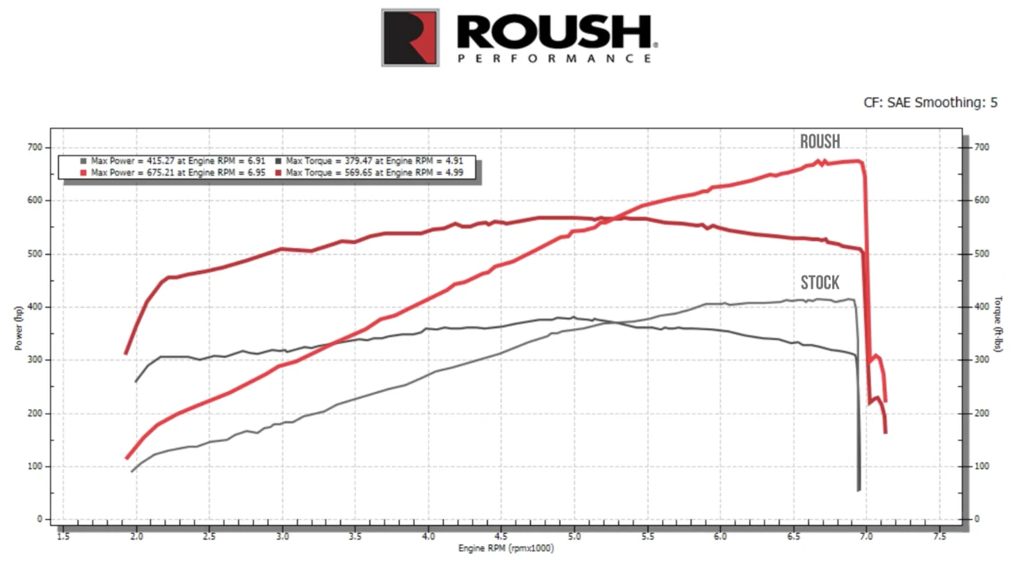

The CARB Roush Stage 2 claims 750, even if that’s to the crank you’re still 700-ish to the wheel…
You live in the world of 7% drivetrain loss?
They have a 675hp dyno on their site on 93
