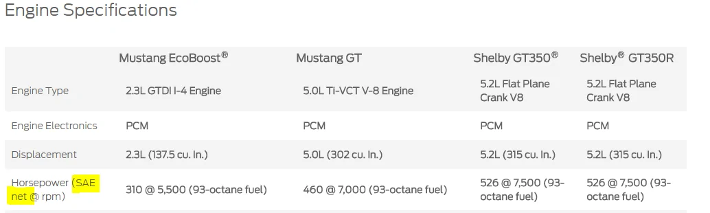

Has Ford specifically stated that it produces 460 HP SAE J1349 certified?
I looked through the website and it just has * Specifications subject to change without notice, and 93 octane fuel used for the test, bla bla bla. If they don't say J1349, then the whole 1% argument is moot.

Screenshot from their site.

They must not show all years/models. Searching the table, there is no entry for the 2015-2017 5.0L Mustang. Only shows the 2015 2.3L Ecboost 4-cylinder.
It is voluntary. There are a lot of engines not on that list. From the SAE website
Manufacturers who advertise their engine power and torque ratings as Certified to SAE J1349® or SAE J1995® shall follow this procedure. Certification of engine power and torque to SAE J1349® or SAE J1995® is voluntary, however, this power certification process is mandatory for those advertising power ratings as "Certified to SAE J1349®".
So as I read that if it does not specifically say "Certified to SAE J1349®" then it probably isn't and all the discussion of +/- 1% is moot. There is a difference between stating SAE net HP and stating "certified J1349".
