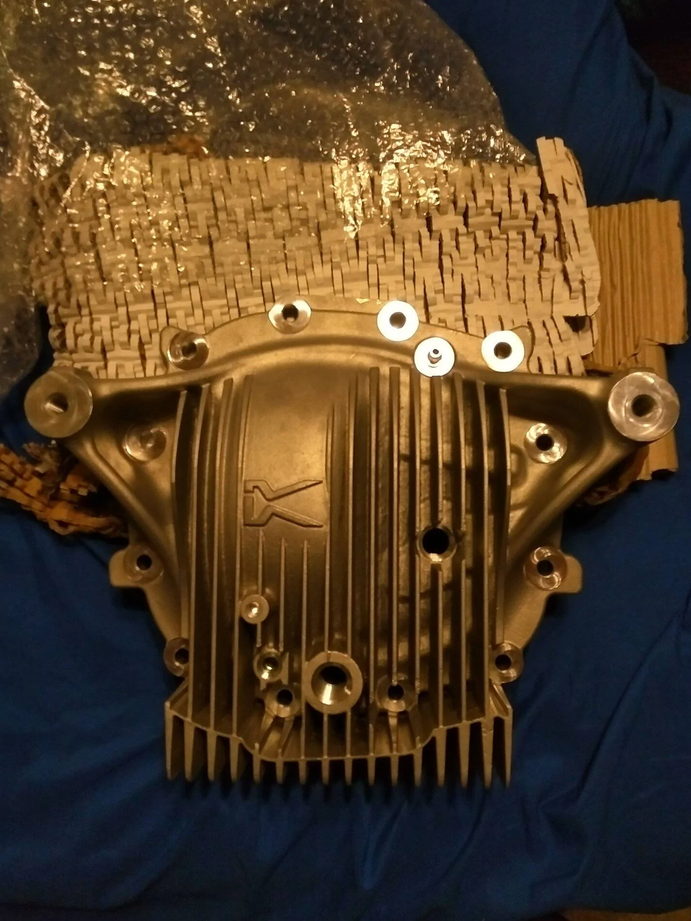

I bought one

Just snagged one as well. Looking forward to receiving it.
I'll say that so far the vendor was excellent in terms of answering my questions, proactively providing info, etc.
For context, after wrapping my exhaust and swapping diff fluid to 75W-90, I only got the warning once. I've done June at Road Atlanta, September at Roebling Road with no issues. The warning came for at Barber in August on one of the hottest weekends last year. Afternoon session, probably 12-15 minutes in.
To me, this suggests I'm not getting the warning by much, so this cover should keep me out of the red

Have any of you guys gotten your finned cover installed yet? One thing I'm concerned with is contact with the exhaust considering how many different options there are.
GuardEcoBeast
May 5, 2017
212
71
AR
Guard 16 Ecoboost
Its not any wider than the stock cover. Why would the exhaust matter?
Brazos609
Jan 22, 2018
720
271
2015 GT Premium PP Recaro
Because it extends down, under, and forward of the stock differential cover.
