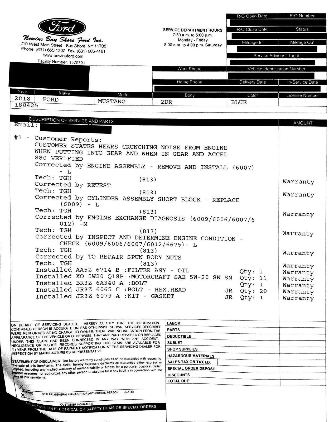

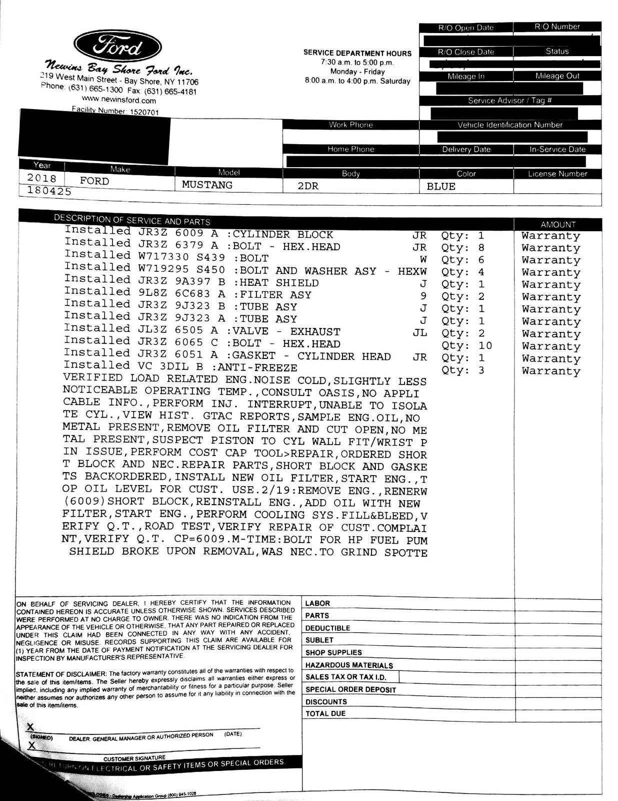

Update:
Brought the car in on January 8th, which means it took about a month for the new short block to arrive. Car was in the shop for 4 weeks during the install. It looks like the mechanic snapped a bolt during the reinstall, which added a week as they waited for the new bolt to arrive.
So far, everything seems fine with the new block (as it damn well should). I have about 300 miles on the new motor, going through the break-in period again for the first 1,000.
I've attached the repair order with the mechanic's notes and all the new parts installed under warranty. It looks like he suspected it was a piston to cylinder wall fit/wrist pin issue, and after doing a cost analysis of the repair he determined it was more efficient to just get a new block. At least, that's my interpretation of the mechanic's work notes.
And that's it... My dealership was very accommodating, paying for a rental car and providing a loaner when one became available. Anything else I should be on the lookout for now? I'm not sure if I feel satisfied or just more paranoid after all this...
Do you know if your shop tore down the original engine and investigated, or did they just sent the old short block back to Ford. Glad to hear you're back on the road, hope the new engine is a good one.

Doesn't appear they found a smoking gun in their ro notes. Did they share any other theories with you or just the the piston pin or cylinder wall clearance
What I shared is what I know. I wish I knew more, but I have not spoken with the technician since the work began and my service rep doesn't fully know the extant of the tech's work. My experience with the dealership felt more like a routine oil change or something, albeit one that lasted a really long time.
Next time I'm in for an oil change, I'll definitely be looking to speak with the tech and get his take on it.
