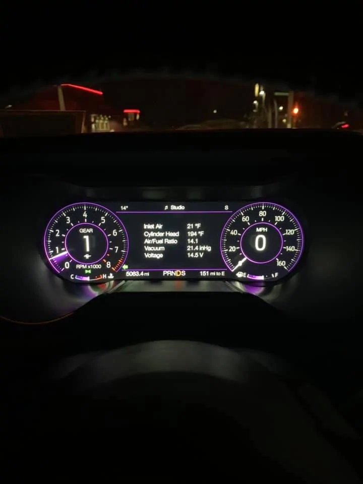

Ok I must be loosing my mind here but how the hell do you get to this screen with the LCD cluster? The gauges are nice but are about as useful as idiot lights...
prj_tchalla
Jul 10, 2016
38
Georgia
2016 Mustang 2.3L Ecoboost Convertible
You scroll up and down and it shows up. You need to be in the Show Gauges mode the scroll

If you don't get that screen, then your firmware is like mine. I don't have that screen but I can scroll through all of my gauges regardless of what I set as my three and I have an oil temp gauge.
Haven't checked for an oil temp gauge but I certainly do not have that screen.

When your on the screen of gauges in the dash, scroll with the down arrow on the upper right side of the steering wheel and see what comes up as you press it up to the point of returning to your first step.

Oil temp gauge present so I have the older firmware.

Well you have an older breed as I do. U can have the firmware updated to get the line gauges but you’ll loose the oil temp gauge. You also won’t be able to scroll gauges anymore if u upgrade. It will show the three that you choose and then move to other pages.
