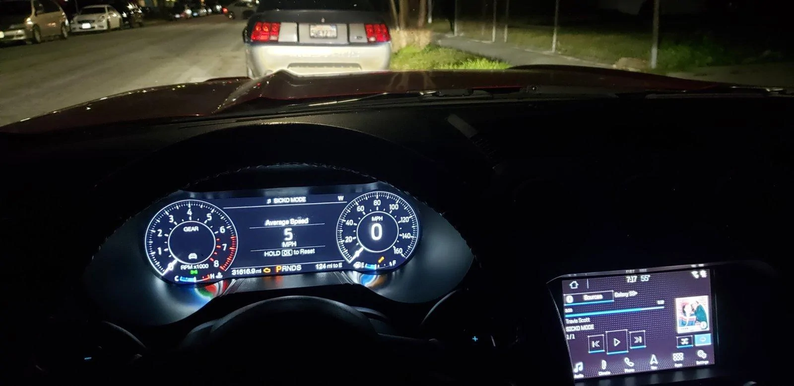

Finally got mine programmed! Surprisingly, the 4th toggle on the tesla radio controls the different modes except I get error messages. Only the drag strip mode seems to work.

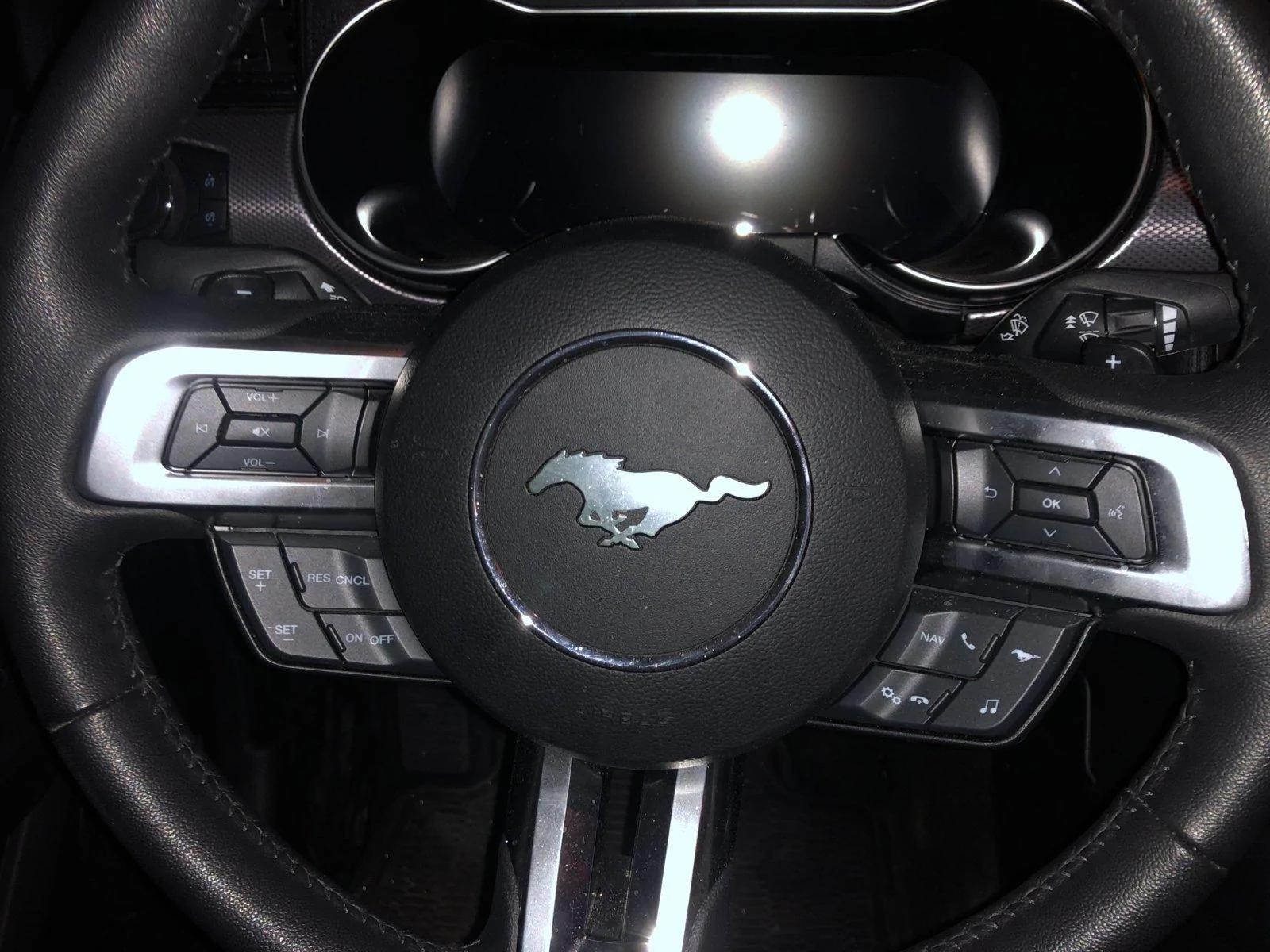

Finally installed my cluster today, havent programmed it .
For some odd reason my "ok "button is now the mute button. Anyone else have this issue?
Did you change out the steering wheel buttons to the 2018 steering wheel buttons
kilos550
Jan 18, 2019
los angeles
Kevin
mustang gt 2016 premium
yeah i changed them to the new ones,the ok button is now located on the right side of the steering wheel.
Also my pony button doesnt do anything yet ,you think this is because its not programed or did I mess up somewhere with the switches?
you need to program the sccm module
Ya I’m sure it has to do with the programming here is mine
