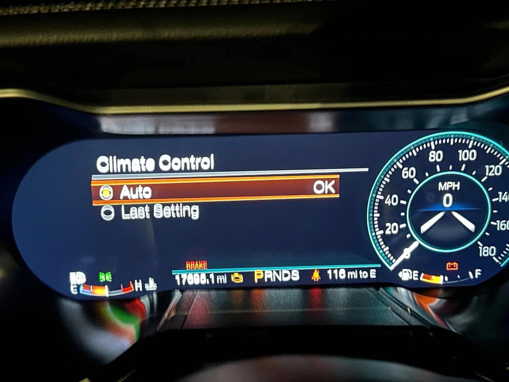

If anyone has this menu related to remote start settings in the cluster and won't mind helping me.. All I ask is, in cluster settings find remote start settings, and there should be setting for heated/cooled seats to switch between auto/last setting. Put the setting on Auto, and dump BCM, FCIM and IPC asbuilt. Then change the setting to "Last setting" in the cluster, reconnect the forscan to reload data in the modules and dump these 3 modules again. Send me them and I will try to compare files, I believe it should change something (for example tinkering with lock settings in cluster changes BCM values too).
Why?: my car has no remote start support (EU version) and even when I tried to enable remote start in IPC I couln't get it to show on my dash... This setting is responsible for automatic heated/cooled seats coming up based on ambient temperature but not only with remote start but regular push start too. I've been trying to disable it for months now.. Thanks
