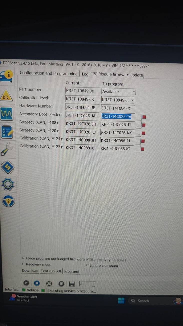

@breeves002 I'm trying to flash the digital cluster to manual but I don't have the file names (so I can download them from motorcraft) you got any idea where to get them?
Pretty sure that will need to be sent to him to flash... Only a few people are able to do what your asking... I had to have my done before installing... Auto to manual here also...

You 100% sure? I had to have mine flashed to fix from auto to manual. Was also told that needed to be done from going to mph from kph also. That is also how they apply the bullet Speedo info to the dash using another BIN file.
I understand that with this version of forscan im able to flash firmware to multiple modules (forscan 2.4 beta) I just want the file names to be able to flash them
This will not work to change it to manual.
