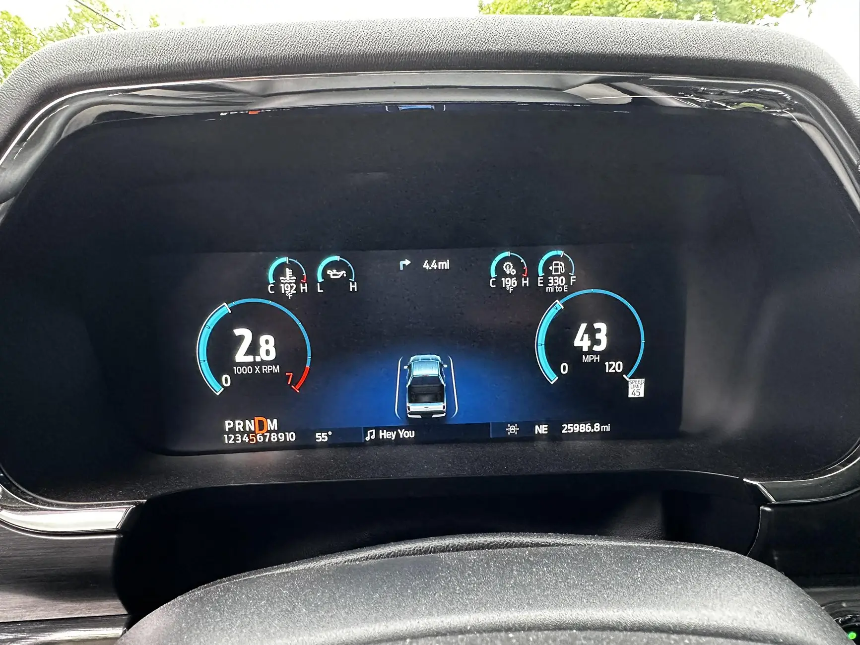

Got my hands on a Mach 1 digital dash. I assume the main difference with this one is the unique start up display animation and 180mph speedo similar to the Bullitt?
