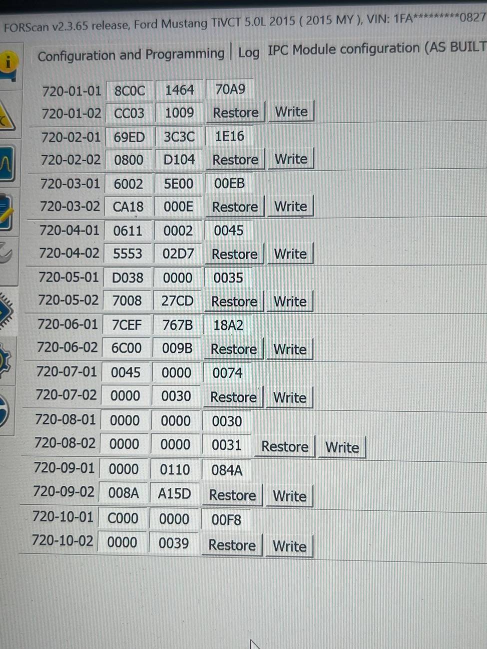

Attached is my code, my RPMs work, everything works perfectly except for one thing.
It’s an Manual.
I drive an Automatic and when I set it to automatic from my ABD, it changes to it but i have no working RPMs.
Please advise !

720-03-02 CA18 000E
That value i’m currently messing witg because it changes from Auto to Manual,
auto has no working RPMs,
Manual has working RPMS…

720-03-02 CA18 000E
Is this set correctly?
I had auto cluster to and the RPMs did not work until I changed this.
720-07-0200000030CRITICAL FOR RPM
