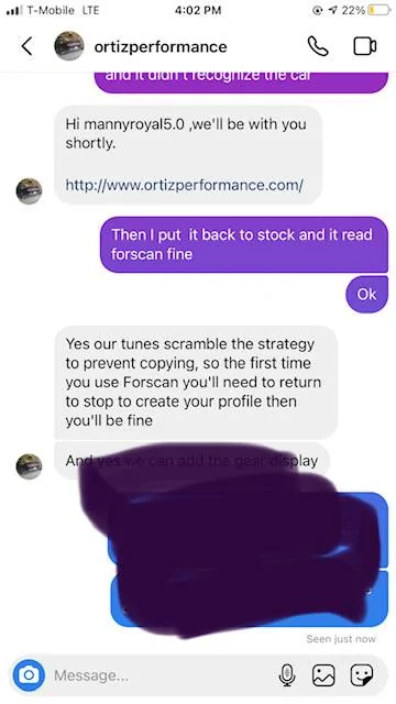

ok cause i hooked up forscan and it could not read my vehicle it asked if the car was tuned which was bizzare cause before i tuned it it read my car fine

Yeah so turned the car back to stock and it worked forscan was able to read the car again
So, it sounds like your tuning device also changes something that Forscan depends on. What device are you using? Tune from?

have a chat with your tuner. He may be scrambling stuff to "protect his intellectual property".
That doesn't make sense. Who tuned your car and with what device?
