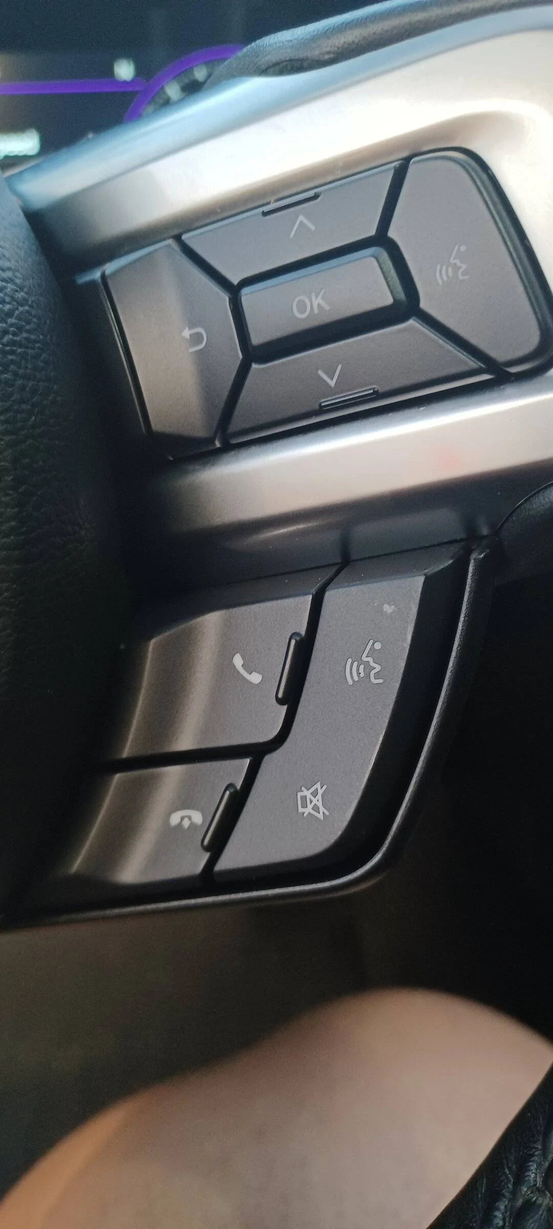

Did the swap today and just realized they sent me the wrong switch . Also I used a pre made file forscan and one module said it was wrong but wrote it anyway . So I need that switch too change modes and my cluster?
Yup, you defiantly need that switch to control just about everything in the cluster.

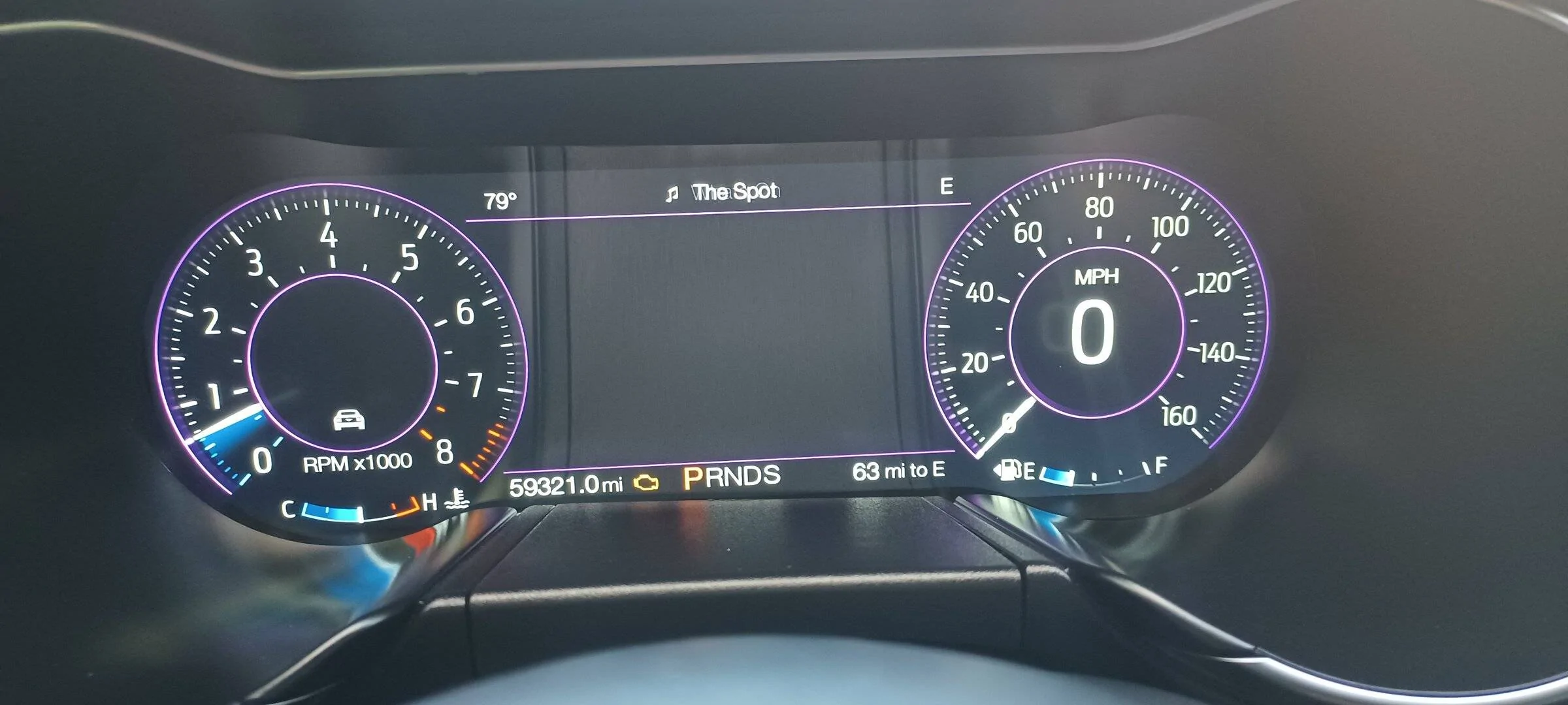

also getting a P2068 code.
Check engine light is on this have anything to do with forscan? it must be since this wasnt on with my analog dash
thecloneranger
Apr 26, 2017
66
379
156
houston texas
2018 royal crimson mustang gt
After installing the cluster and writing the baseline changes with Forscan, I noticed that the fuel level is reading weird. I looked a bit more into it, and the car is throwing error code P2068 which deals with reading the fuel level. I can't say for sure this happened exactly after the Forscan programming or even the cluster installation, but there was no engine code prior to the installation and the analog cluster read 100% accurate.
In some of the previous posts, I read it took a couple of fuel tanks for some cars to relearn the fuel reading. Has anyone had this or anything similar happen?
