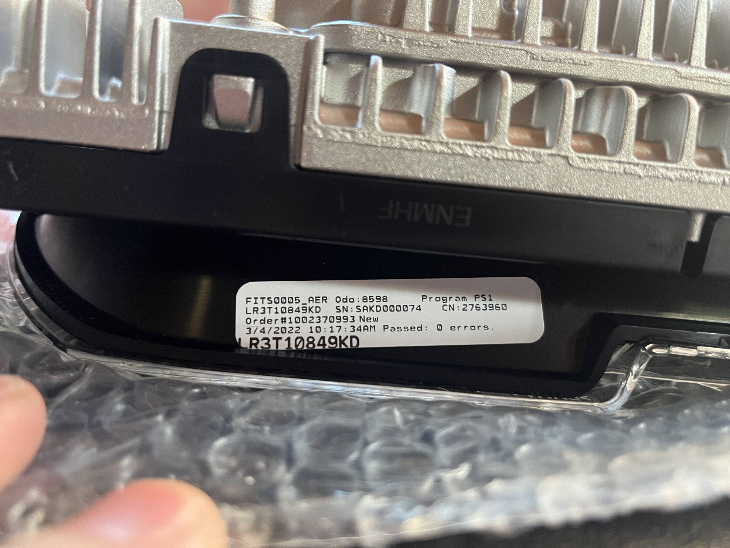

Question, I’m about to install my new cluster that I ordered, but wanted to confirm there wasn’t a mistake made - does this sticker (see attached) mean the odometer is set to 8,598km? From Ford? My mileage is only 4800km. I’ve read that these can’t be “dialed back” only forward.
Does Breeves just order them from Ford with a random mileage and then change it to the correct milage I’ve told him when he receives it? I’ve also read that he is able to dial them back somehow.
I’m just double checking before installing
Ferrcad
Not knowing Breeves process but did you provide him mileage when ordering the kit? You would probably need to reach out to him and find out the answers to your question. I do know that Forscan allows an increase of mileage not decrease. Normally Breeves and a few others have tools to flash the firmware of the dash to zero out the mileage and then you increase via Forscan on install to match your current mileage. Same thing with the KM option, and Automatic vs Manual transmission is done via the bench firmware flash Hopefully this helps...
I did provide my milage, that’s why I’m a little confused. Wondering if he orders them in random milage from Ford, then flashes them to zero, or the milage provided by purchaser?
I’d hate to install this thing and it show double the milage 🤦🏽‍♂️. I’ve reached out by email and PM. Just waiting to hear back.

Yes you do not want to install if it needs re-flashed... Will need to be sent to him for that process...
