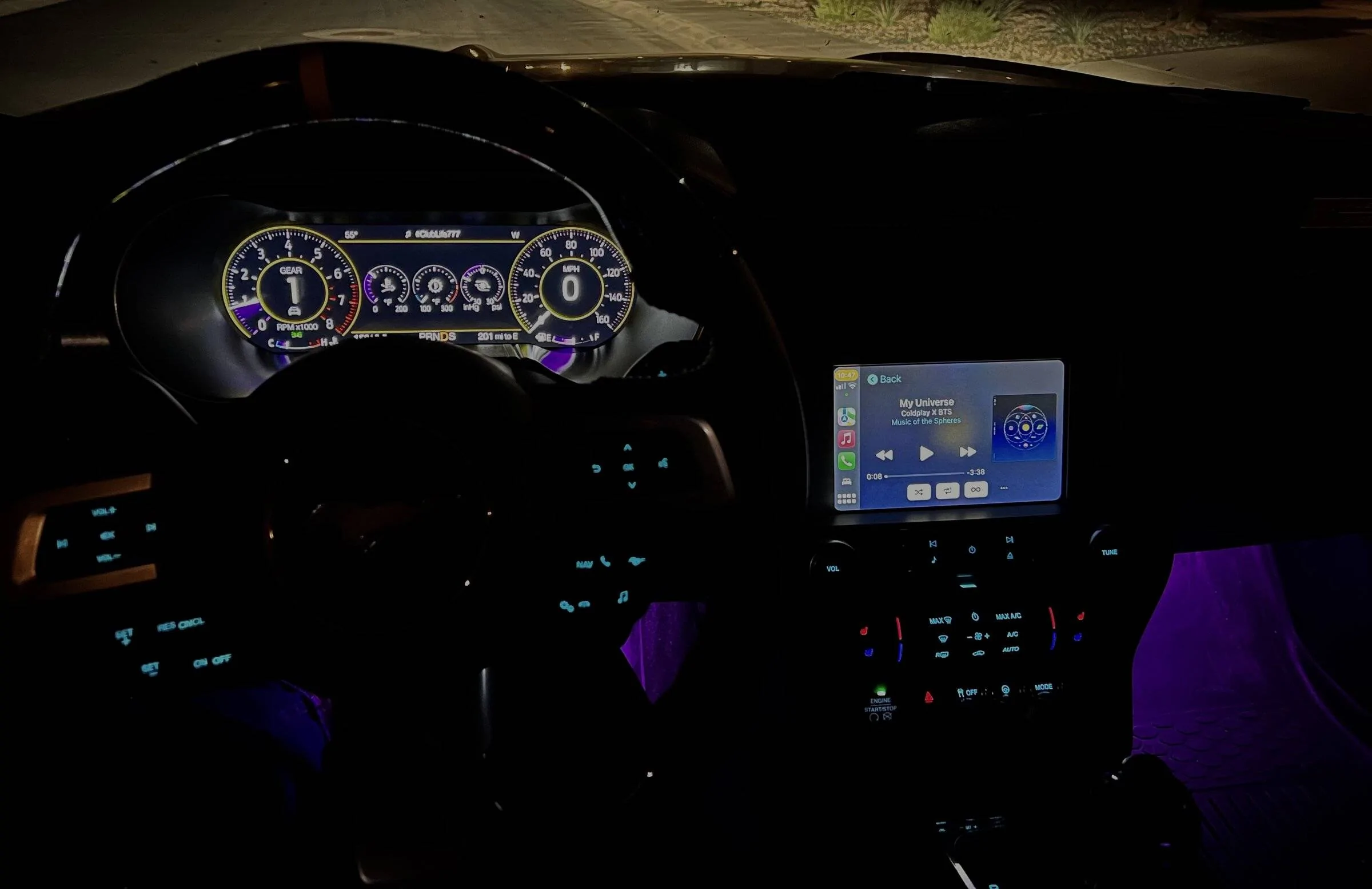

I installed a digital cluster from a 2019 GT Premium in my convertible this weekend, it looks fantastic. Still waiting on shipments from both Tasca Ford and from Hextall containing my SCCM and buttons for the steering wheel and Sync 3 swap kit respectively.

Did a successful install last night. Got a cluster and steering column out of a wrecked 2019 for just $360! Had to order a brand new SCCM as the deployed airbag melted the connectors on the clockspring, so I had to get a new one. Also had to ship the cluster to odo-pro.com to have the mileage lowered. All in total did the project for just $703.
Also installed a Sync 3 conversion from Hextall at the same time.
The only issue I am having is one DTC in the IPC that will not go away.
U0401:82-0A
Invalid Data Received from ECM/PCM A
Alive / Sequence Counter Incorrect / Not Updated
Does anyone know what to do to make this go away? I can't even figure out what the issue is. I found a website that references the code for an Explorer that it's looking for something relating to adaptive cruise, but my car and the donor car neither have it, and I don't see anything enabled for adaptive cruise in any of the modules as-built data.
EDIT: After messing with it all day, I finally cleared it. It was one (or both) of two things:
First, I already had axle oil temperature display disabled, but I saw rear differential temperature display was enabled (but did not even show in the gauge list). Disabled that.
I also saw all lane assist lines were disabled except “lane departure warning” was enabled. I assumed since the master lane assist line was disabled, all the others didn’t matter. Disabled that as well.
Well, it’s cleared for good now.
