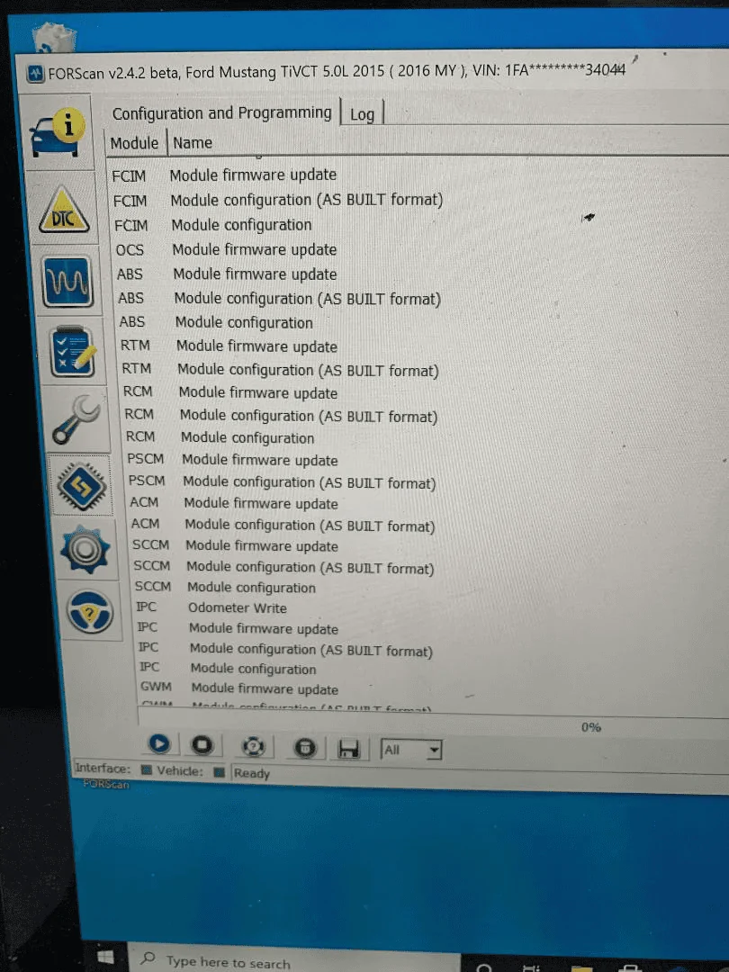

The dash that I got is a 2019 and has lower miles than my car I can change the miles with forscan correct
Yes, you can always go up in mileage, never down with Forscan.

also what cable did you order
These things are really hit and miss (or at least for the sub $50 ones) and I don't think it is just myself has had issues. All I can say is, if it isn't up and running within a few minutes of installing the drivers and forscan, it is likely defective.
