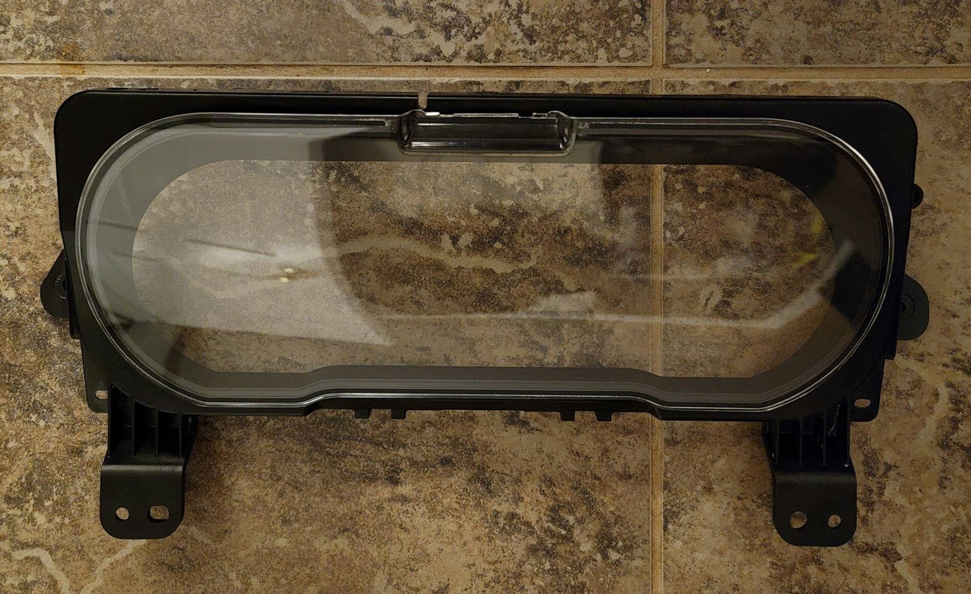

Hi, does anyone know the part number for the lens portion of the digital cluster?
I bought a cluster used and the lens has some marring. I'd like to get a new one since I think the scratches would drive me nuts
Cobra Jet
Feb 12, 2015
771
17,595
20,037
Here, before spending $$$ on a new lens, try this product:
https://www.meguiars.com/automotive...ar-plastic-cleaner-polish-g12310-10-oz-liquid
It can be bought at many retail outlets. Get a microfiber to apply and one to remove. Buff in a circular motion when applying. Remove the product going L to R.
Depending on the severity of the scratch, you may need to go over it a few times. If the scratch is really deep, the product will not fix those types of scratches.
I have used that product on many clear plastics, including dash clusters, headlights, tails and the S550 black ABS trunk decklid section.
