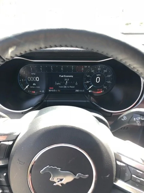

Anyone else? I don’t notice it much in normal mode but in sport it’s very noticeable because of the line running across the top. I’ll try to get a picture next time I’m in the car.

Here’s the view from my driving position

Check out the thread on here showing how to install the digital cluster, it’s very detailed with pics, you probably just have to loosen screws and readjust it to the dash.

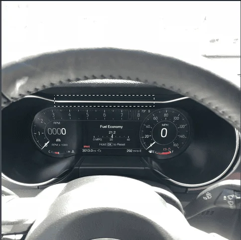

Here you go OP.
Used an editor to draw a straight line on the seam of the dash cover and the gauge top. It's a little tilted to the right.

What was happening was after you cut out the piece, the right piece that you screw into hangs down a little bit more because of less support than the left side . it happened with mine and I just put a screw and that top hole that you don't put a screw into and just pushed up with a little bit of forced to make it even before I screwed it .it worked just fine
