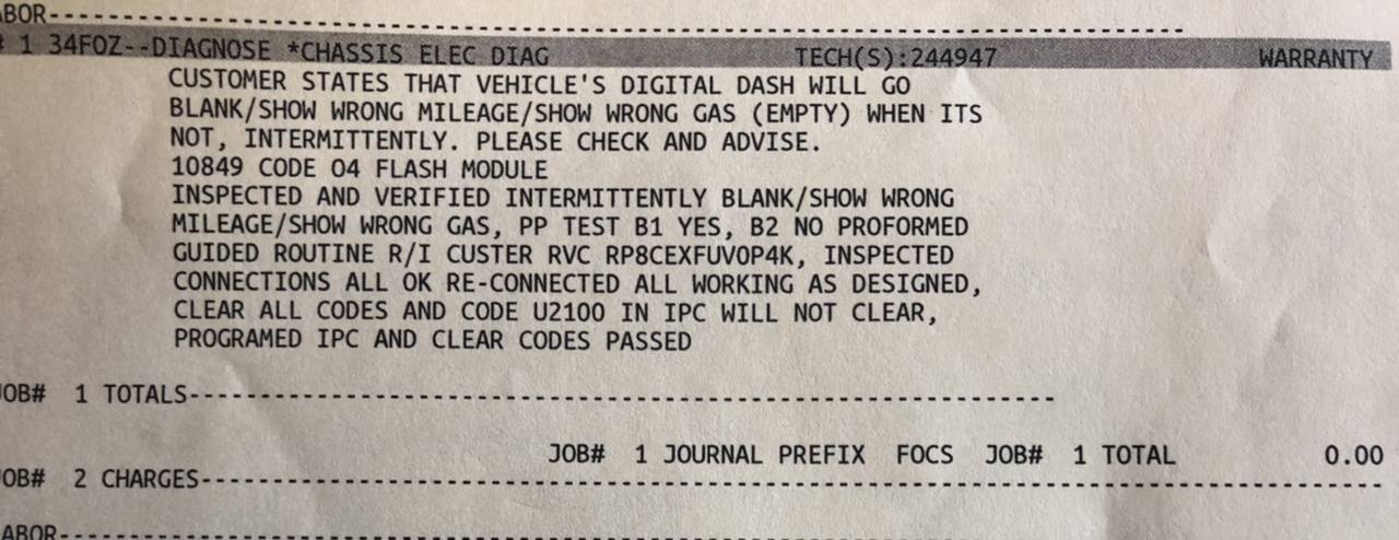

So my dealer ended up reprogramming it for free... here’s what my issue was and what they did to troubleshoot it.

That's basically what they did to mine. Two weeks later it died for good. Hopefully you will avoid that.
