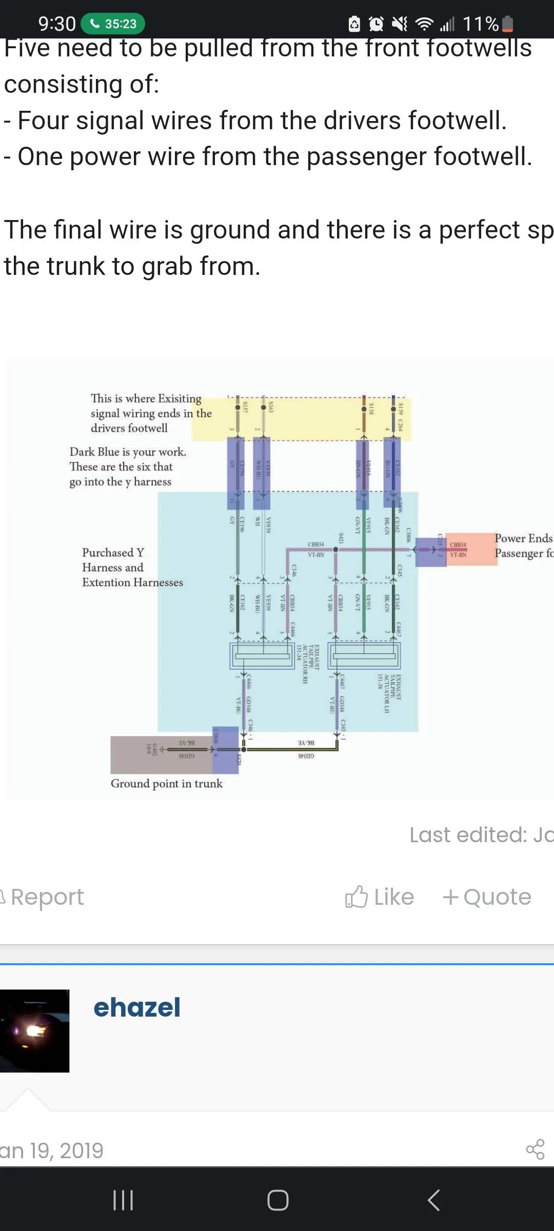

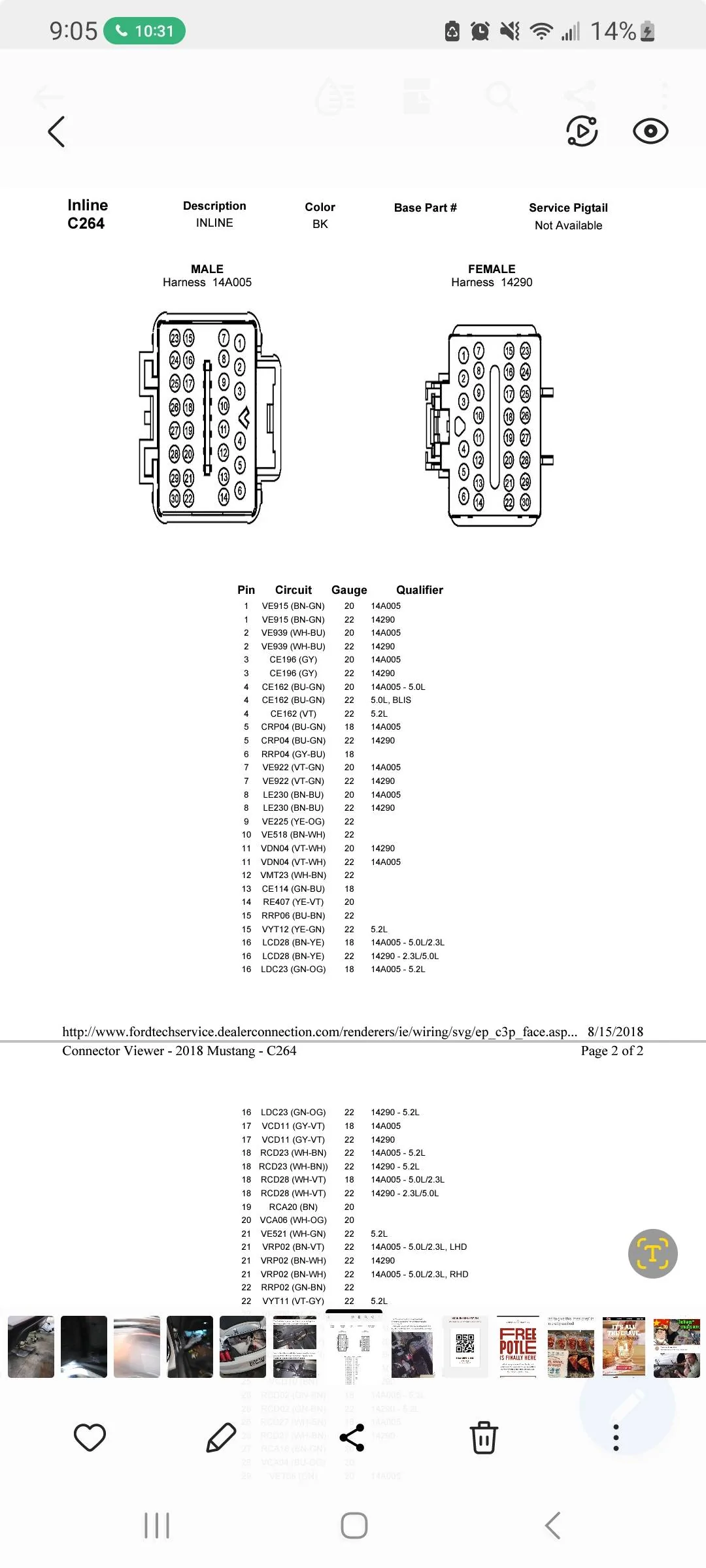

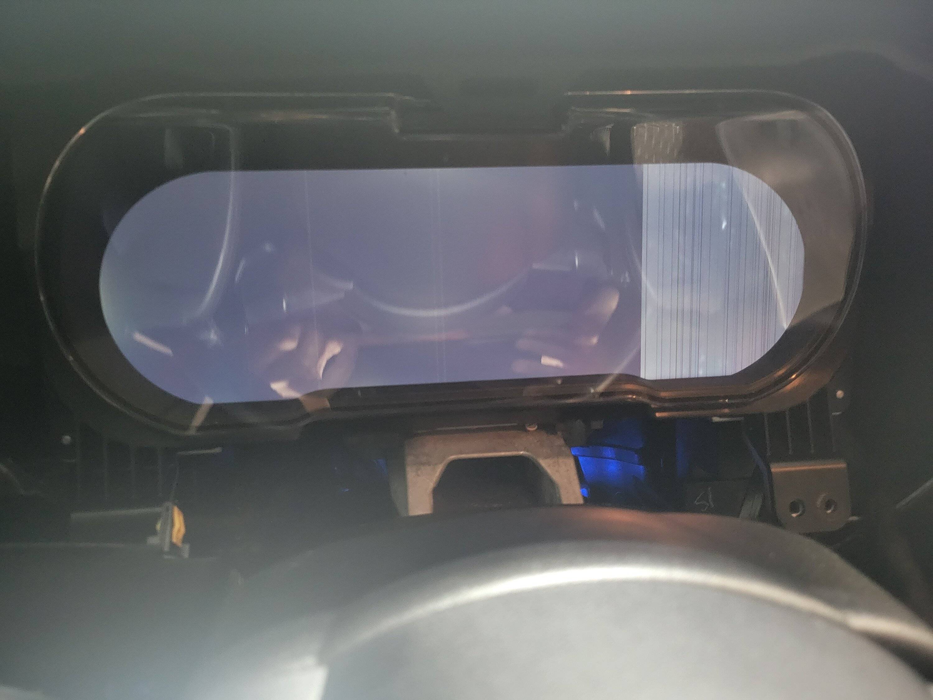

Hey guys, I am having some issues after trying to retro fit an oem active exhaust. Let's go back a bit I have a 2018 mustang gt 401 with oem digital dash.I bought a oem active exhaust with the y harness, I ran 4 signal wires (22gauge) from the trunk to the under side of the driver kick panel. tapped in to wire 1,2,3,4 for signal. 1 wire in passenger side for power and 1 wire in the trunk for ground. after plugging everything in I turned the car on and the digital dash is dead,just some white lines. everything else works and the car turns on and still drives with no issues. I tried to unplug all my work, replace the battery, used forscan to read codes and nothing. no codes in any module and I can still communicate with the ipc, bcm, and pcm with no problems. I also checked all fuses related and there are no problems there either. I have decided to pull the dash and send it over to sam Breeves for inspection, but I still have a feeling that the issue is wire related and not in the dash, i had zero problems before I started to mess with it. is there anything I else I should try, any one had a similar issue?

Update! Sam reached out to me and it seems like there is a problem with the dash itself. Maybe nothing I did caused it. So if you have a problem similar to this is your dash.
