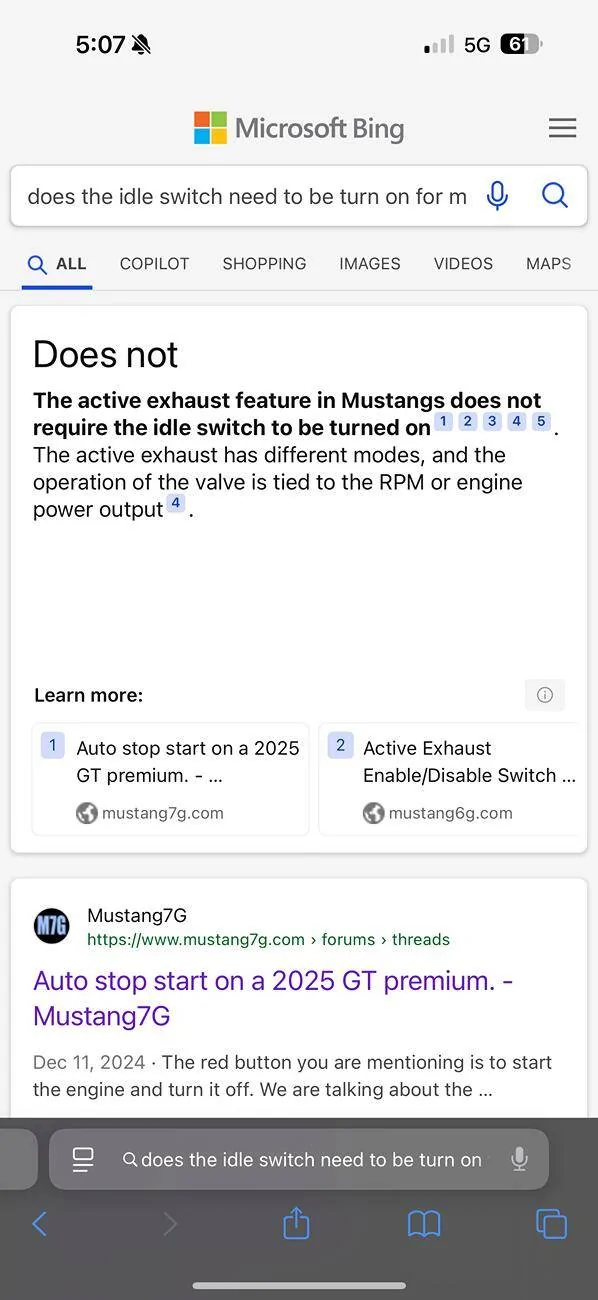

Yeah my question is about the Idle Switch did you enable it ?and what does this do if it was enabled?
Good question, unfortunately I did not turn the idle switch on. Maybe someone knows. I did try to find the importance of turning it on but found nothing. I do plan to turn it on since it seems like it’s on from factory.

Please update if there is any noticeable change once you enable the ideal switch
I ordered everything to install my AE mufflers , actuators and required harnesses and want to make sure I have everything to be done at once šŸ˜…šŸ˜‚
Found this don’t know why I could find an answer before.

it seems that won’t effect the AE functionality by any means
it make sense to me now
