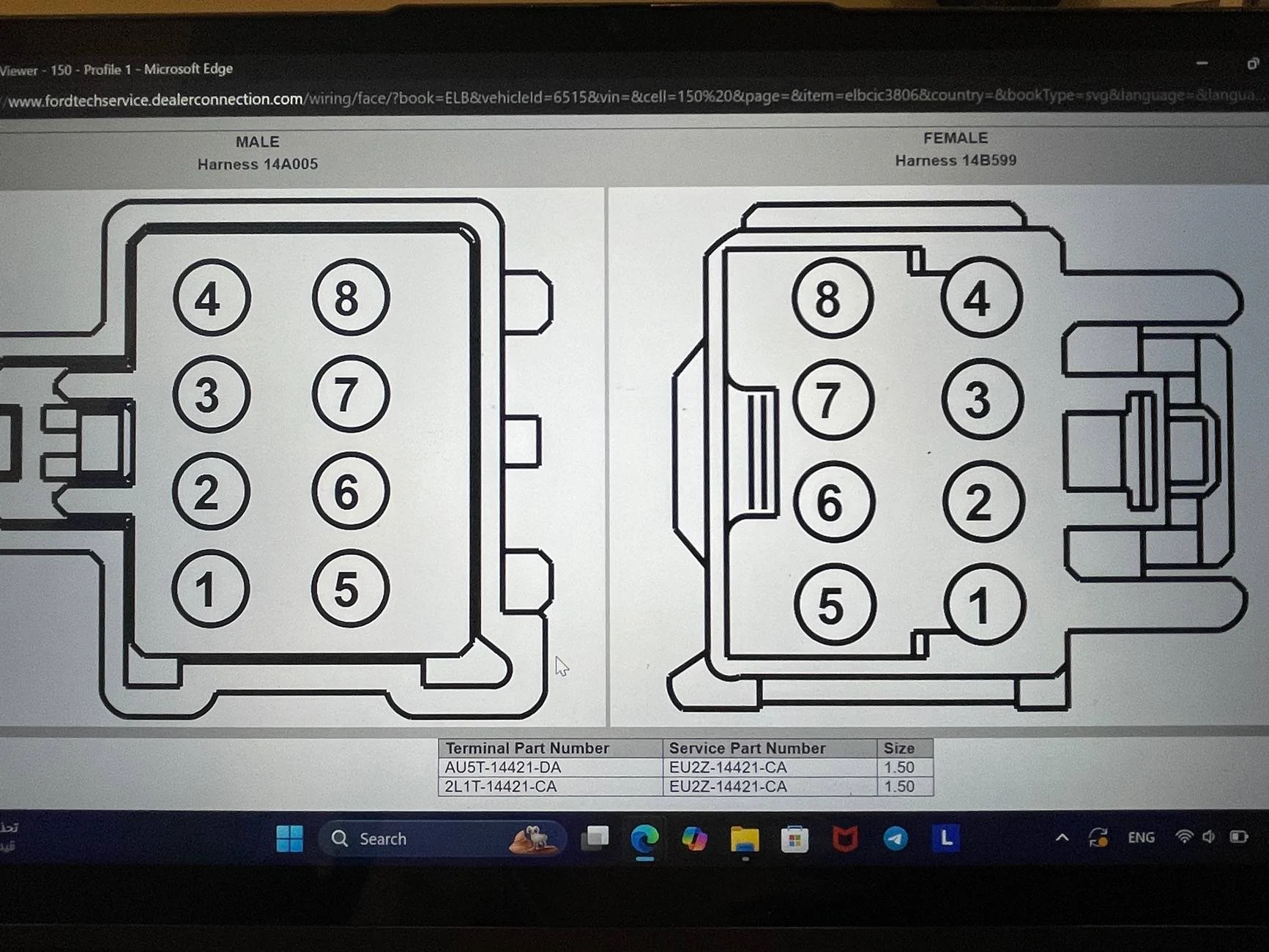

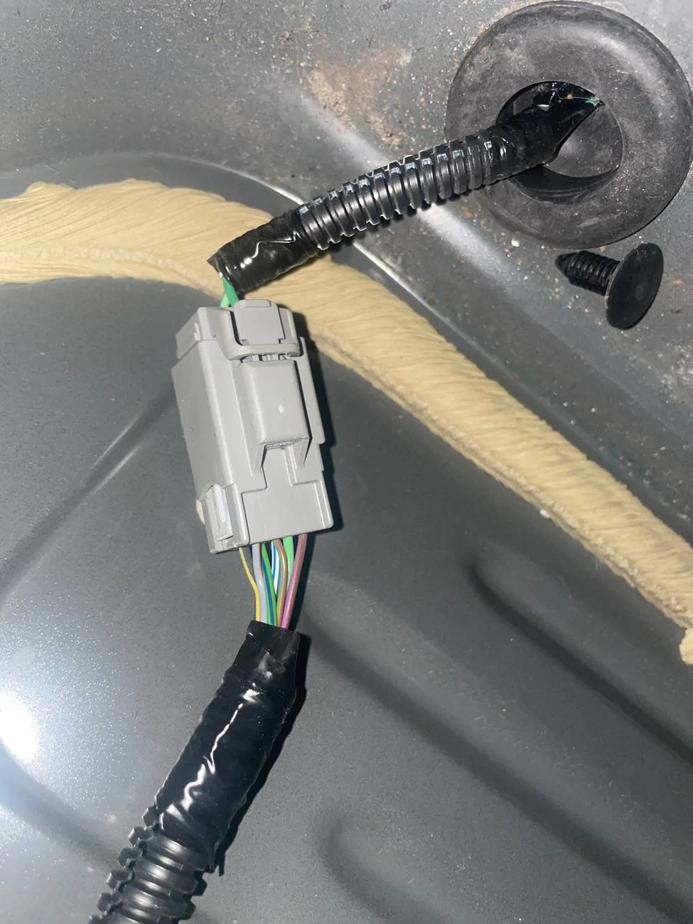

I really appreciate you for the quick reply and I know this been repeated many times but where will be the rear dif cooler as there are only to output wires from the female plug going to EVAP
And If I bought GT500 harness do I need to buy Y one ?
I found the the plug number in the trunk under number C3806

Just saw this on eBay. It’s actually for the GT so that might be a better choice. Come with everything you need. https://www.ebay.com/itm/1566927915...hu7bQupSm-&var=&widget_ver=artemis&media=COPY
derwin252
Jan 2, 2023
51
GA
Erland
2020 Mustang GT Premium PP1
I have this plug in my trunk and I think wouldn’t work as my plug has 8 pins and this one is 12 😅
Look behind the plastic in the trunk I think the plug is behind there. I’m at work so I can’t check my car right now but I will check when I get home.

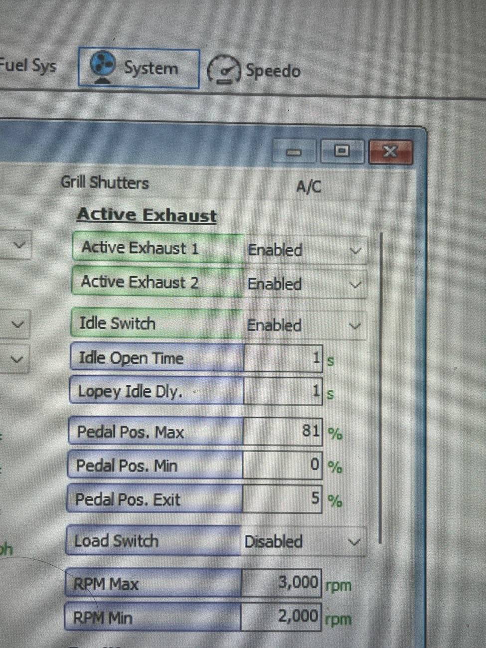

Hi,
from the Hptuners I opened multiple files for car originally comes with AE and found that the AE1,AE2 and Idel switch are Enabled.
In this thread I have seen people have change only AE1 and AE2 and it worked with them
can someone confirm is it necessary to enable Idle Switch and what basically does this do if it was enabled?
derwin252
Jan 2, 2023
51
GA
Erland
Hi,
Both mine were off, I had to turn them both on in my car.
