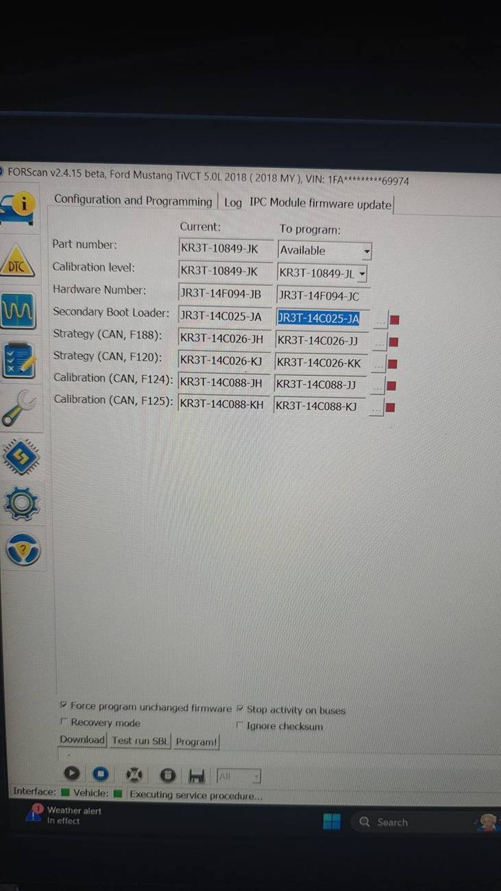

You can flash calibration files with forscan beta, I did a digital cluster firmware (I'm not sure if it's possible for the PCM, that's why I was asking) I'll send you a picture when I have the time

This is what I mean (old picture I took when setting up the cluster)

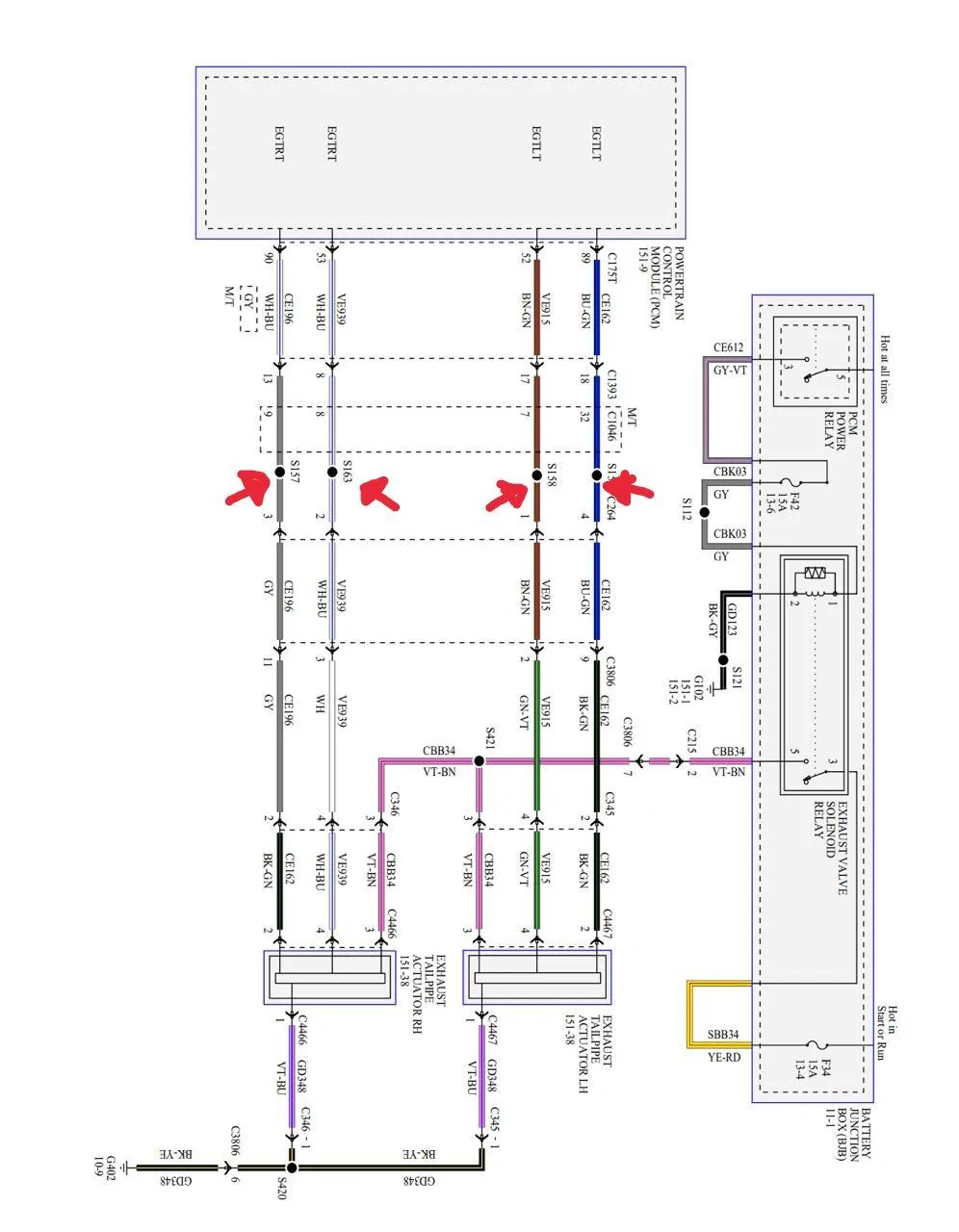

Does anyone know if these dots in the actuator control lines (splices) are connected to any additional wires at those points, or are they just factory splice joints?

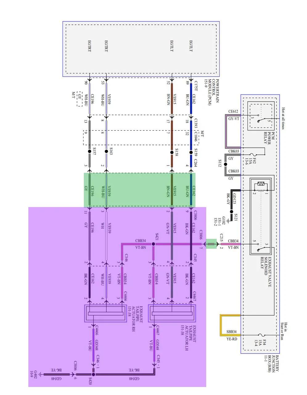

After going through the entire thread, I couldn’t find a single post where someone managed to get the active exhaust working through the dashboard without initially having the fuse and relay in the fuse box.
Has anyone actually been able to do this?
I happen to be one of the “lucky ones” - my 2018 Ecoboost Mustang Premium with Digital Dash has neither the relay nor the fuse. On top of that, most of the wiring required for the system to function is missing from the car.
However, for some reason, there is a section of wiring running from under the spare tire area (C3806) to both the driver’s (C264) and passenger’s (C215) footwell.
I’ve marked in green the part of the wiring that came from the factory and purple what I managed to add (Y-harness and 2 actuator jump-wires).
My plan is to add the missing wires and pins so everything looks and works as close to factory-standard as possible.
So far I ordered proper Fuse Junction Box and going to source components from it.
If anyone has advice, tips, or experience with this, I’d really appreciate it!

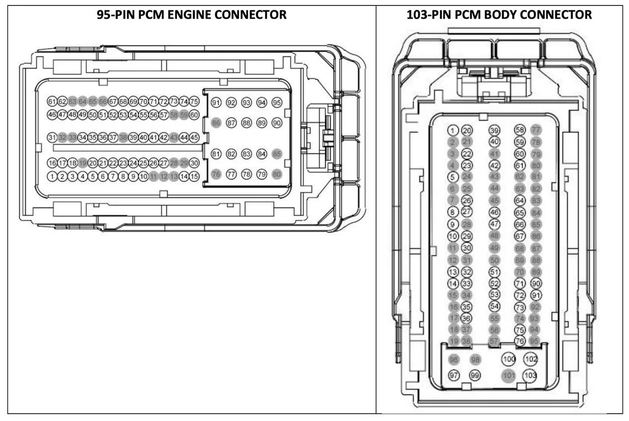

I bought a fuse box with the required fuse, relay, and wiring — no problem adding that to my car.
But… I discovered that my 2018 EcoBoost has different ECU connectors compared to what was shared in this thread (90 pins). Mine body-to-ecu connector - C175B that has more pins (103).
At the moment, I’m trying to figure out the pinout, but I have a feeling this model of ECU might not have exhaust control pins at all.
I’ll attach a picture of my connectors. Perhaps someone has the pinout and could share it?

Active exhaust wasn't available for Ecoboost until MY 2019 unlike GT I'm afraid... this might explain why.
