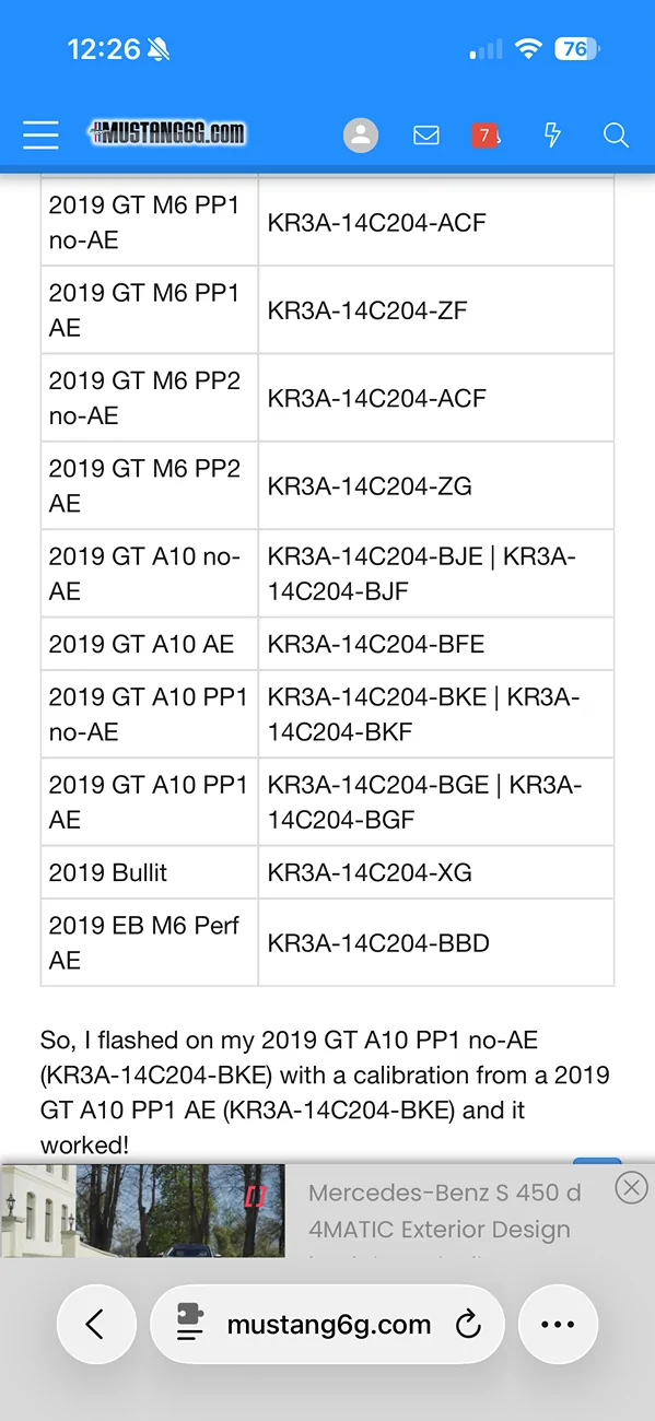

Thank you for the reply. I am trying to mimic what was done on page 46 post #687 where they just flashed the PCM with a calibration from a car with active exhaust. I have a PP2 so not many options besides AE and no AE. I’m not really interested in tuning if I don’t have to but I have already accumulated all components so that may be my only option as I really don’t want to wing it and brick this PCM.

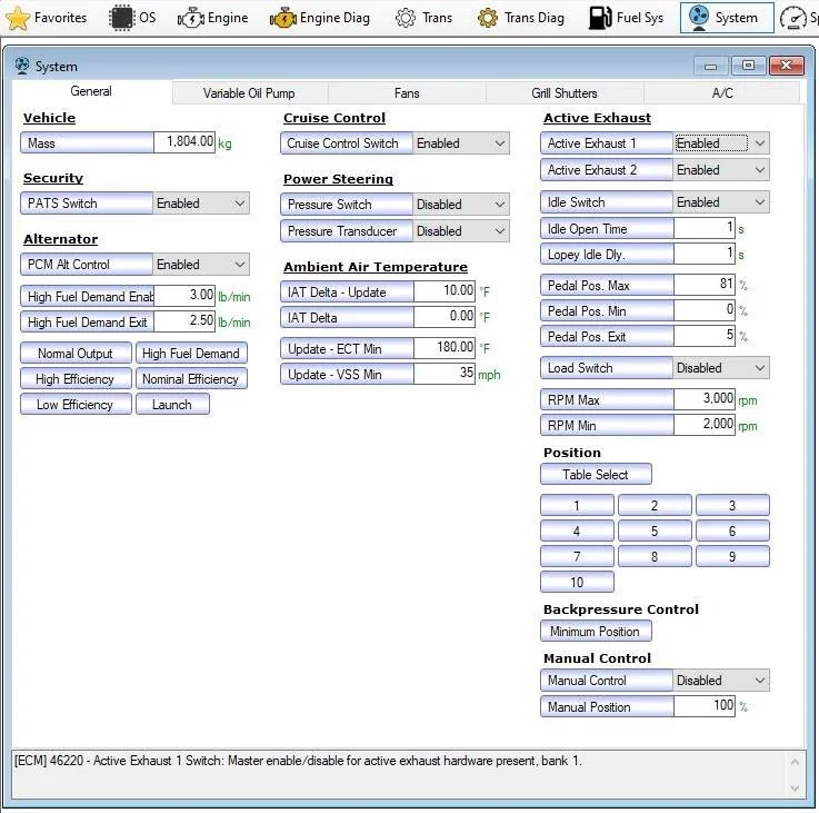

You don’t have to flash a tune. I used my hptuner to access the PCM and turn on the feature. Active 1 & 2. (Top right)
I don’t currently have a tuner. I assume I would have the go the same route as if I was going to tune as in needing to buy the credits? Or because you don’t flash it doesn’t need credits.

From these older post 2 people claimed to do it. You do need Forscan beta to flash. The PP2s aren’t common so I am having trouble getting people to send me the as built data to copy. I do appreciate the help man, I am going to just end up paying for credits vs paying for a bricked PCM replacement.
