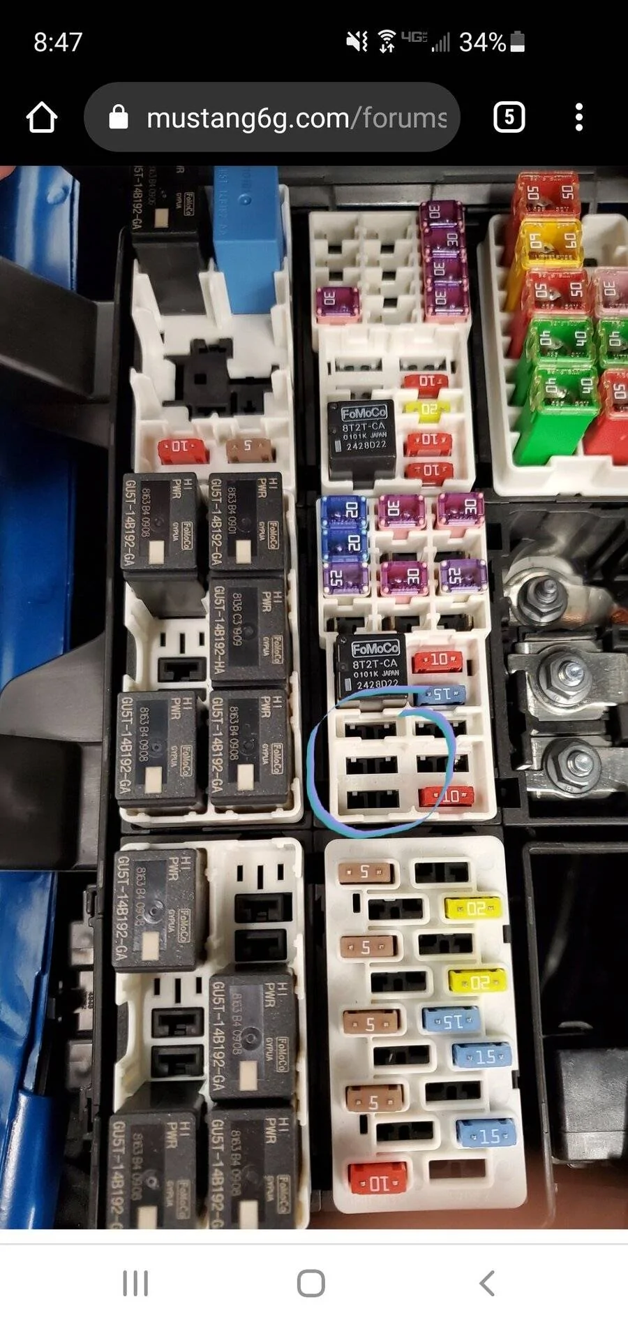

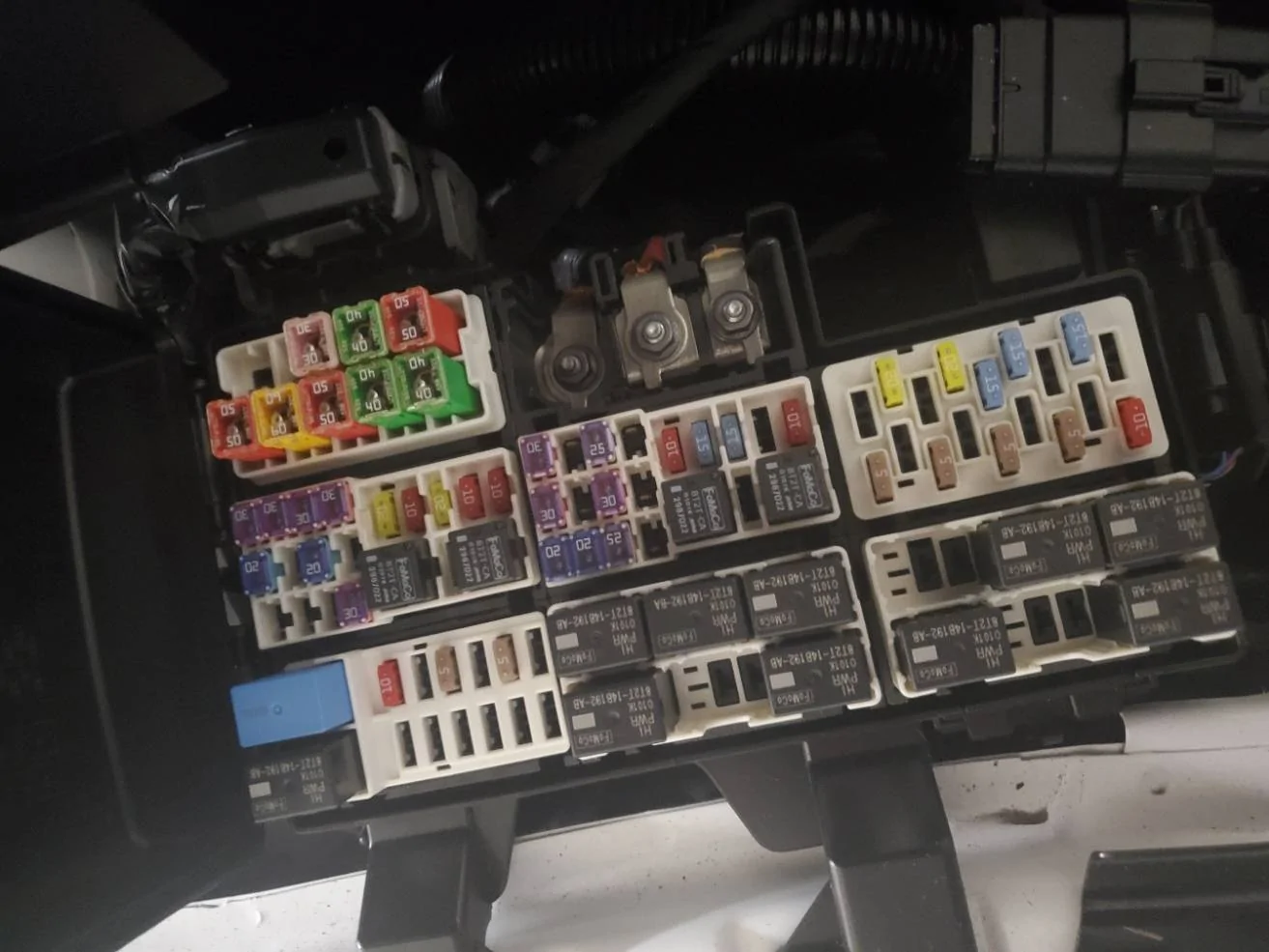

Have you confirmed that you have the underhood fuse setup for the AE? Just thinking this could potentially be another issue outside of forscan...

I still have to check for the fuse in my fuse box but hopefully it will all work. I originally ordered a car with factory active exhaust and ford says it was lost in-transit so They offered me the same car with the active exhaust and said it would cost over $6k to add it because of all the work needed.
I will be checking tomorrow, fuse slot #34 15AMP and Relay #59 right?

Some of us have the rear harness but no fuse connections under the hood. I don't think anyone has found a way around this to make it work like the factory setup. Maybe I'm wrong though. Just make sure you verify you have this fuse under the hood. I don't remember what number it is but I know I did not have it. On some cars there are no connections to add a fuse for the power. I was ready to order everything until another member suggested that I check this out (I don't have the fuse) . You really should read the entire thread before starting to buy anything (maybe you have read it). I'm attaching a picture of my fuse block under the hood. My car is a 2019 so your setup might be different. I circled the space that should have the fuse...
