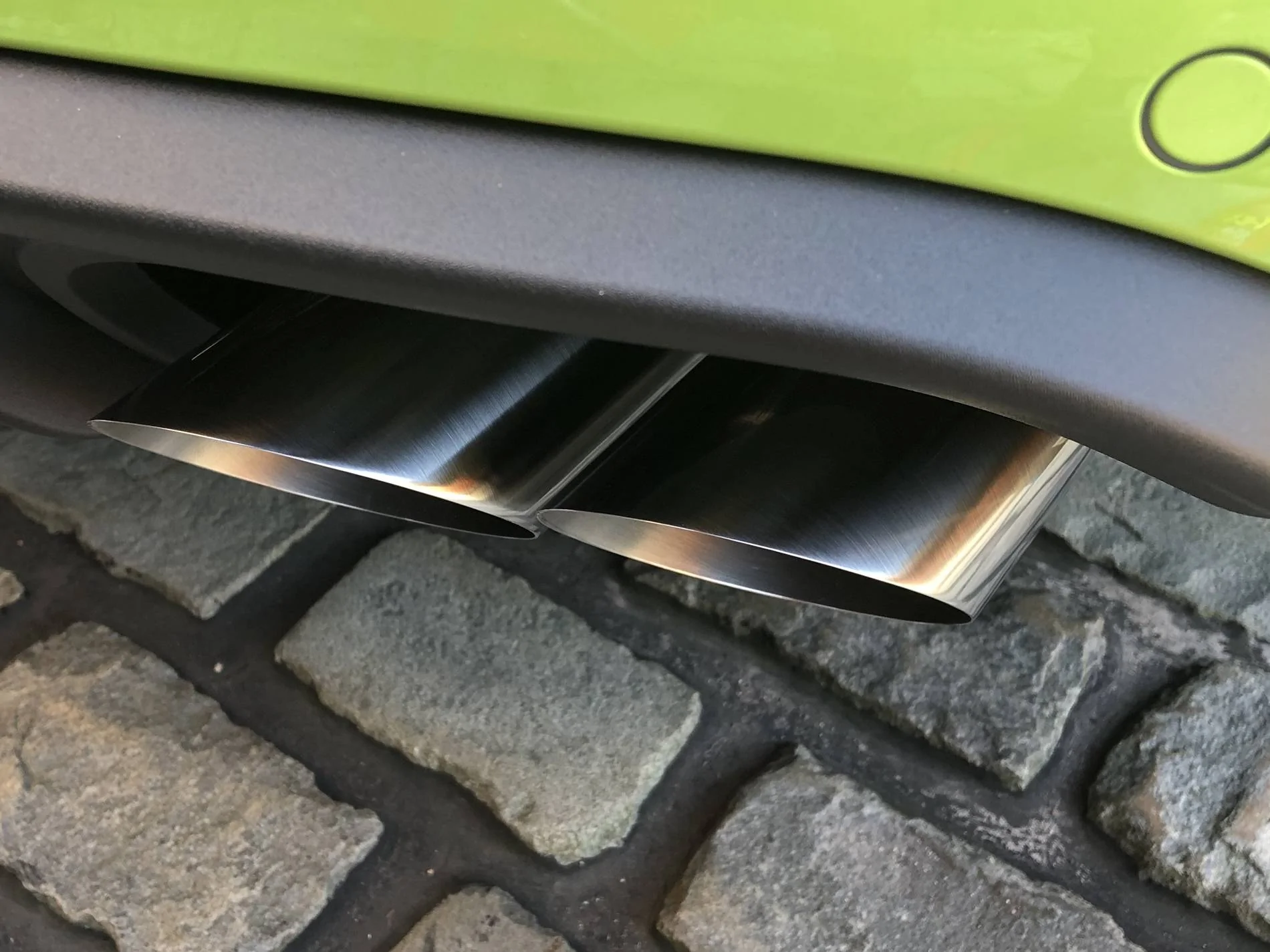

Yes, I plan on doing - but I’m only one week into ownership so I’ve got lots of other things on my plate first ... lol

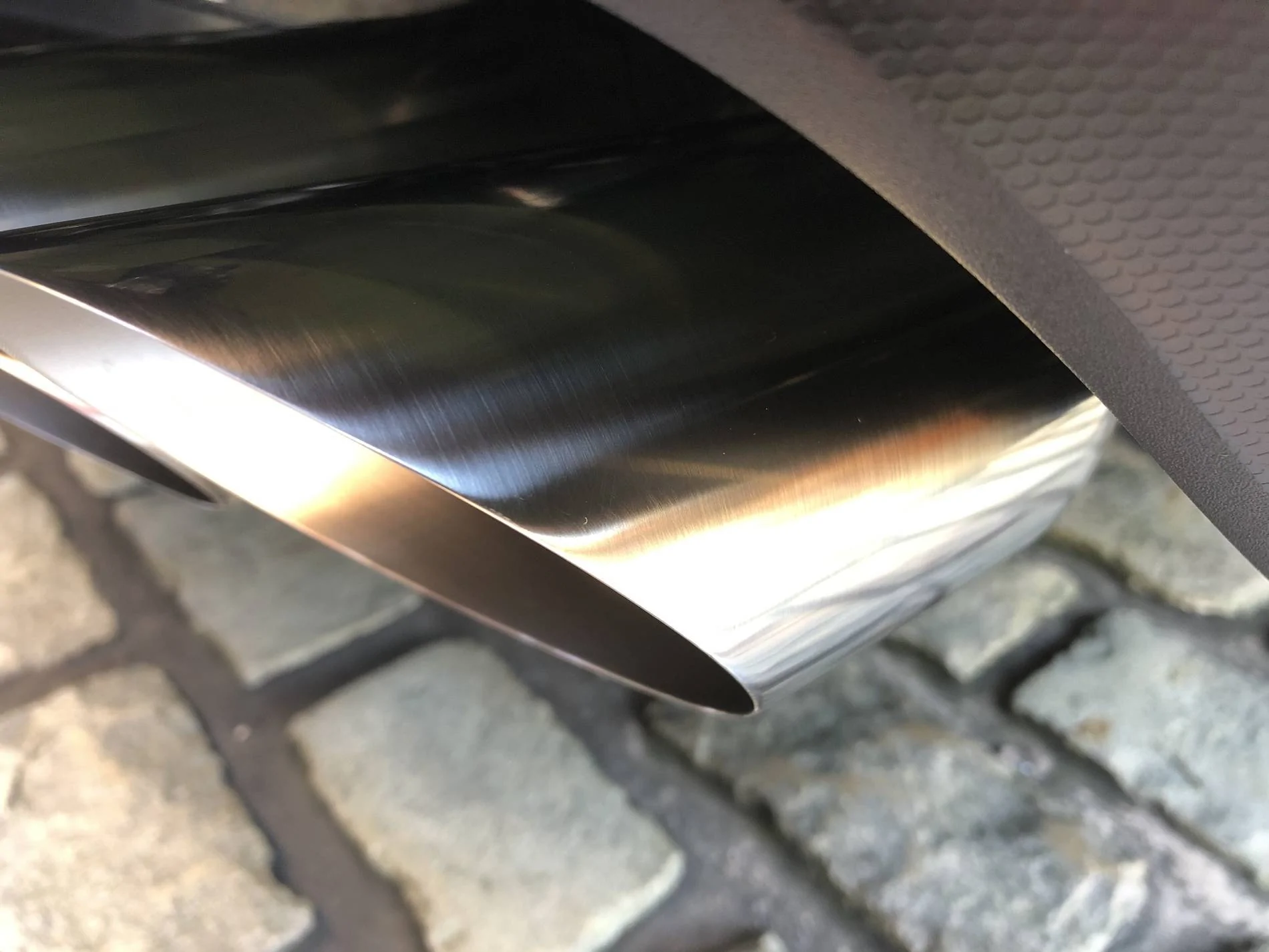

Out of interest, my stock tips were poorly finished - burrs on the ends, sharp ends, uneven finish and then as it’s a U.K. car, they were even kind enough to cover them in black underseal overspray ...
A bit of work with the dremal and then application of a more even brushed finish had them Looking a lot more presentable :
WD :like:

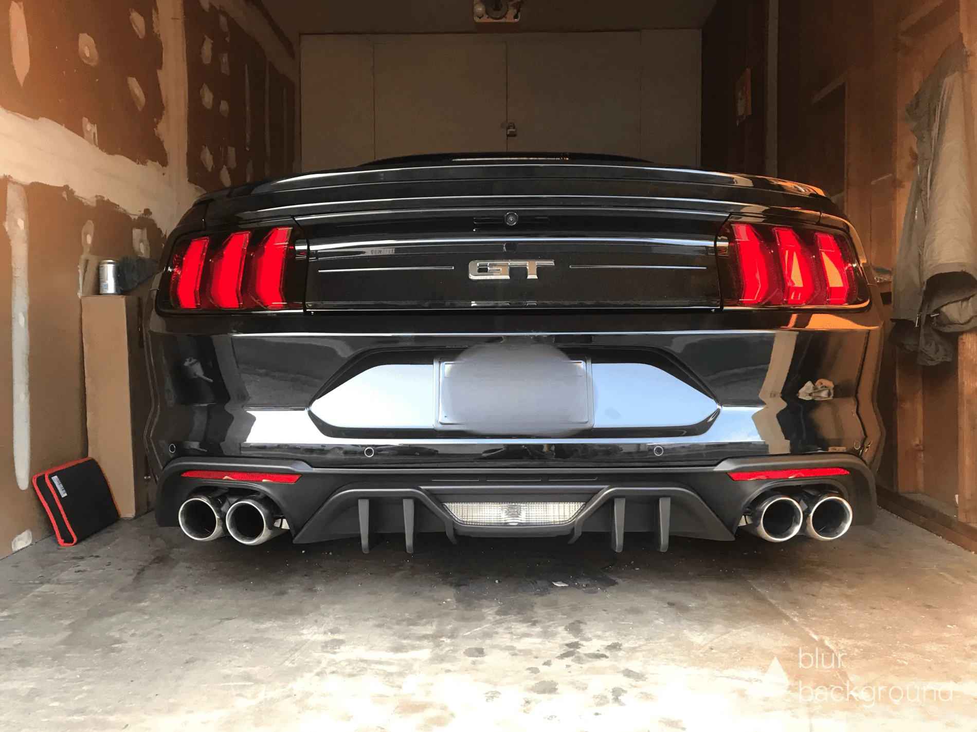

Have the MP Concepts w/ the slide on tips installed. Was a huge pain to get everything aligned and in but eventually was able to get it done. Love how it looks now in the rear as opposed to the factory tips.
