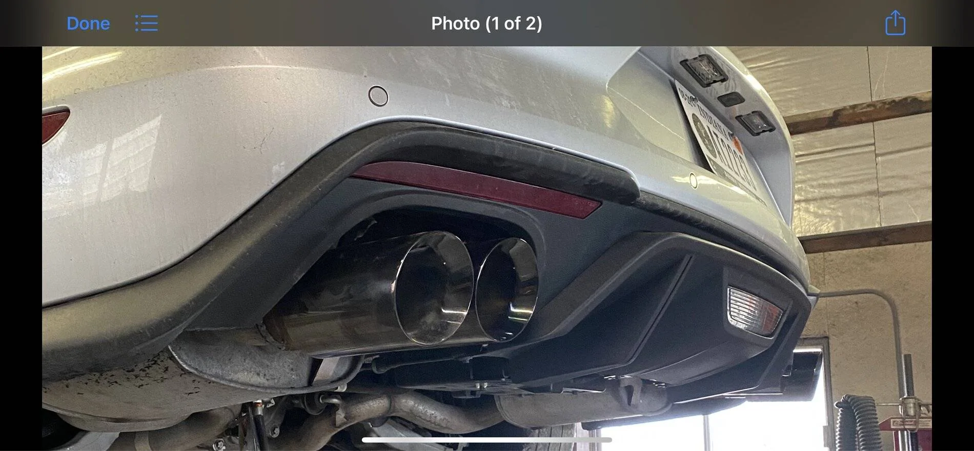

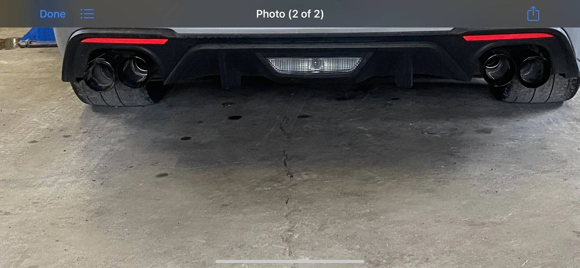

Ya 100% better than stock for sure. I think just recess the outside tip a bit and put a jack under the mufflers when you tighten the clamps. It looks a bit like the outside tip is drooping

Yeah , I see what you mean .
I was just thrilled he could do it after the first guy refused .
He is quite OCD himself (I am the opposite ) so I am sure once I point it out he will fix it .

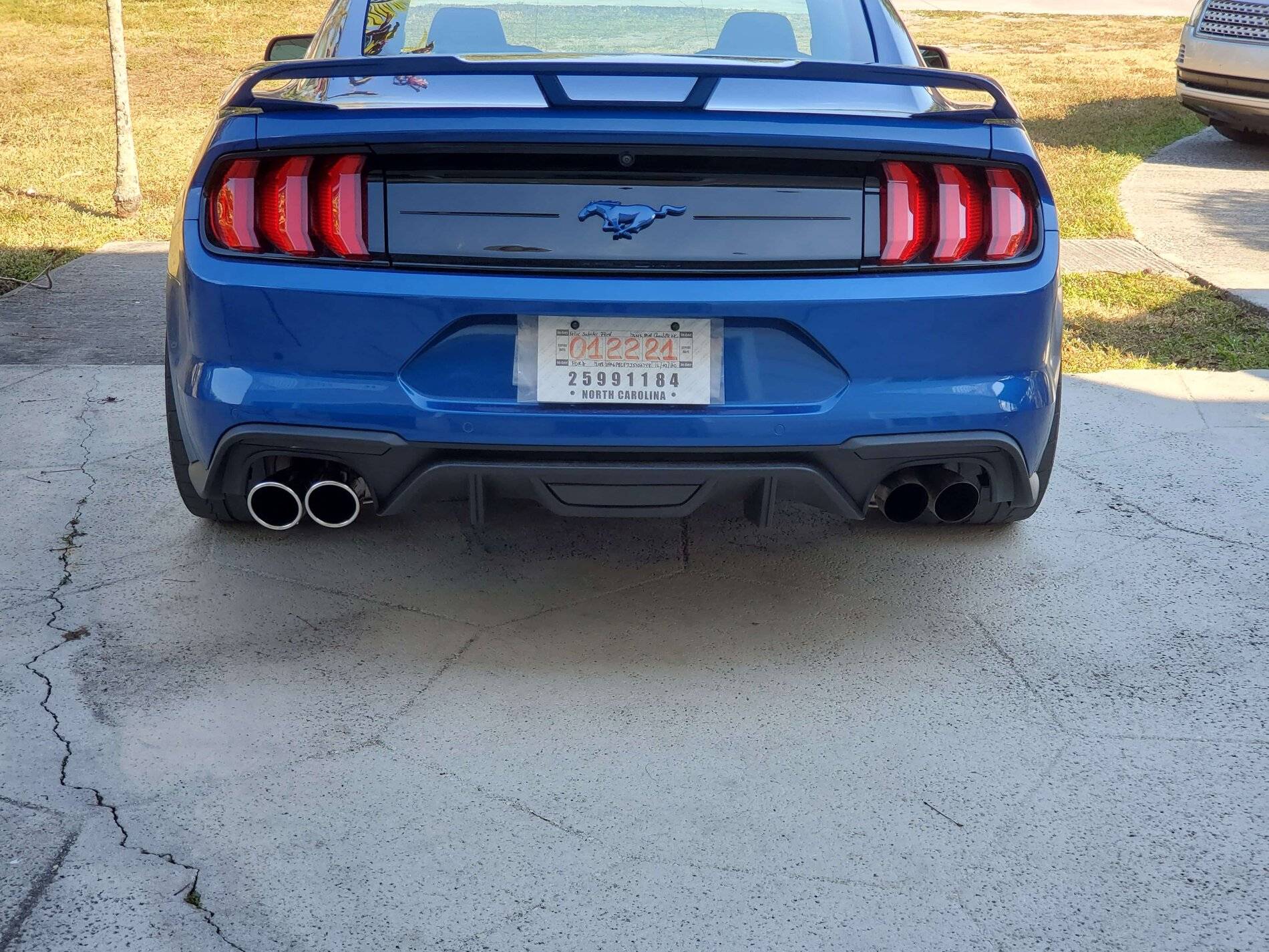

Can someone post a link to slip on ones that have worked?

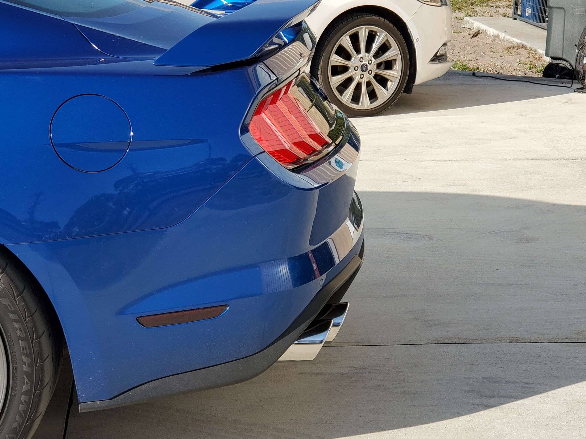

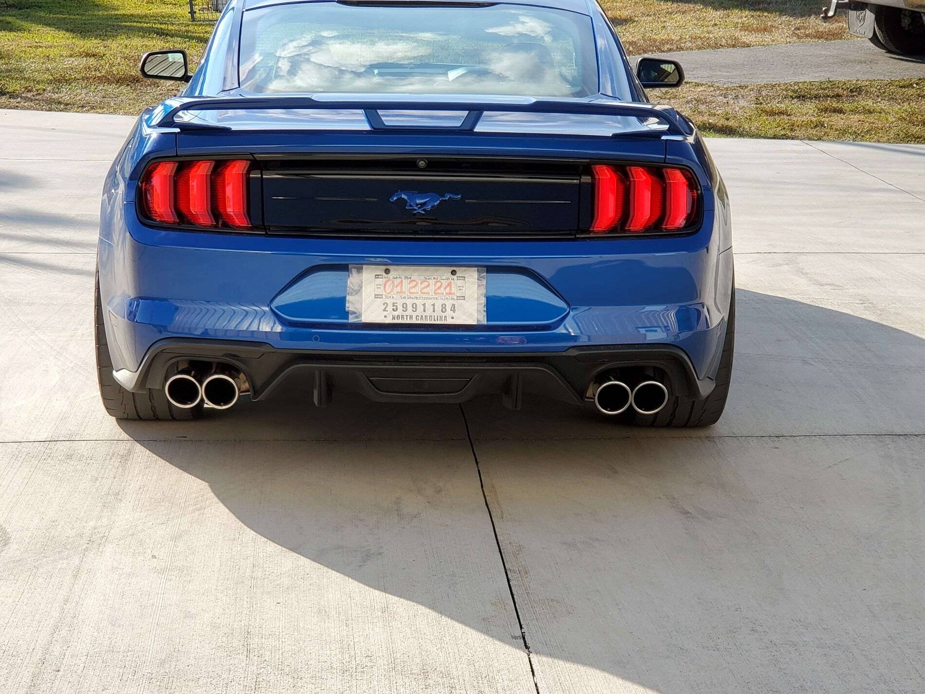

Did you weld them on after cutting?
Yes, they were cut to 5.5 and 5 inches, with the shorter one going on the outside. Slipped on and welded at the back. Since they slipped on the stock, they are super straight, perfect depth, and never moving
