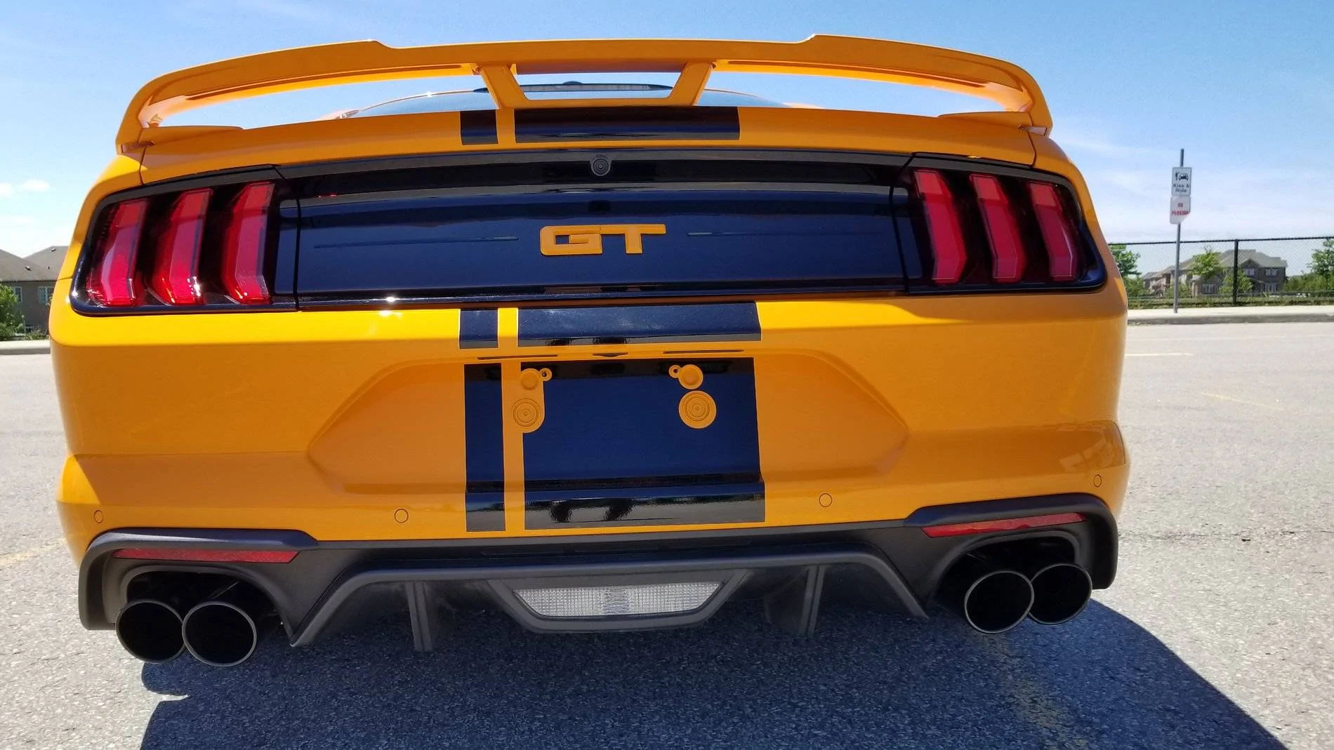

I just replied in another thread but a few of us bought 4 inch tips from eBay and cut then to 5 inches and slid them over the stock tips and welded the back. Looks very good in my opinion and keeps the stock active exhaust
