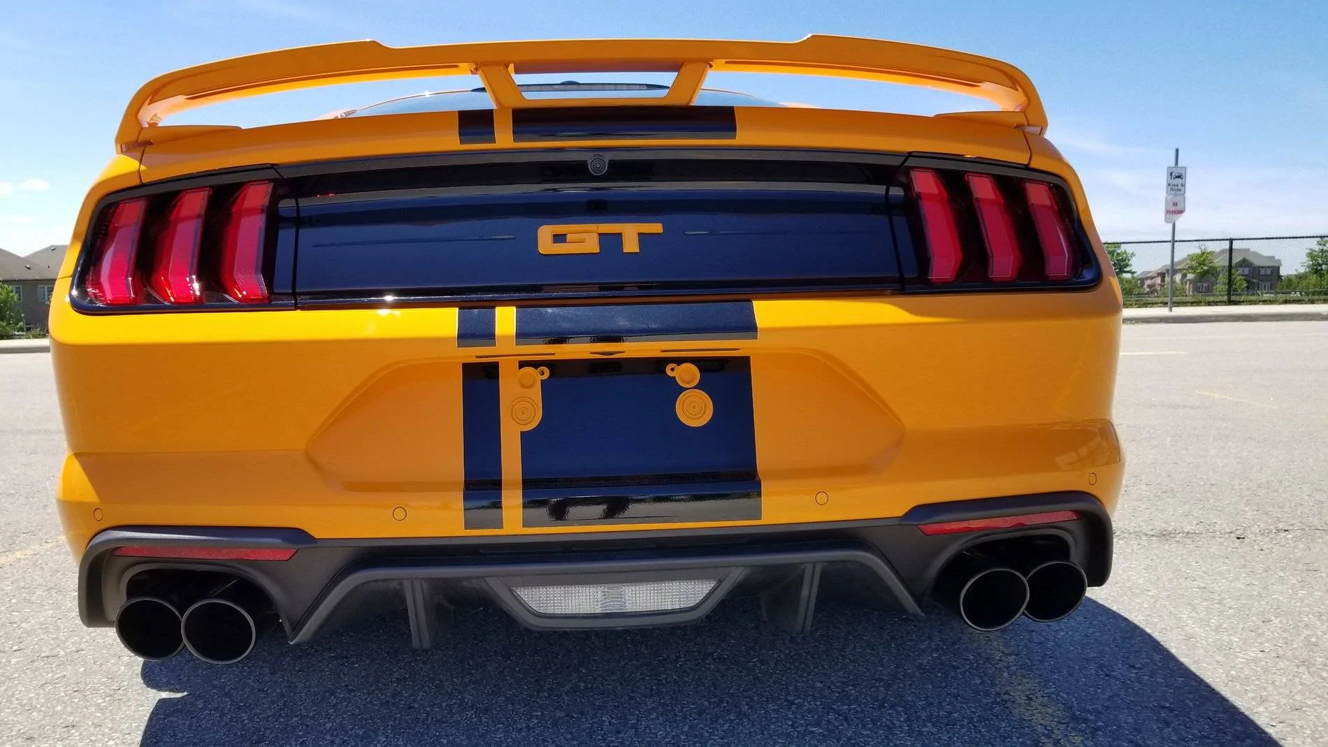

If you go the original thread, you will see what I did. It was not that big work. I bought 4 tips from eBay, and went to an exhaust shop where they cut the tip to length, slid them on and tack welded the back. Really very easy.

So those have just been slid over the factory tips? If so they did a good job hiding the factory tips with those. Most I have seen look like slip ons and you can still see the factory tips which I do not like. Makes it look like a car that is trying to look like a sport package with fake tips.

I understand. But after driving a bit you cant even tell. I wanted to keep my factory active mufflers. Hated the tips and I am sure my 768whp makes up for it. LOL But I get it, I am picky too and decided I would rather have the tips this way over the factory way. Un-circumcised mufflers if you will. LMAO:crackup:

We are all picky about our cars but you cannot tell even if you tried that there are other tips inside

Beg to differ on that, go back to the old thread and look at some of the pics posted. I can see the factory tips on most of them. Now yours I can't, that is why I was wondering if they were slipped on. Maybe that rolled tip on your does a better job of covering the edge of the factory tips. Ebay ya say....what length did you order?
