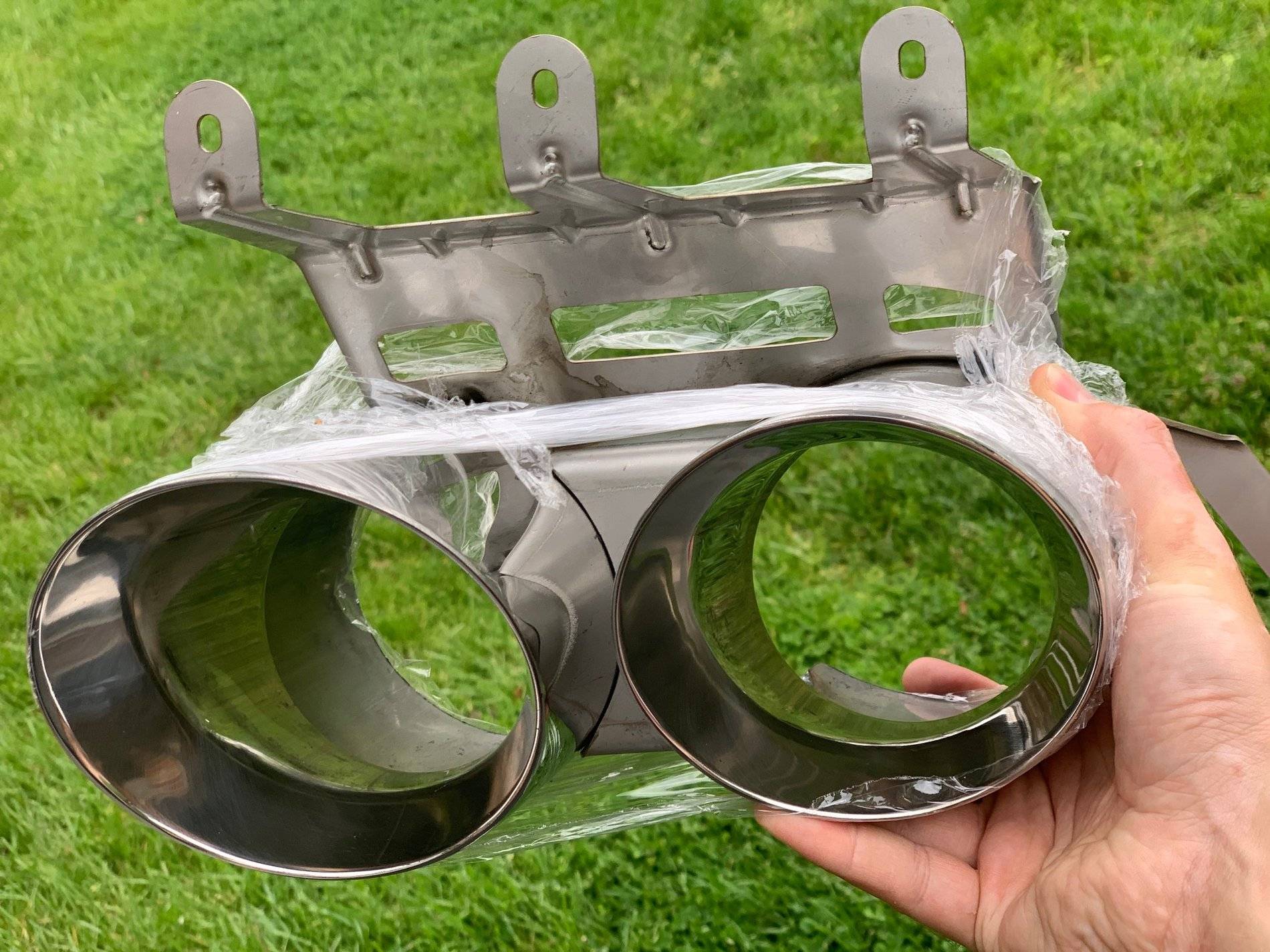

Looks like this..... this is what I used

How about the welding - what is needed for that? Is it difficult?
sabtaj1
Sep 11, 2019
31
1,157
1,340
Bettendorf, IA
Jason
2019 PP1 Mustang GT, 1965 Fairlane 500 wagon
It’s quite simple. However it’s stainless so you should tig weld it to be properly done. Really takes no time to do that aspect. But easiest done off the car. I took mine to a buddies shop n used his tig welder.

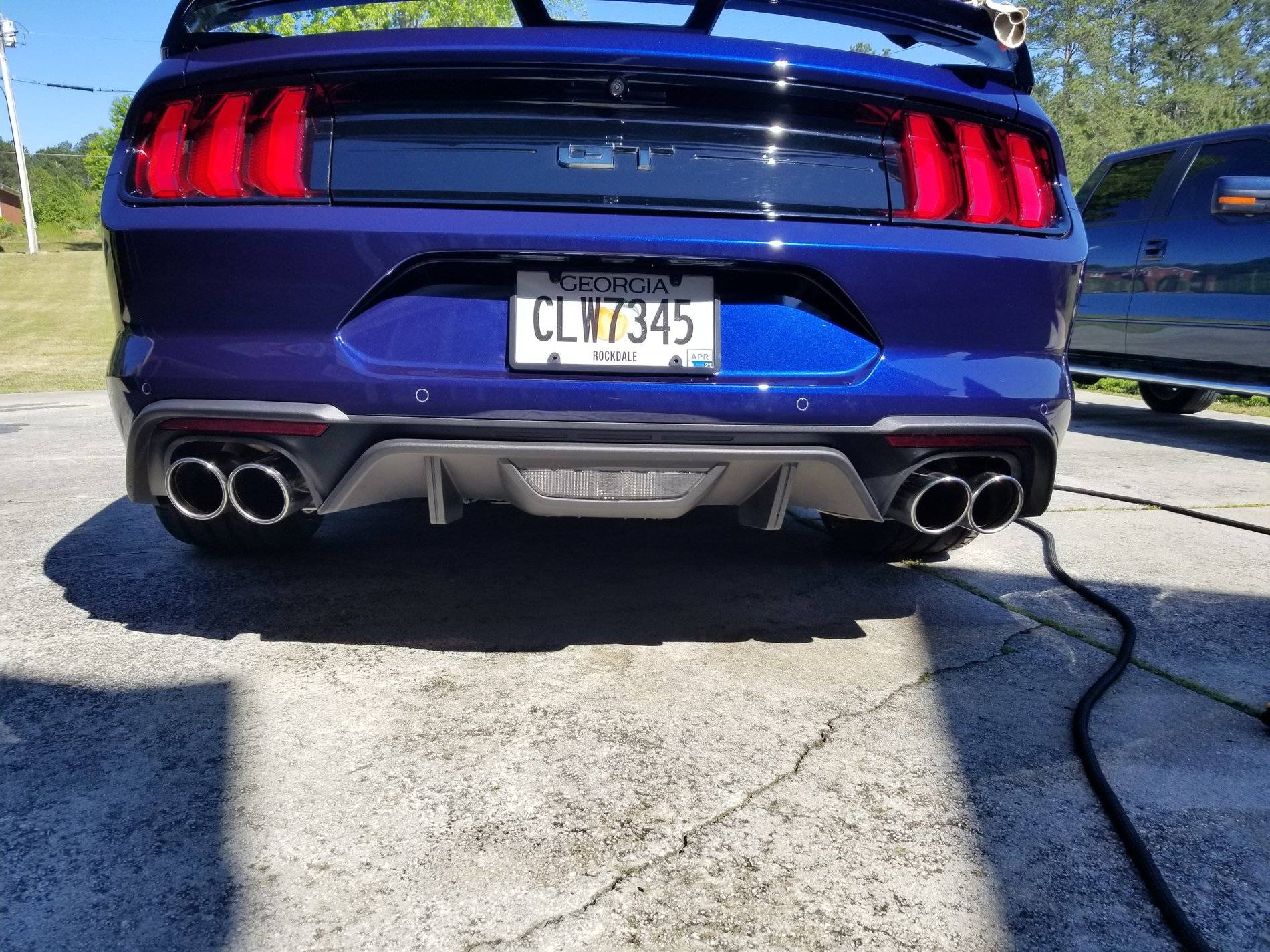

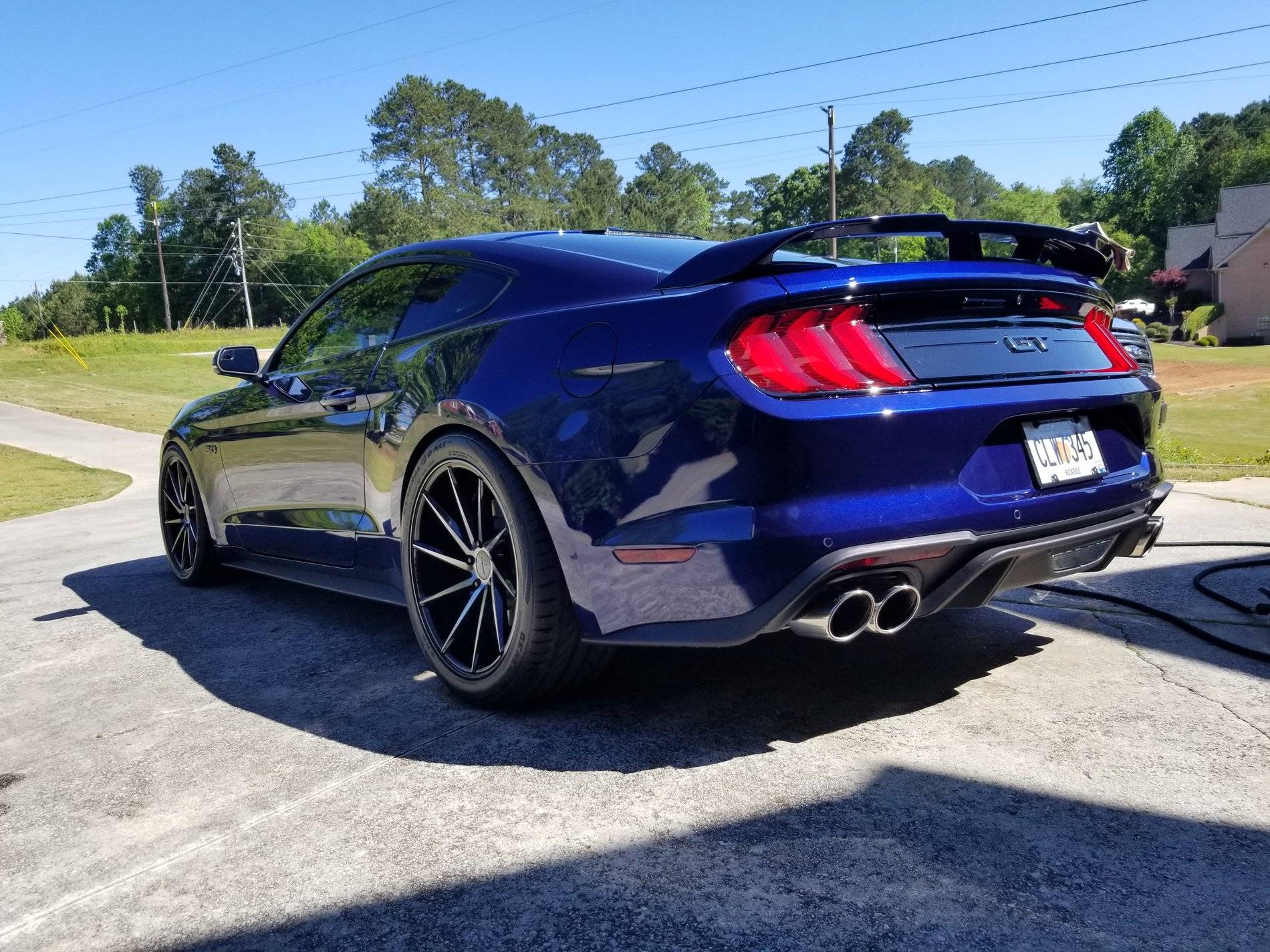

Looks really nice Frank. Can let us know if you did the exact same cuts? Like but a 12 inch tip and cut to 6 and 6.5 inches? Tig welded?
Frank
Oct 7, 2019
82
66
Ga
Franklin
2019 GT PP1 Kona Blue A10
Thanks and yes I did everything like he said but I mig welded mine. I got 4 tips off ebay for $88.00 or something close shipped,they were 12 in truck tips.I do think tig is the way to go but I did it Sunday and I only have a mig welder.

Awesome - thanks. I'm getting ready to cut my tips and put these on. I'm afraid whether the smaller pipe will show through this tip and make it look weird?
