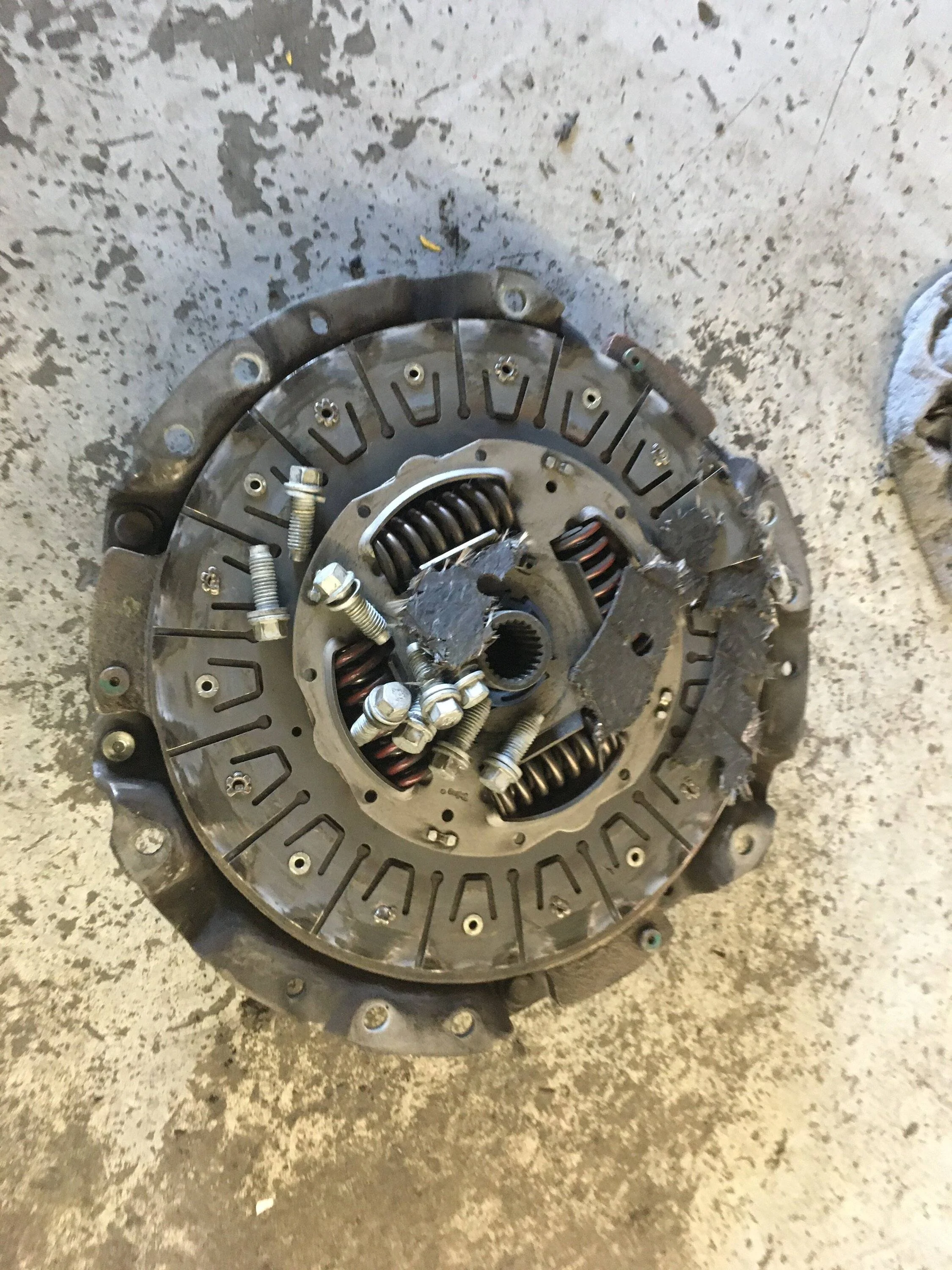

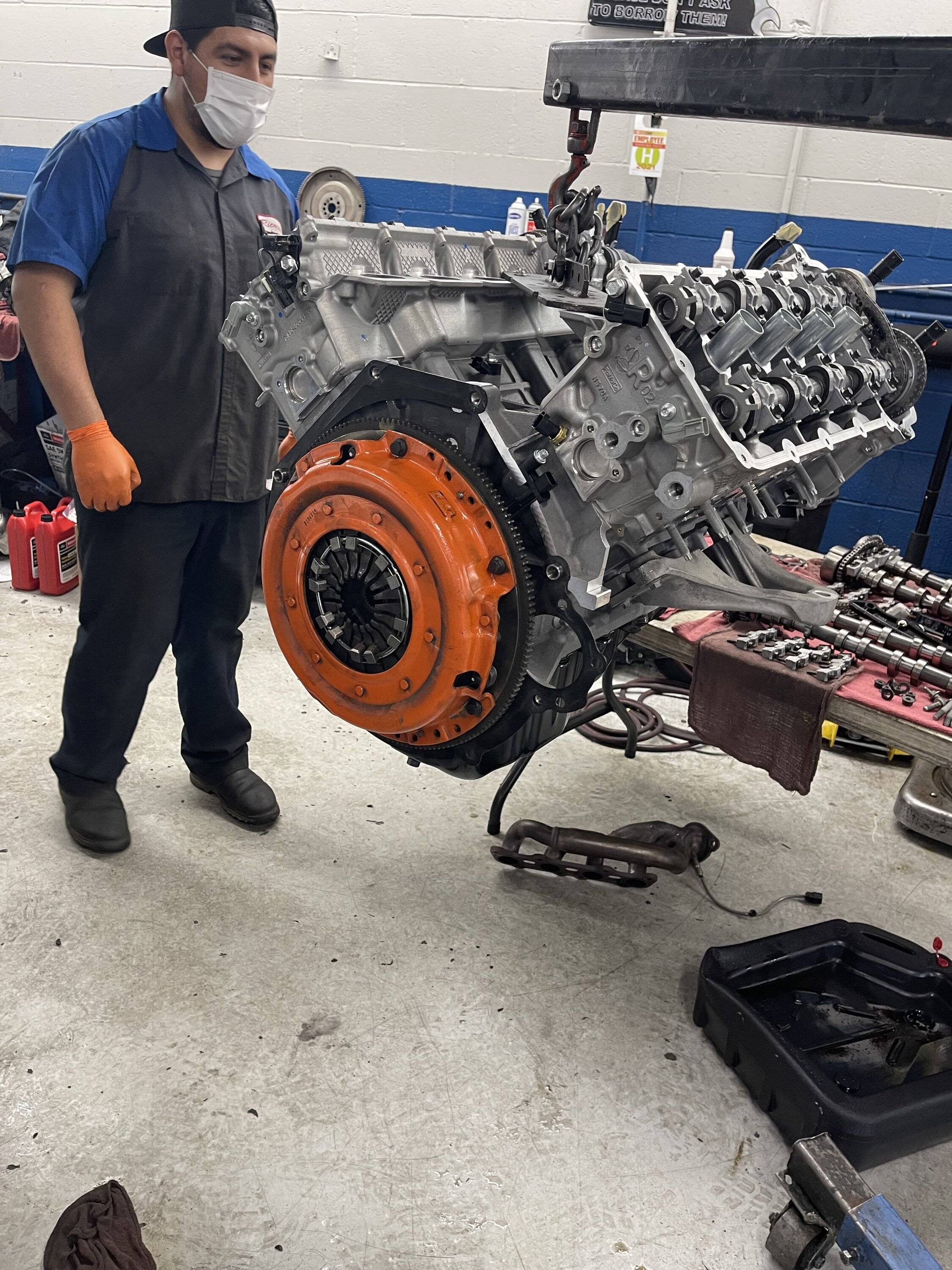

17 pp. 32k miles
2 clutches, 7 and 13k. Finally replaced with aftermarket
1 engine at 20k
1 alternator connector at 30k
Car is s a track car only
