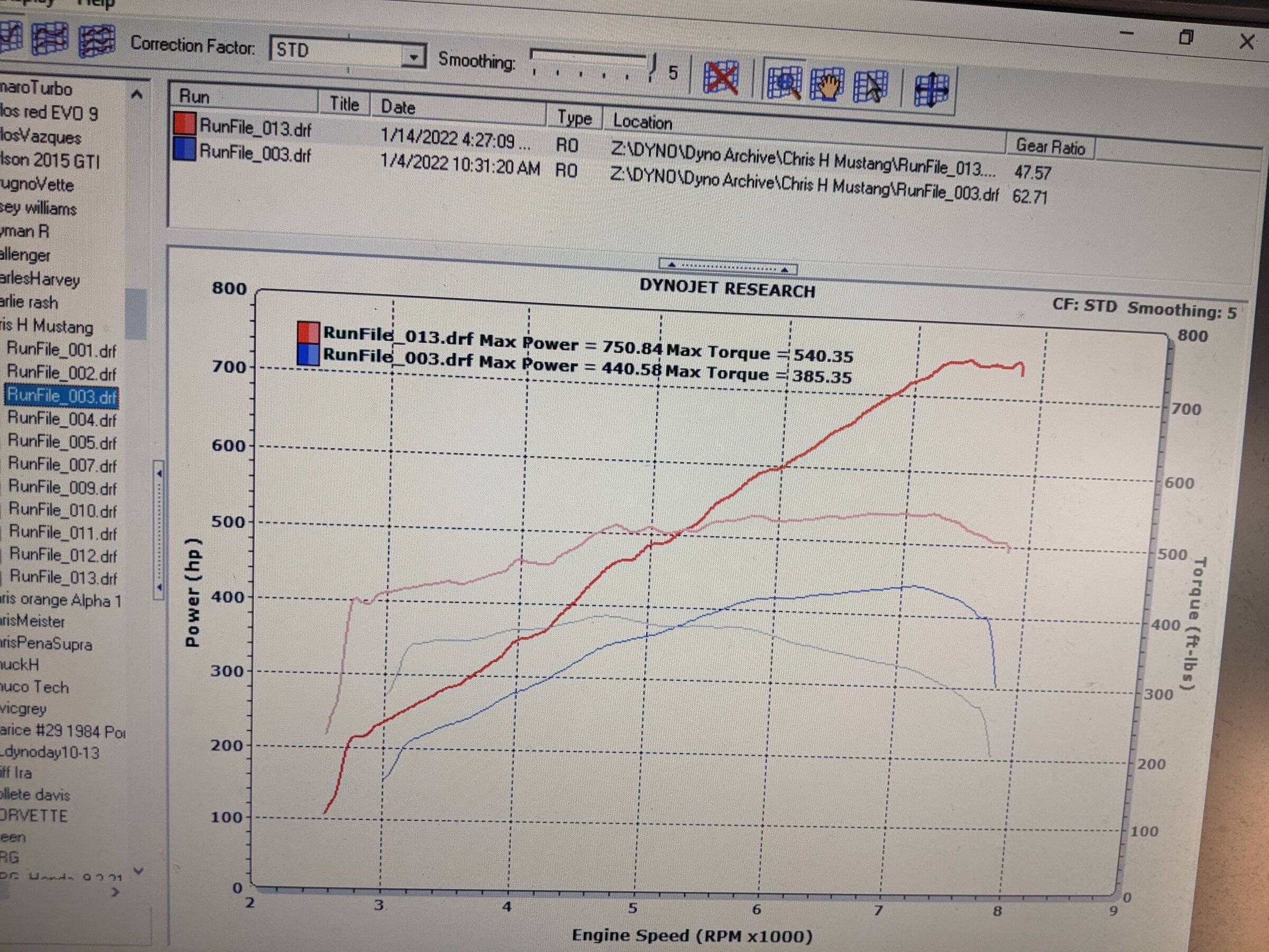

I have a 2016 GT Premium with Performance Package. I just installed a Procharger P1X with 4.63 pulley, Boundary oil pump, and Texas Speed longtubes. I already had the 18+ intake manifold and VMP tune, which made 440hp. With the Procharger and headers I made 750hp and 540tq. Next step is new tires to handle the power, I just ordered a set of Michelin Pilot Sport Cup 2's and 19"Weld Venturas, rear tires will be 305's. Current tune is from Palm Beach Dyno.
Just throwing this up for data.

Very nice, thanks for sharing. on E85, 93, 93 with octane booster ?

For a 4.63 pulley, that looks as good one could expect. Nice work. Which Procharger kit and with stock Procharger intake/filter?

This one is the Stage 2 with the Procharger intake, and the standard BOV. I ordered part number 1FW202-SCI-H-P1X. I have a list of every part that was installed, if anybody needs it. Down to the pick up tube gasket and valve cover bolts (to add bolts where Ford skimped on it).

Agreed, just wasn't sure if that pump alone would support that much power. I've read mixed opinions, getting ready to put my car together and already ordered the BAP but I think i'm going to go with that pump instead

Do you know peak timing? Great numbers
