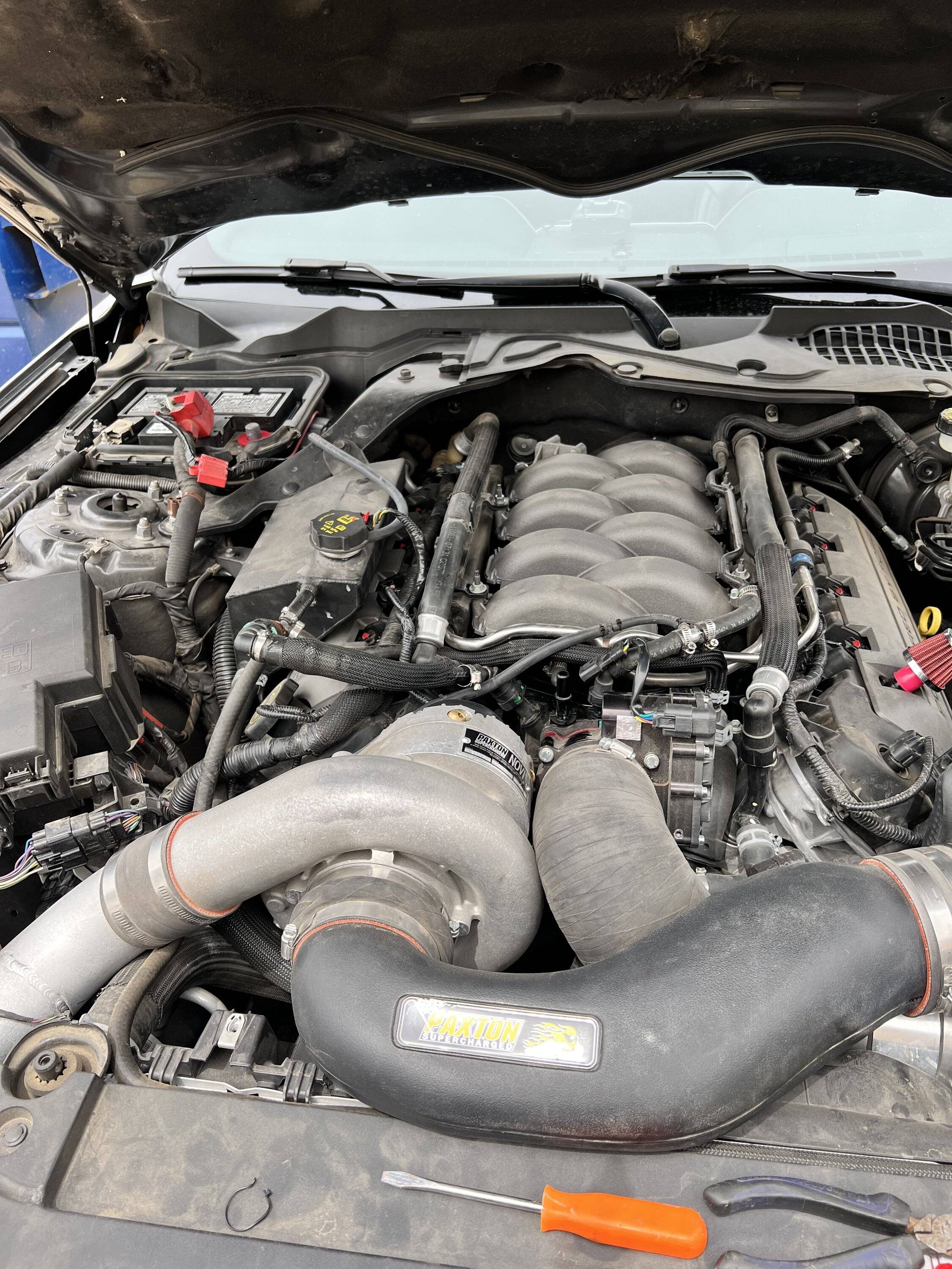

Hello all, I’ve been fighting an issue with my stang for over a year and after countless hours and searching I can’t seem to find a solid solution to my problem.
Car: 2015 mustang GT
Mod list:
Paxton 2200sl
3.33 pulley
2018 intake manifold (locked out)
Id1050x injectors
Long tube headers catless
NGK 6510s plugs gap .030
Beefcake racing torque booster kit
Maxflox rave BOV
Jlt intake
Ford performance vct solenoids
Vmp BAP
DSS one piece aluminum drive shaft
Lethal performance hdx clutch
DSS 1500+hp axles
Steeda rear IRS stop the hop kit
Weld laguna bead lock rears with Mickey Thompson et s/s
Weld laguna front with nitto g2s
Barton short throw shifter
Drive shaft safety loop
Trans bushing kit
Stock MT82
Billet OPG/crank
91 octane tune from Ortiz performance
Graham’s throttle body with spacer
Reische 170 thermostat
720RWHP 658ftlbs torque
*probably missing some
issue:

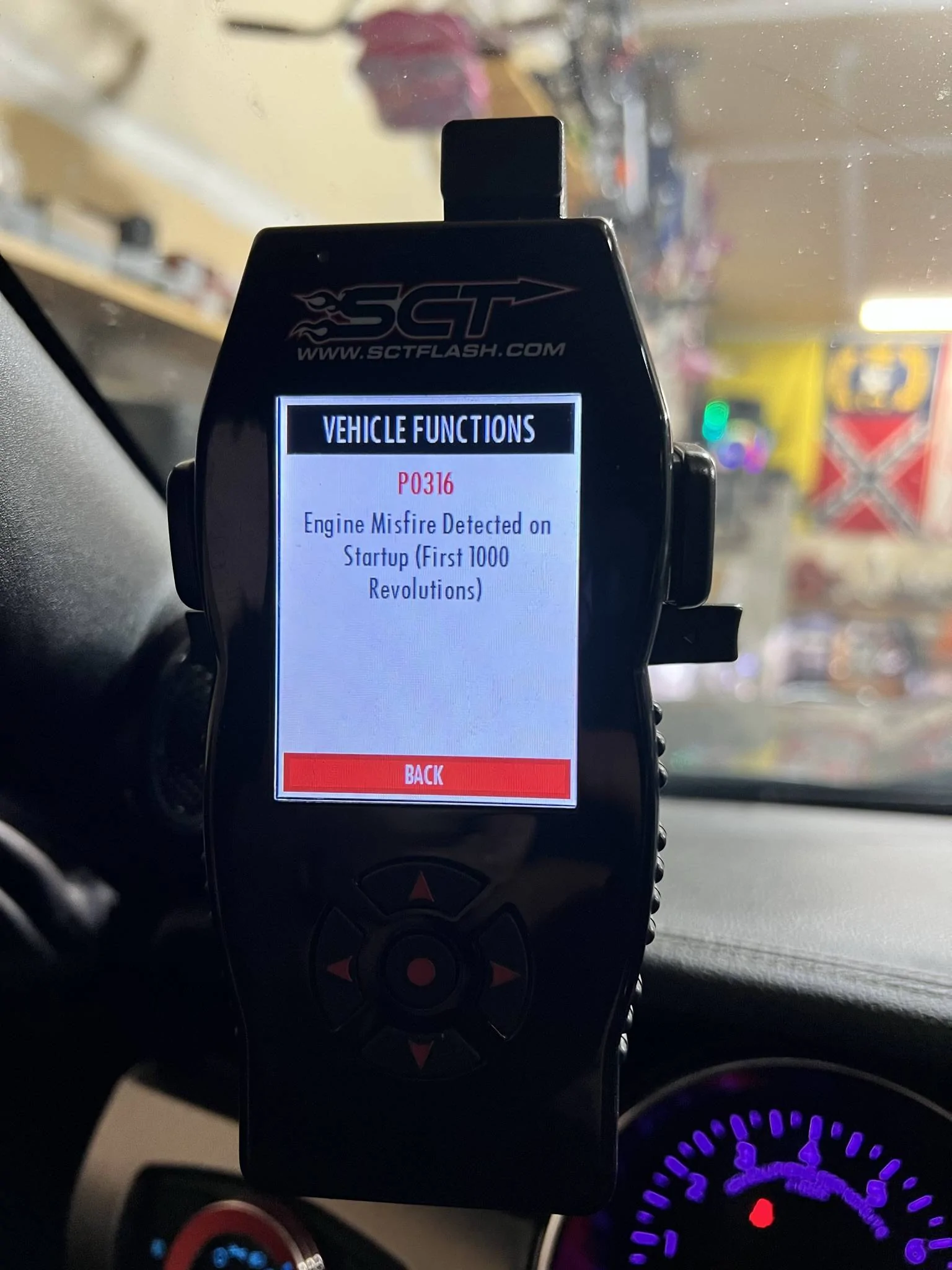

After driving vehicle for about a year on this setup 2000 miles total, I have ran into an idle issue. When the vehicle first starts idle holds perfect along with afr vaccum etc. When car warms up the idle will hold at 850-900ish then drop down to around 500rpms and then jump back up and continue to do so while at idle. Under throttle in gear car runs perfect doesn’t stall or die. But when returning to idle the issue persists. I will at times get a random/multiple misfire code. I clear it and drive on for a few days/weeks and it won’t return but still will have idle issue. I have tried 2 different tuners both local and an etune nothing corrected. I have replaced VCT solenoids, spark plugs, changed oils, different fuel stations, octane boosters, vaccum leak test, replaced egr swapped to stock throttle body and back to aftermarket one, cleaned maf sensor, changed battery, did compression test, performed kam reset/crank relearn etc. I’m over throwing parts at it and don’t have a local shop that’s worth a crap to take it to for help. Have also noticed at times under light throttle in 3rd gear around 3400-3500rpms out of boost if I WOT vehicle will hesitate for a second then hold power. Vehicle will launch fine run down the strip fine with no buck smooth as can be but idle like shit in my opinion. I have a return style stage 2 dual pump fuel system on order to install for e85 but am trying to cut this issue out before install. Vehicle is located in lovely Colorado at an altitude of 4600ft car has ran 11.2 @122 launching at 1500 rpms but I’m shooting for 10s this year. I’m stumped and it’s making me insane lol. Any help is appreciated I apologize for the long post but I want to give as much info possible for those who read it and may have similar issues or have insight.

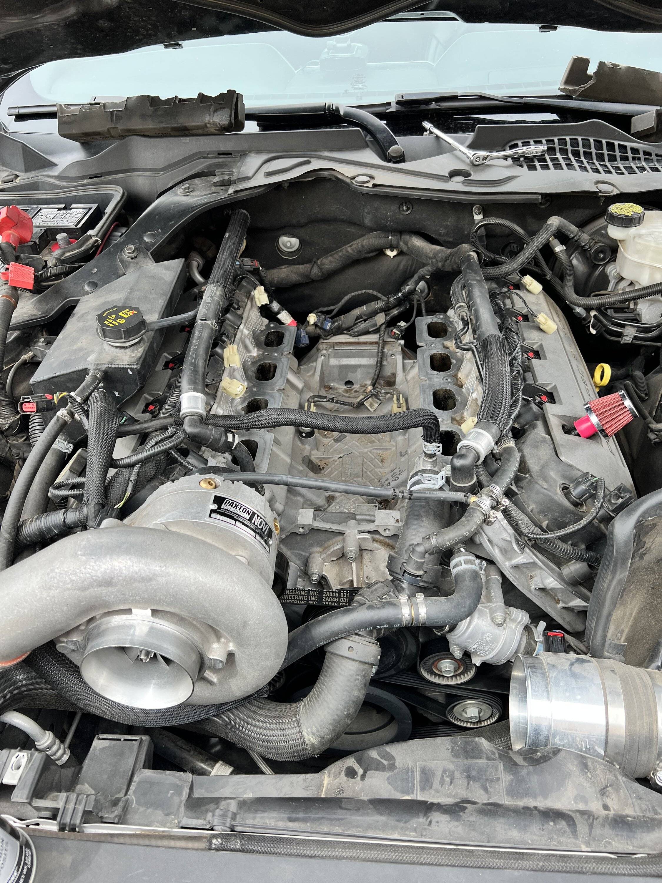

I have a new in box manifold I may just try and swap out and see was wondering if I did the ol carb cleaner trick to see if I spray around it idle changes
KingKona
Jan 6, 2022
2,904
2,855
Virginia
Shlomo
2019 GT
I don't think the carb cleaner thing will work. I'd just change it out, being sure to also replace the gaskets.
Nathan5150
Nathan5150
Jun 23, 2021
Colorado
Nathan
2015 mustang GT premium
Well replaced it still has slight idle fluctuations starting to wonder if a retune is necessary or possible stock fuel pump issue?
