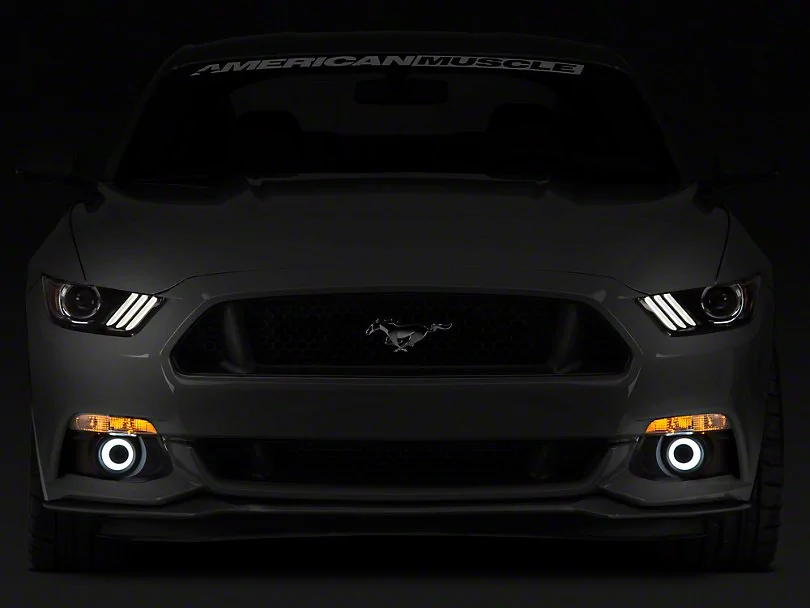

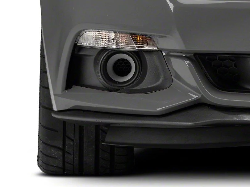

Raxiom LED Halo Fog Lights
[MENTION=14834]John577[/MENTION] (or anyone else who has experience with those lights) I am looking to buy those Raxiom LED Halo Fog Lights from American Muscle.
https://www.americanmuscle.com/raxiom-led-halo-fog-lights-1517-w-factory-fog-lights.html
In their site they state that they will not work properly on a European Mustang. If it's simply a wire splicing thing, I don't mind the work, it can easily be done.
Any ideas if these lights can be modified so that they work on our European cars?
