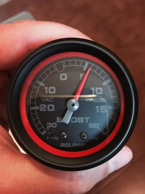

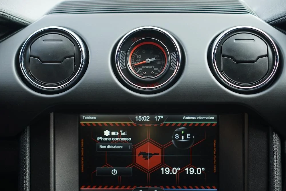

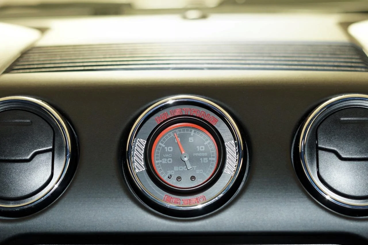

Hi!
I did the job by myself:
-At first I ordered a custom boost Gauge from Autometer; they have a custom shop that let you create the gauge with a large selection of colors, fonts, combinations.
-After that I designed ad made with a CNC plotter the holder because I wanted something cool to watch with a custom graphic and also because the roush one (that I don't like so much) it's crazy expensive for a peace of plastic...and leave the vent always opened...
-At the end I adapted the stock vent internal part and connected the gauge and...voilĂ !

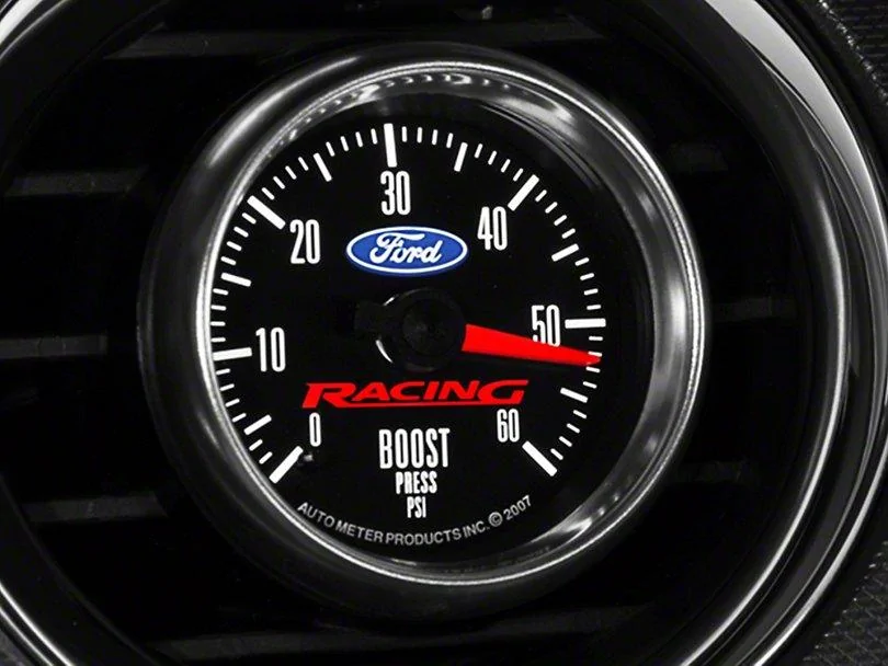

I guess I'll revive this thread. ;) Has anyone, in europe, successfully added a vacuum / boost guage ?
I'm interested in adding this boost guage however, I've seen the comments and discussions about the difficulities. :confused:
https://www.americanmuscle.com/fordracing-boost.html
