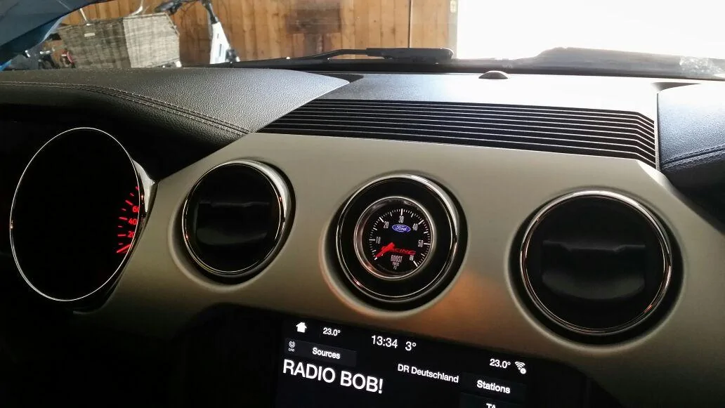

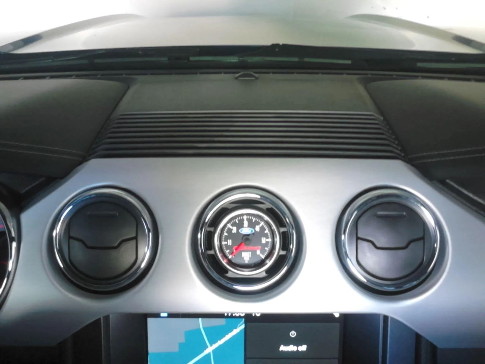

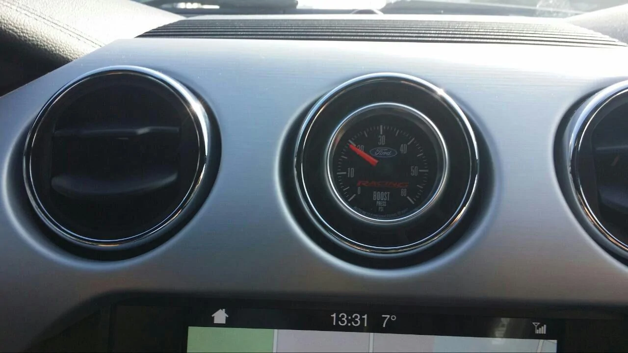

I got the Ford Racing Boost Gauge installed. It was a lot of work however, I'm very pleased with the results. :cool:

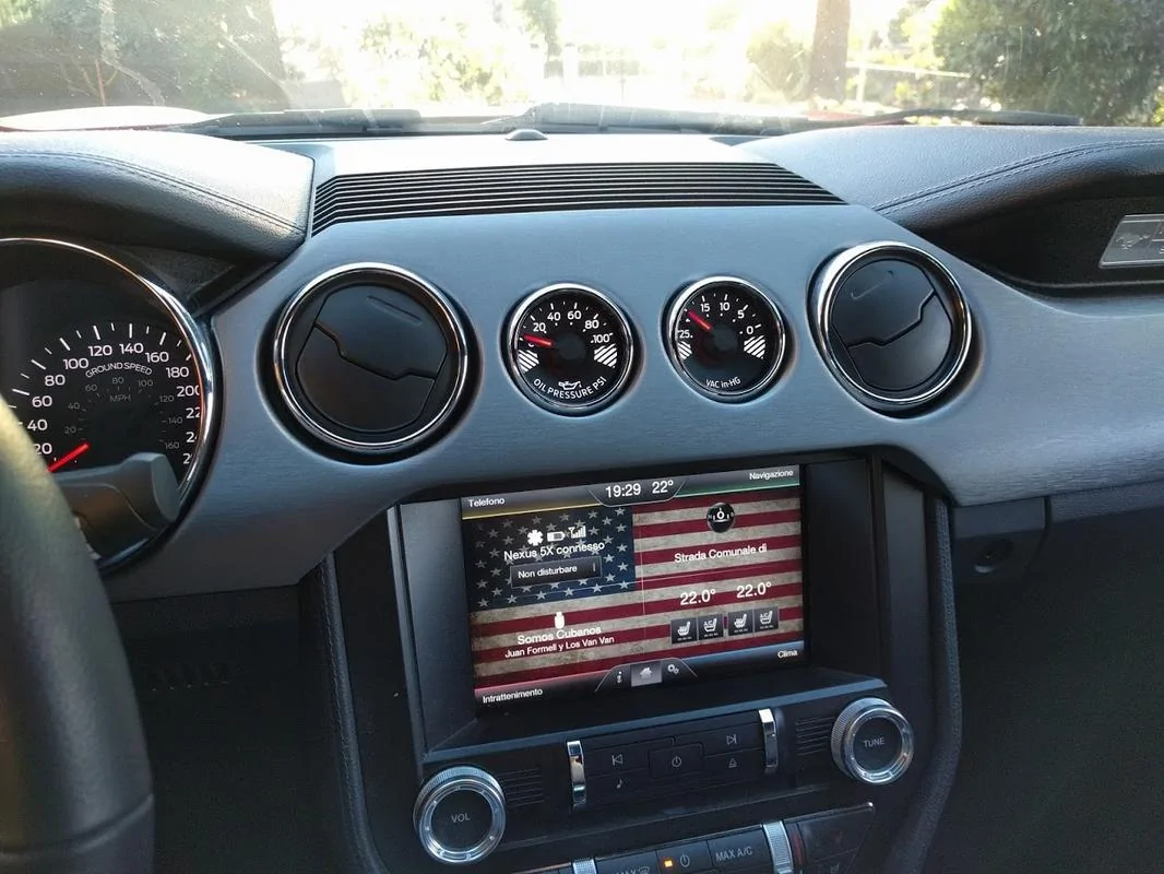

Sure but I can say that, even with oil pressure not working, the look is amazing :)

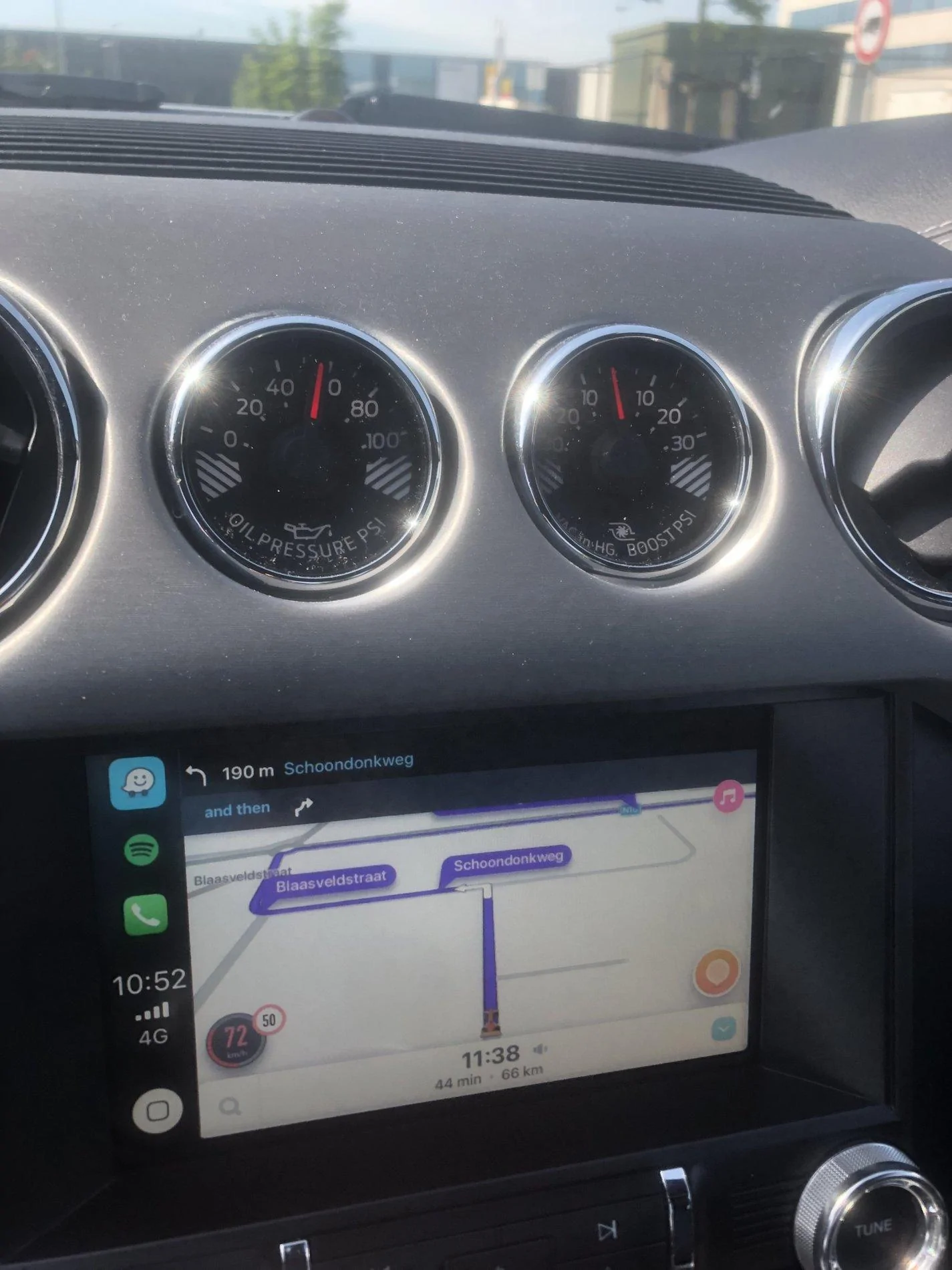

Just for your info, got it all installed and working...
