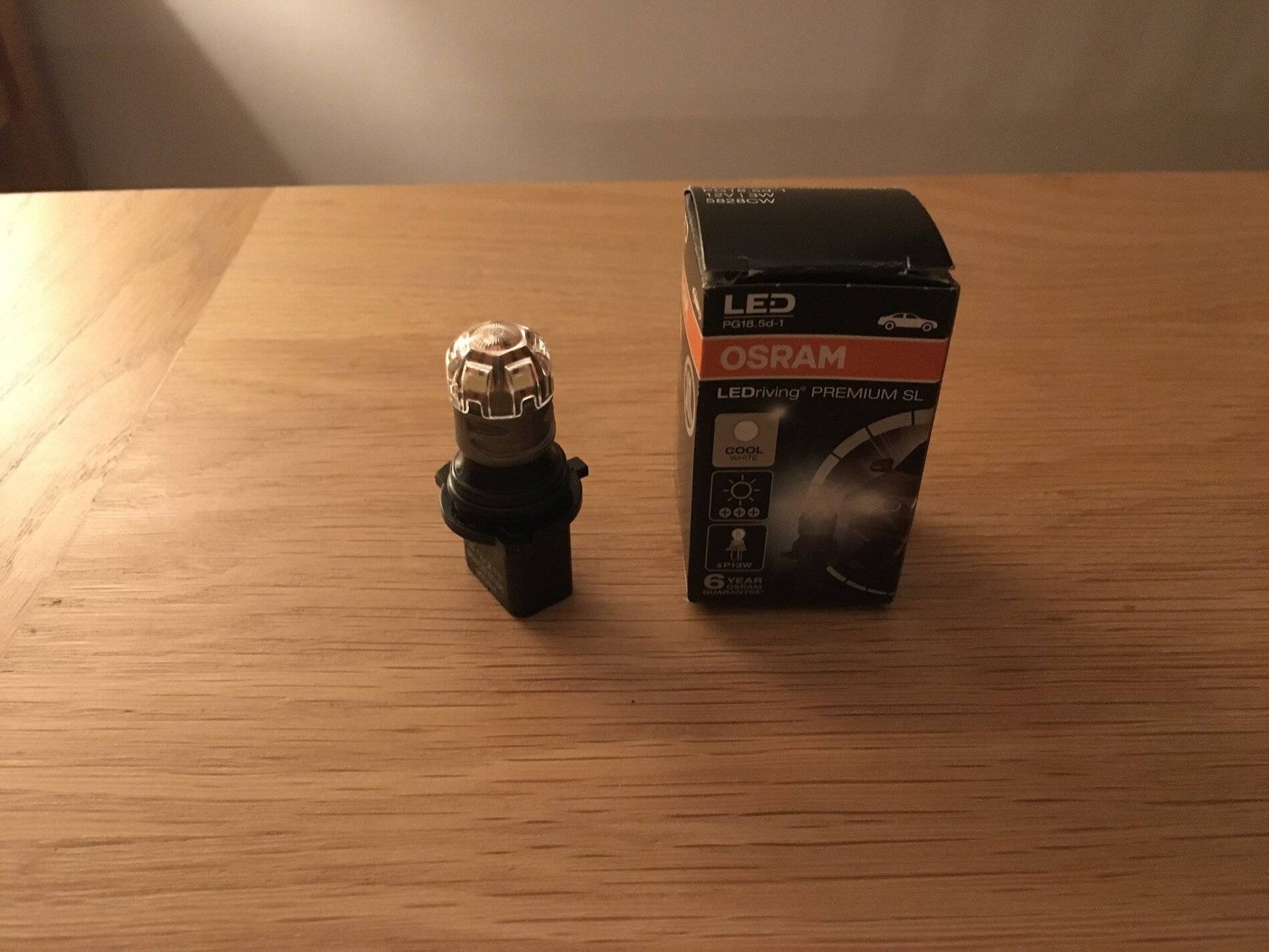

Hi EngelenV,
I bought Osrams Leds on your recommendation but dont know how to manage to fit them as the bulb housing is straight, the existing socket is L shape. If included a photo of the Osram bulb. If there is anything I need to do to get them to fit let me know, please. Also the Osram bulb seems toowide to fit in the lens aperture
