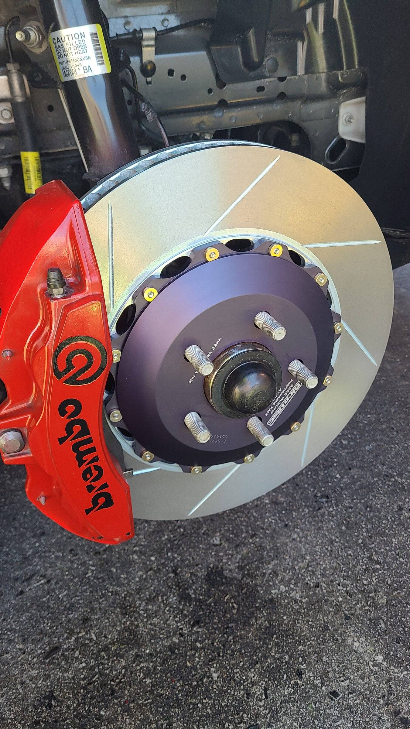

The two piece kit from Steeda is expensive, that is not my issue. My issue is that they don't come marked with a direction for mounting. Both fronts have same serial and no stickers or markers to show which should go left and which should go right. There is no install video for these from Steeda, I have only seen a few really poor quality videos going over install, nothing official from Steeda.
50/50 chance I put them on backwards, no way to tell; being Christmas eve the Steeda hotline is closed. Will call on Monday, I did Roadtest the car and burnished the new hawk pads on them, hopefully I didn't ruin them. Really am not going to enjoy doing a second install to correct if backwards. A simple stamp or etching or sticker or anything to show left and right side....1800.00 set of rotors kind of expected a little more.

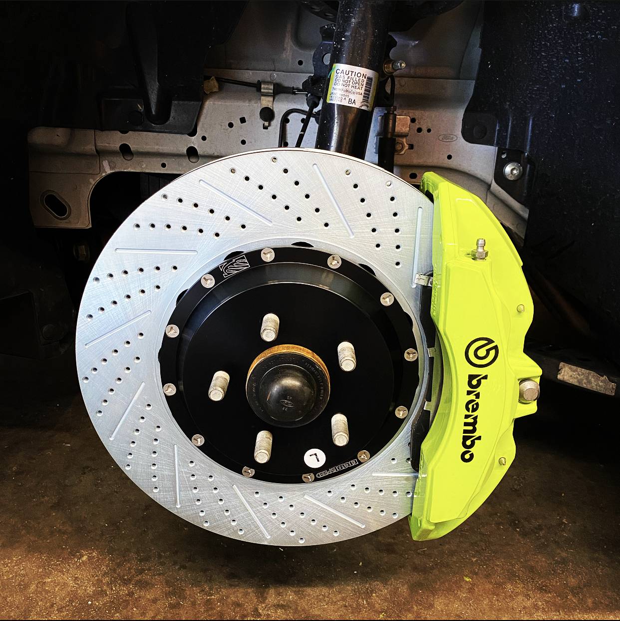

My Baer rotors were marked. And usually they are the direction you would think would be backwards. This is the baers. Not sure on the Steeda. Just have to look at pics elsewhere probably

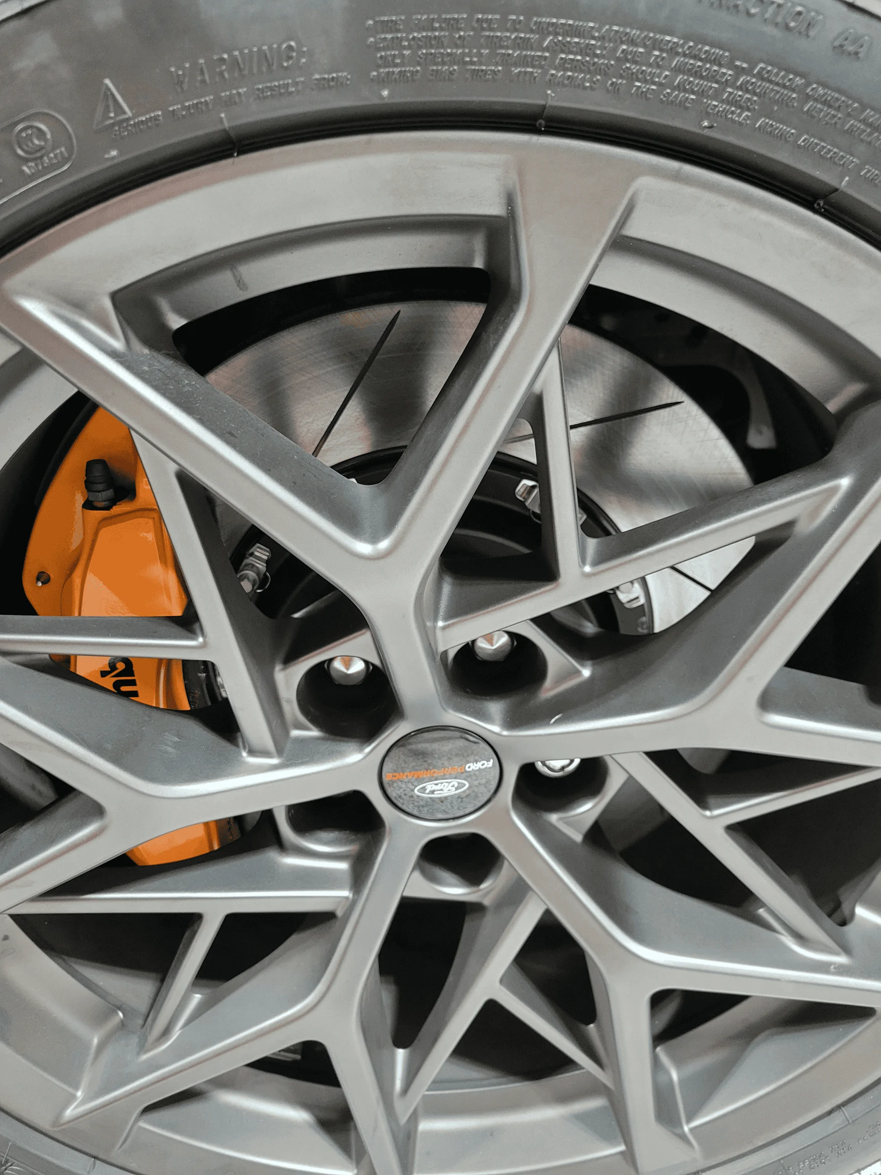

That’s the correct way, swiping down from the top of the rotor.
If you just have the lines in the rotor, it will be the same way as shown, see my right side below.

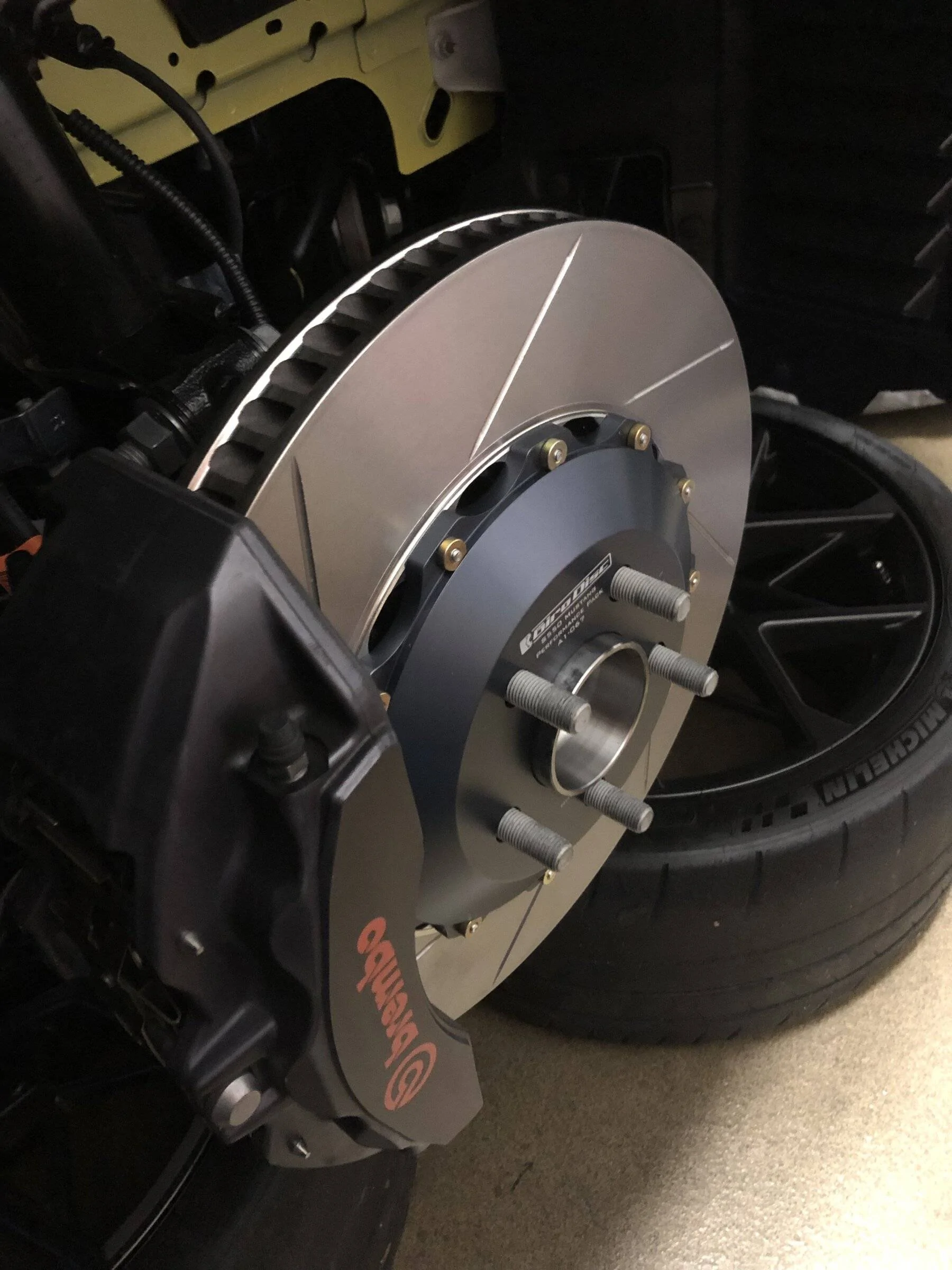

Side note, those calipers are pretty awesome.

Just got off the phone with Steeda, it was like speaking to a wall. They did confirm they are backwards and need reversed. They didnt sound concerned with the lack of stickers, instructions, or any guide video for the install. This is a shame I thought this was a solid outfit but it seems like they are mailing it in like the rest of aftermarket...

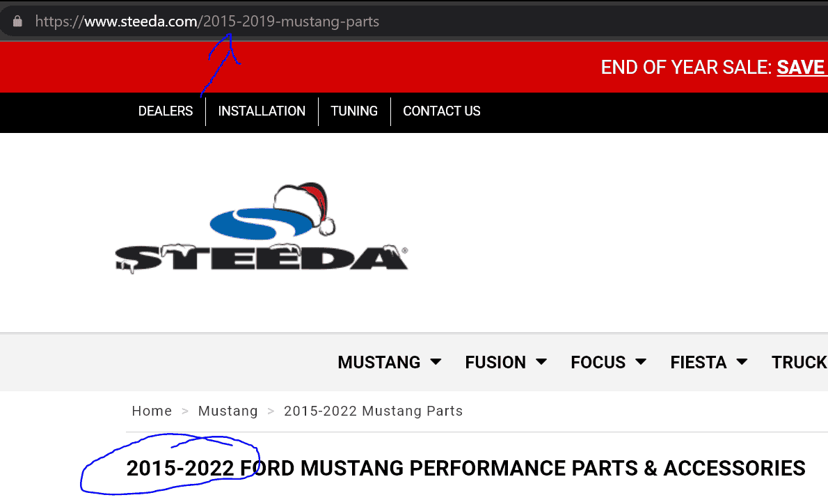

I can tell these guys are mailing it in just by there website, the URL slug has not been updated since 2019.
I just would like a vendor to own their issues, resolve them and be upfront about stuff. Instead they take your money and put you in a holding pattern. Guess its my fault for believing the brand hype.
