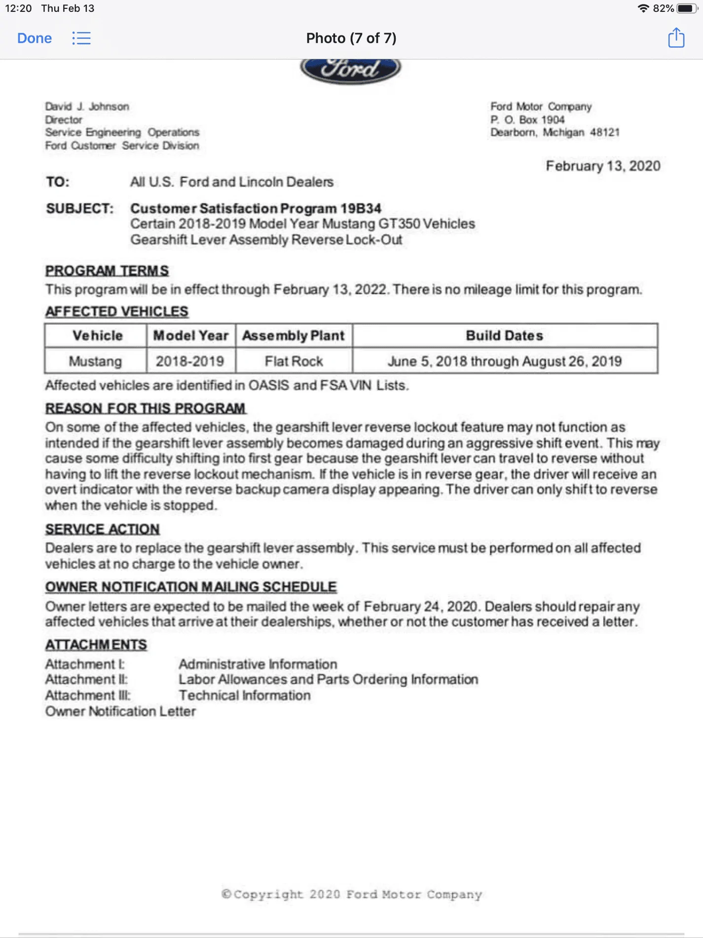

Customer Satisfaction Program 19B34 – Gearshift Lever Assembly Reverse Lock-Out – 2018-2019 Ford Mustang GT350. On some of the affected vehicles, the gearshift lever reverse lockout feature may not function as intended if the gearshift lever assembly becomes damaged during an aggressive shift event.
Most likely your car is not needed this. But you may check by entering VIN #:
https://ford.oemdtc.com/6177/custom...the affected,during an aggressive shift event.

My ā€˜19, which I bought new this past June has a build date of June ā€˜19. I assume the shift lever problem was taken care of before I bought the car.
Is there a way I can check without contacting the dealership?
Edit: BTW shifter works just fine. The first couple times using reverse there was slight difficulty. Zero issues since.

Says through August 26th of 2019
