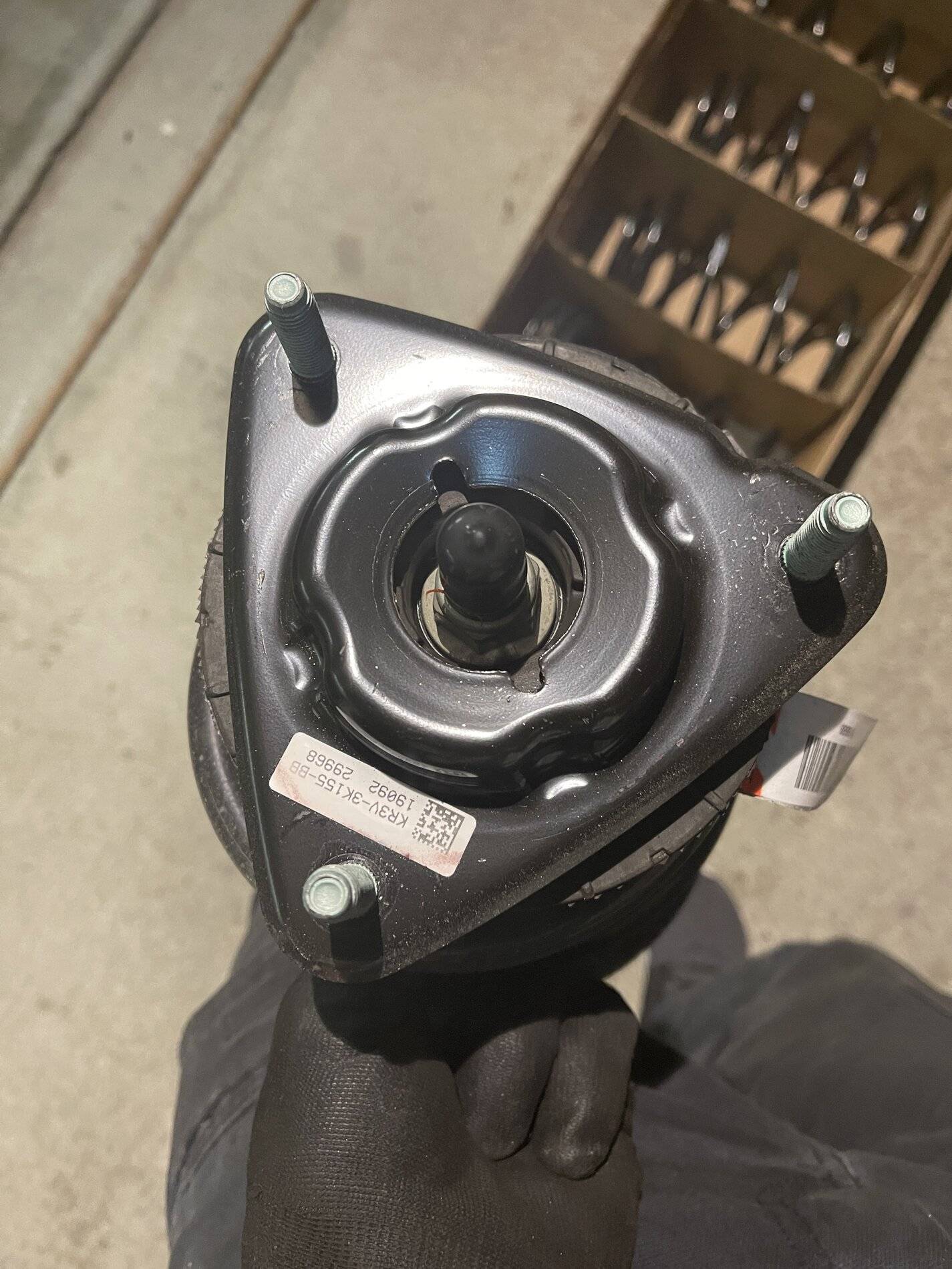

2019 GT350R
there's more than enough camber available at the rear. Your dealer owes you the camber plates that were supposed to have been installed during delivery.
def not adjustable

I thought the R's had the adjustable ones installed at the factory?
Scoobs
Jun 23, 2016
407
356
Ontario
2017 MG GT350 sold, 2019 MG GT350R KR569
The 2019 R models did not have the adjustable camber plates installed at the factory. They were a dealer installed item and were shipped to the selling dealer separately. If your dealer didn't install them or at least give them to you then they are no doubt sitting on a shelf in the parts dept. Early 2020 R models also did not have them factory installed but at some point during the production year Ford started installing them during assembly. The window sticker of 2020 R models will indicate if a particular R had the camber plates as a dealer install. If the sticker doesn't say dealer install then they were installed during assembly.

Was about to say the only factory adjustable options for camber were the new strut mount on the 2020/2021's, and thats in the front only.
