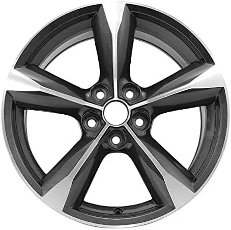

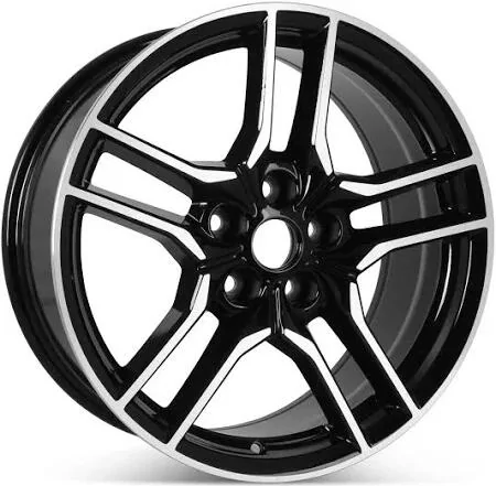

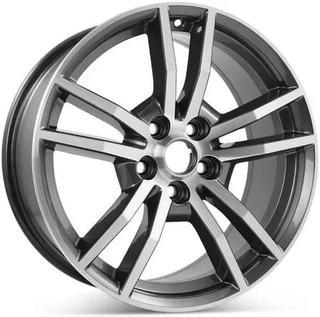

OP there are a bunch of options for 18 inch setups.
If you wanted to stay OEM, any of the classic 6 generation rims will work - please be mindful that if you have a GT premium with the Brembo 6 piston brakes, then you will need a 19+ inch rims for proper clearance.
OEM 18 inch rim options over the years:

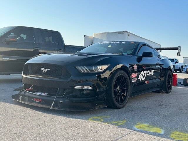

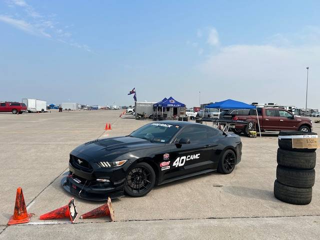

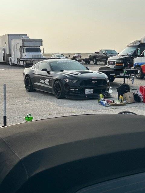

18s because motorsports. These are 11" fronts and 12" rears with 315/30 tires.

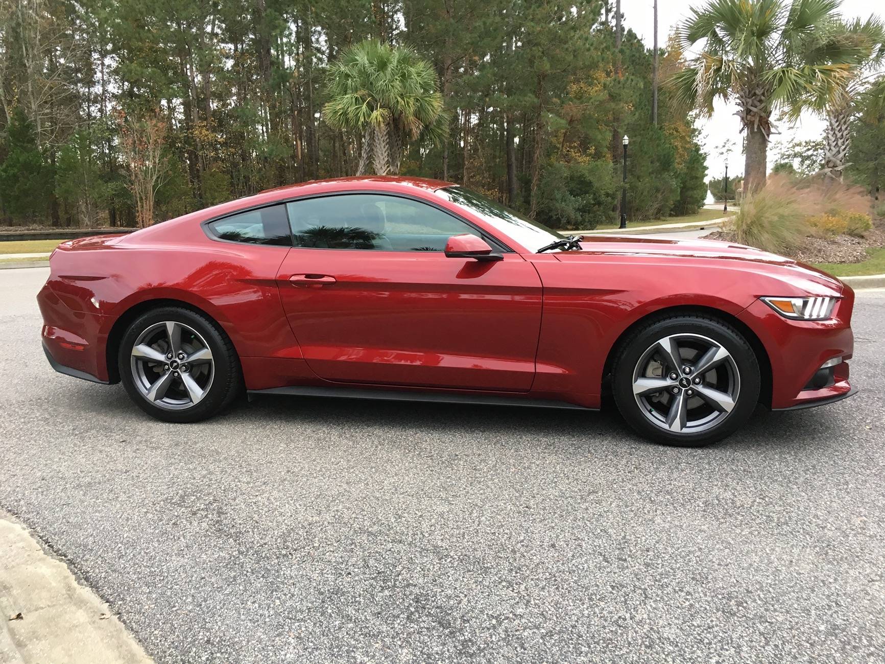

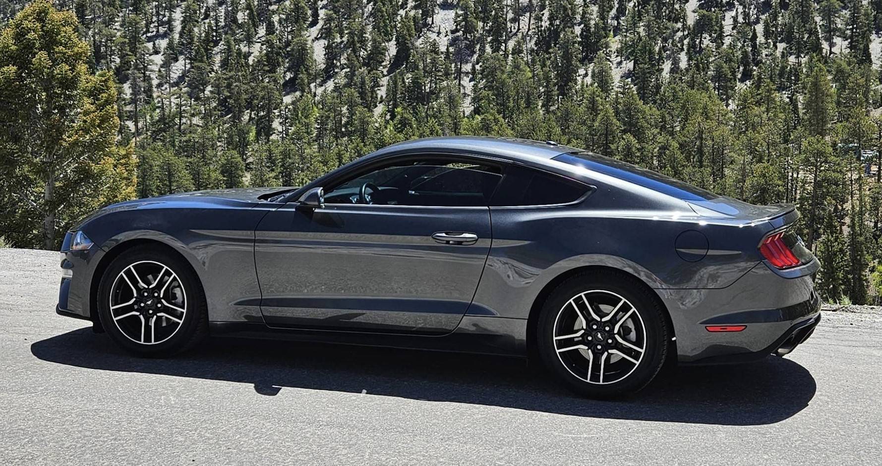

My 2019 came with 18s. FYI, the base EB came with 17s and a 55 tire. 18 " wheels come with a 50 series tire.
