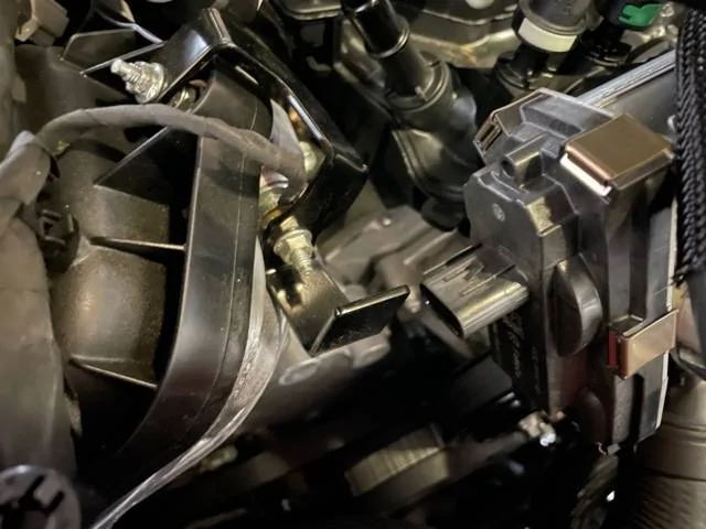

^^^ Looks fine to me. Mine aren't straight either. As long as its snug.

In case anyone was wondering, the FP passenger side air-oil separator does not fit with this kit. The mounting bracket prevents the slectrical connector from being installed on the trottle body. Even with the bracket removed, the body of the air-oil separator will rest directly on the electrical wires.
I found this out after my kit was installed and even posted about it.

FP has confirmed this as well. We are adding notes to both products at this time. We are sorry but this information was not originally made available on FP's site.
- Benny
Thanks Benny!
It's not a huge deal. Kind of comes with the territory when it comes to fitment and mods.
Do you (or anyone else) know if M-6766-A50S air-oil separator would work with the 5.0 and this power pack?
Also, does FP make a passenger side air-oil separator that would work with this kit?

I'm using a UPR oil seperator. The one that hides by the windshield washer fluid tank.

Hmm Im not sure as only the RH separator now has this incompatibility note. I did find this video that has good views and angles of the LH side one
Not at this time and I doubt they will, Perhaps just a revised bracket could solve this.

I have JLT oil seperator for passenger side. And you can reverse the hoses on the can, it works and fits fine. When I did the power pack, the JLT can was really tight in there and I just reversed the hoses, switch short and long hose with the nuts and it works. Just hangs there kind of tilted but doesnt touch any wires.

Ah I ran into this as well. Or rather the dealer that installed it did. They put it back to stock without the oil separator to finish the install. I reinstalled the separator at home sans bracket. One of the tubes is flexible so I was able position it so it's not pressing on anything. Doesn't look great, but it is functional.
