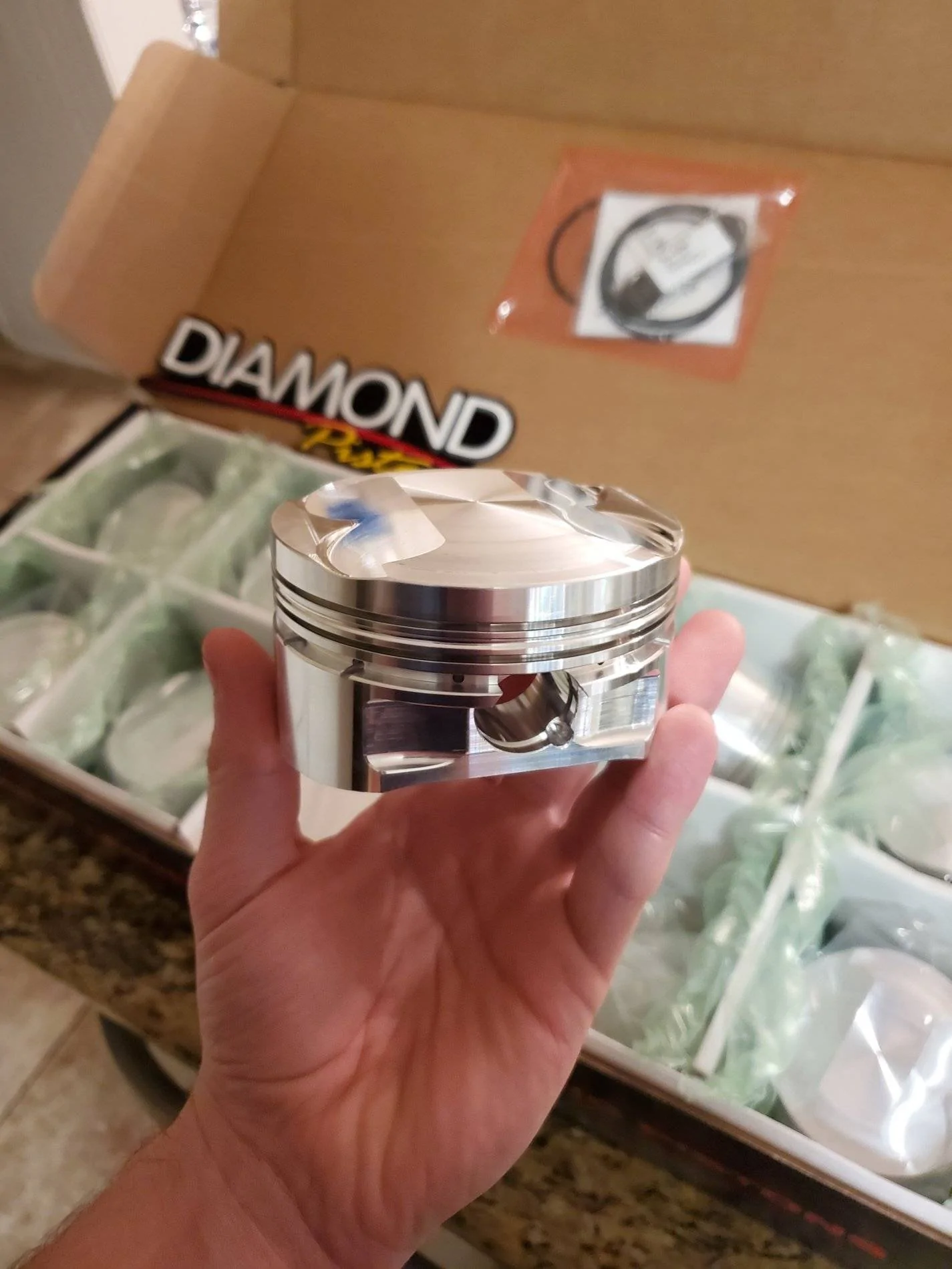

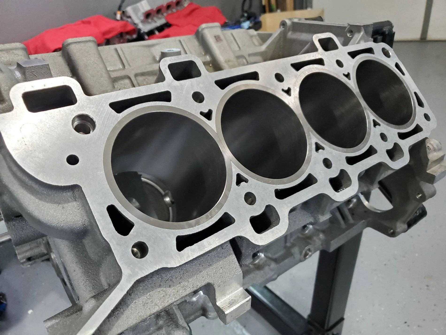

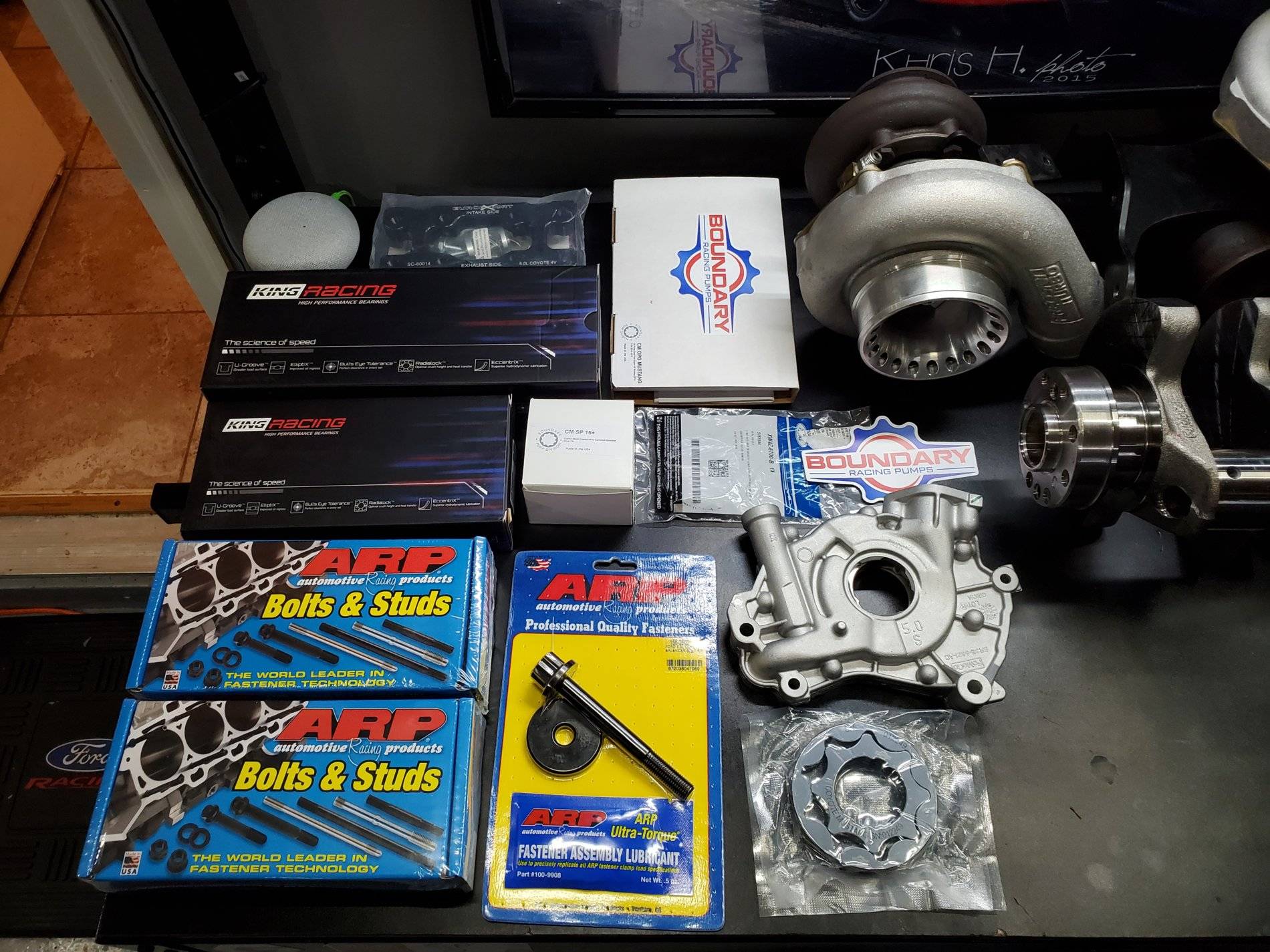

Just got my block back from L&M engines, they did the sleeves and I'll be doing the entire assembly myself.. Looking for low 8s and 1250-1350whp on kill, going to find the limits of the gen2 62mm turbos pretty quick probably.
Build List:
Sleeved block by L&M Engines
Diamond 11.5:1 CR Pistons
Wiseco Boostline Rods
All ARP hardware
Boundary OPG & CS
King bearings
MMR Oil squirter block offs

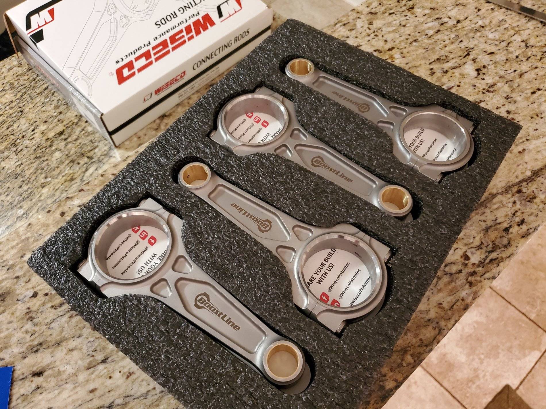

Man those Wiseco Rods are pretty!
Making me change the route I want to go! lol

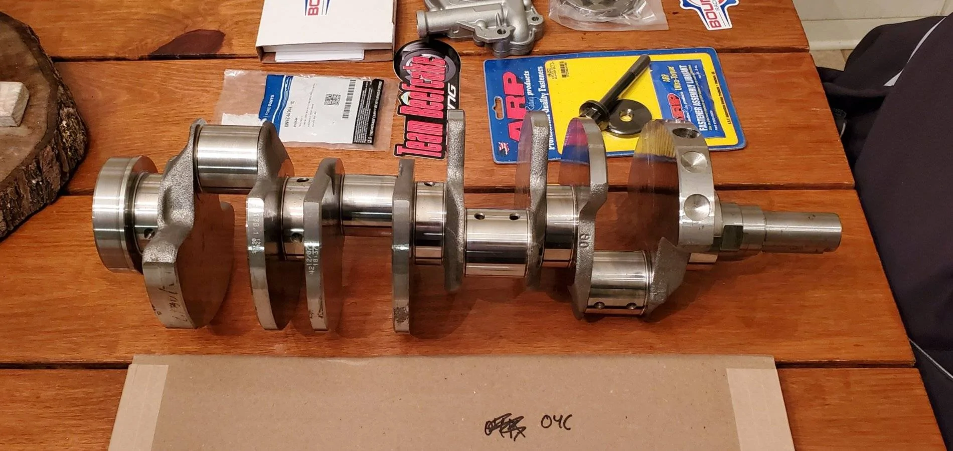

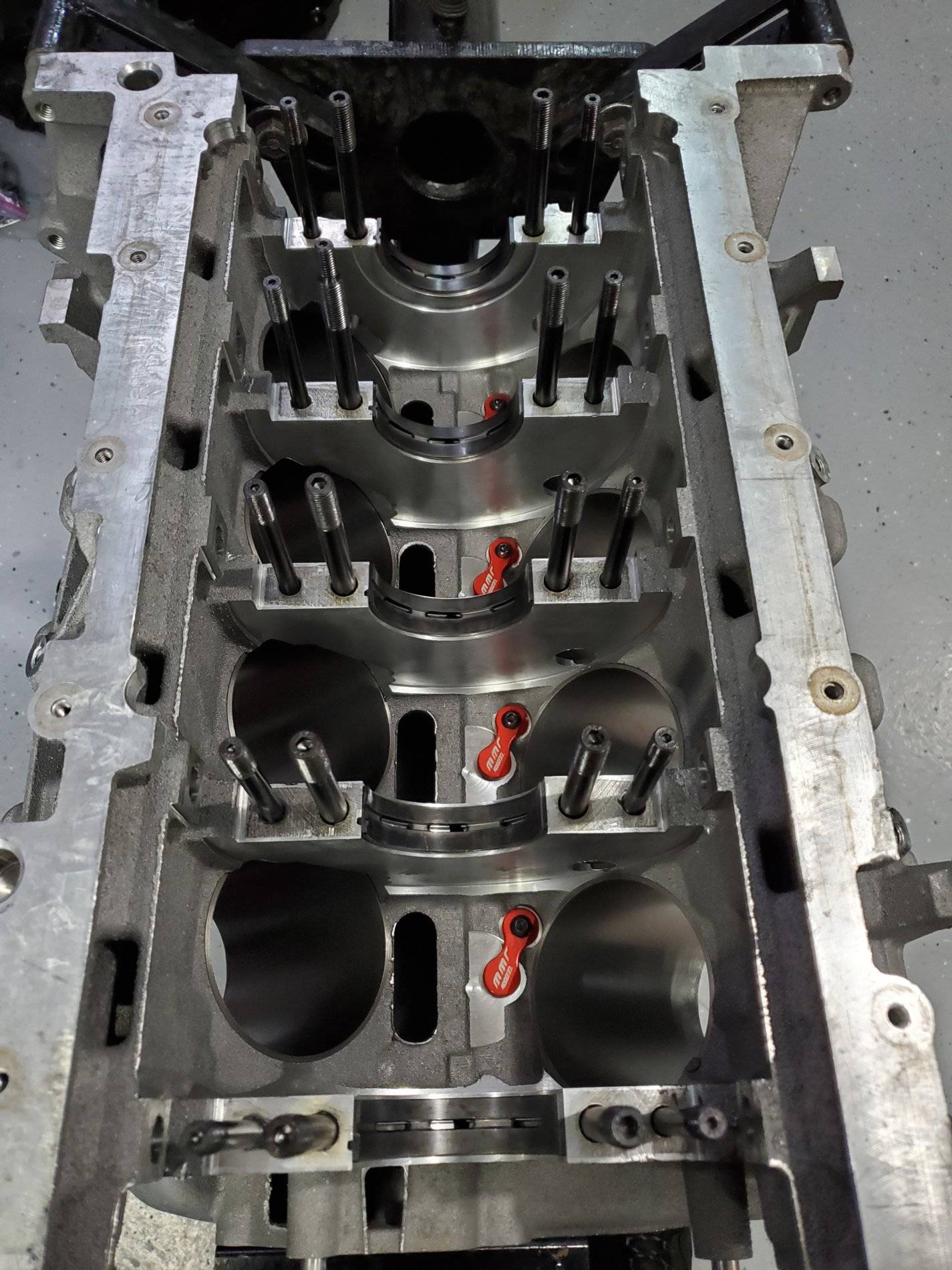

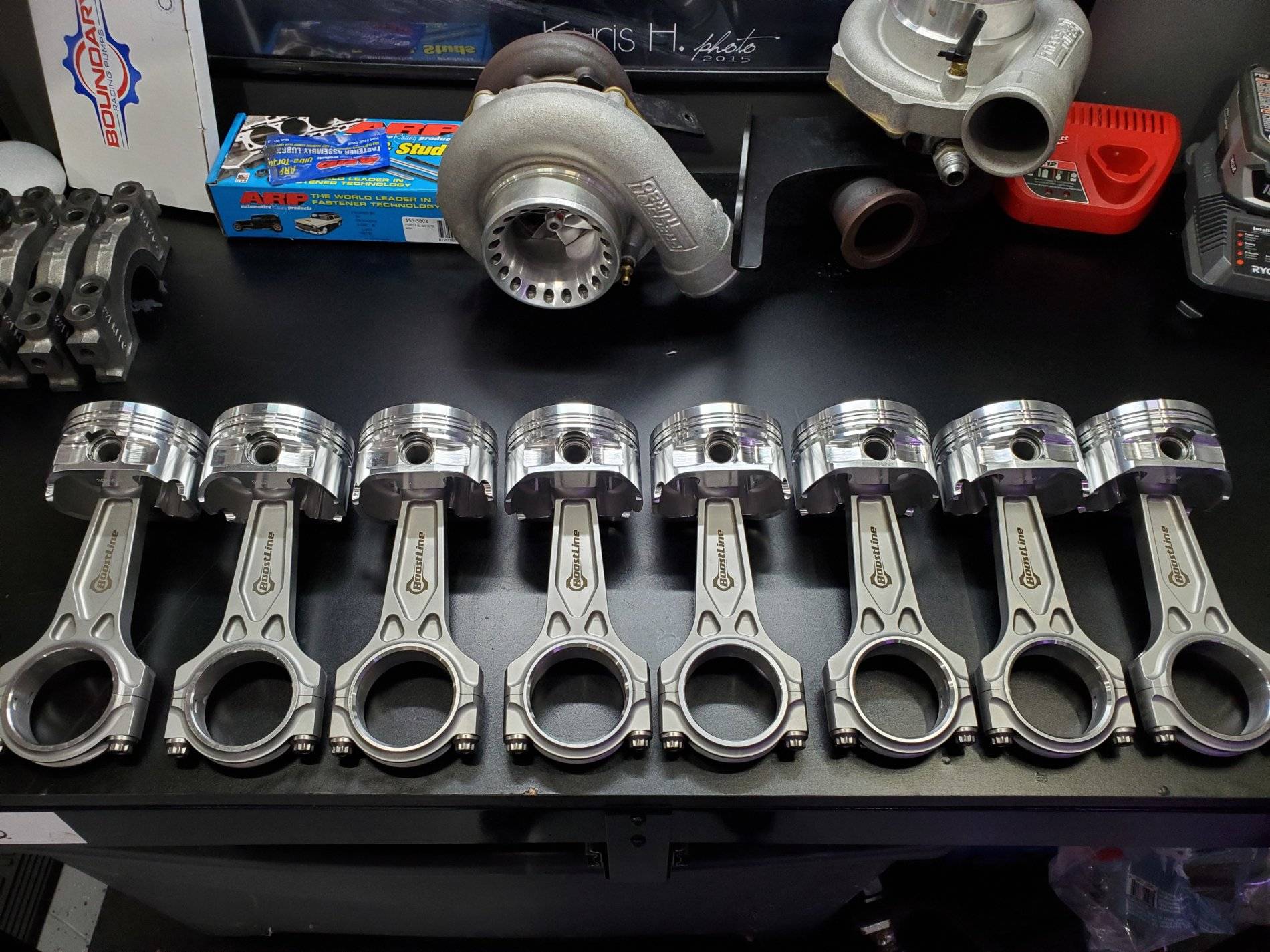

Wound up returning the crank due to rust on the journals which was hard to see, waiting on the replacement now. In the meantime got the pistons on the rods!

Engine porn. :like: Following this build.

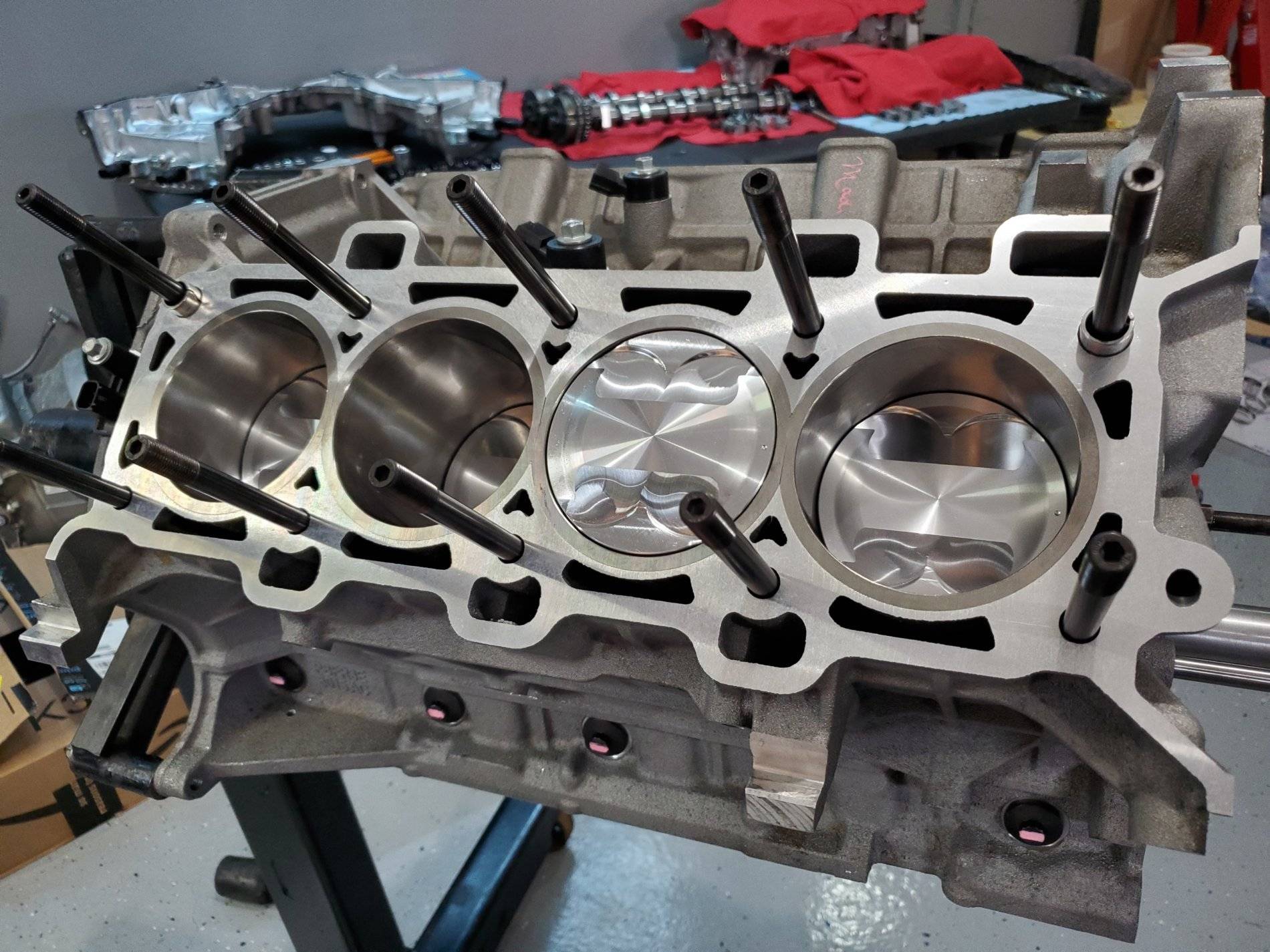

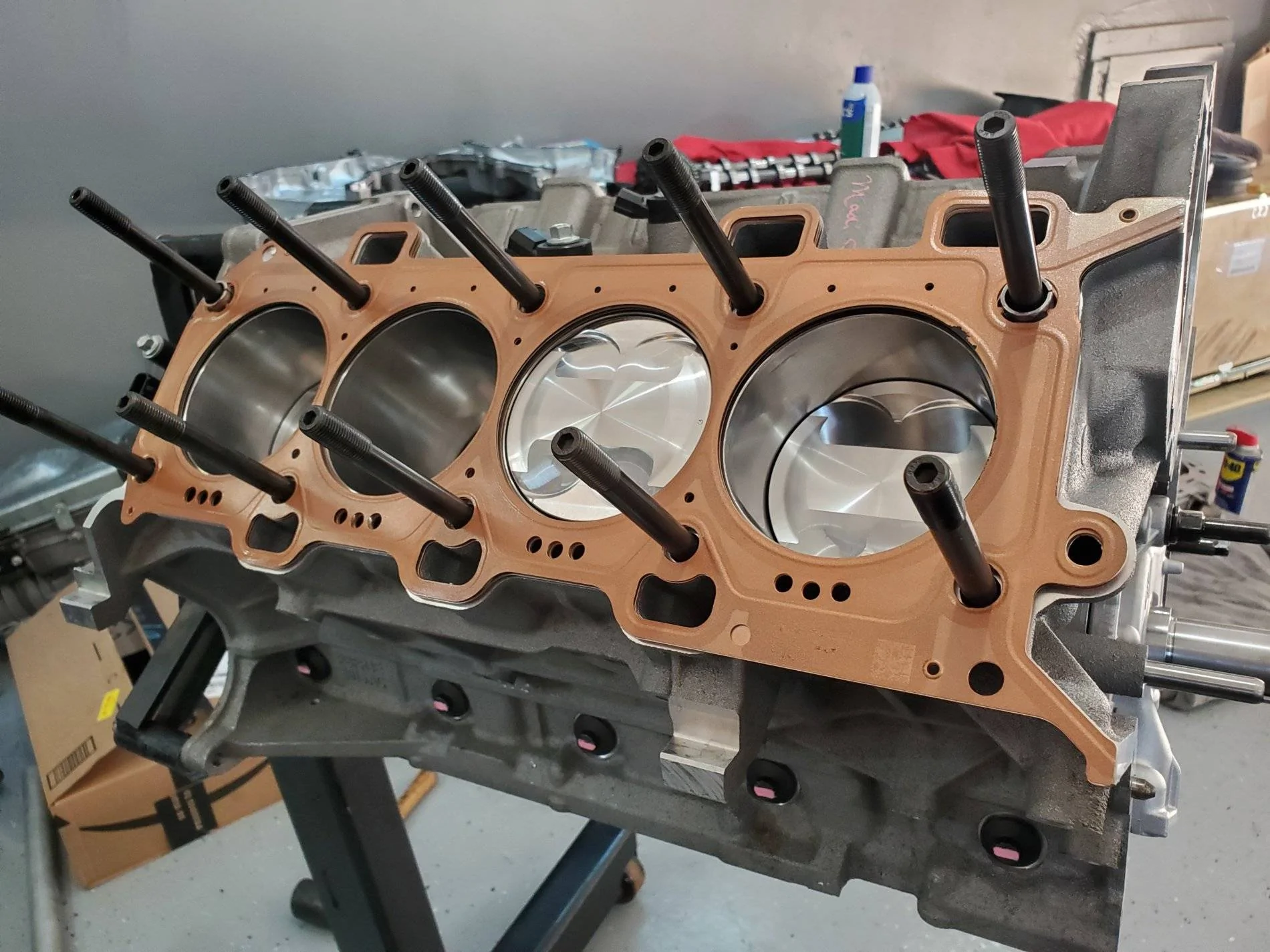

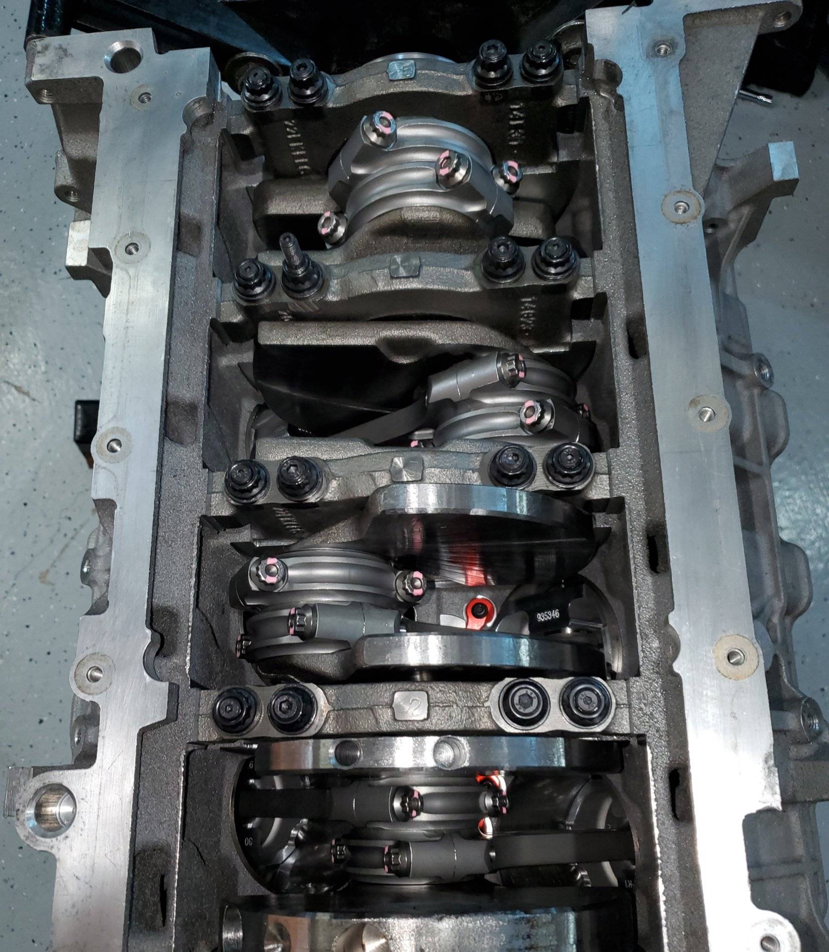

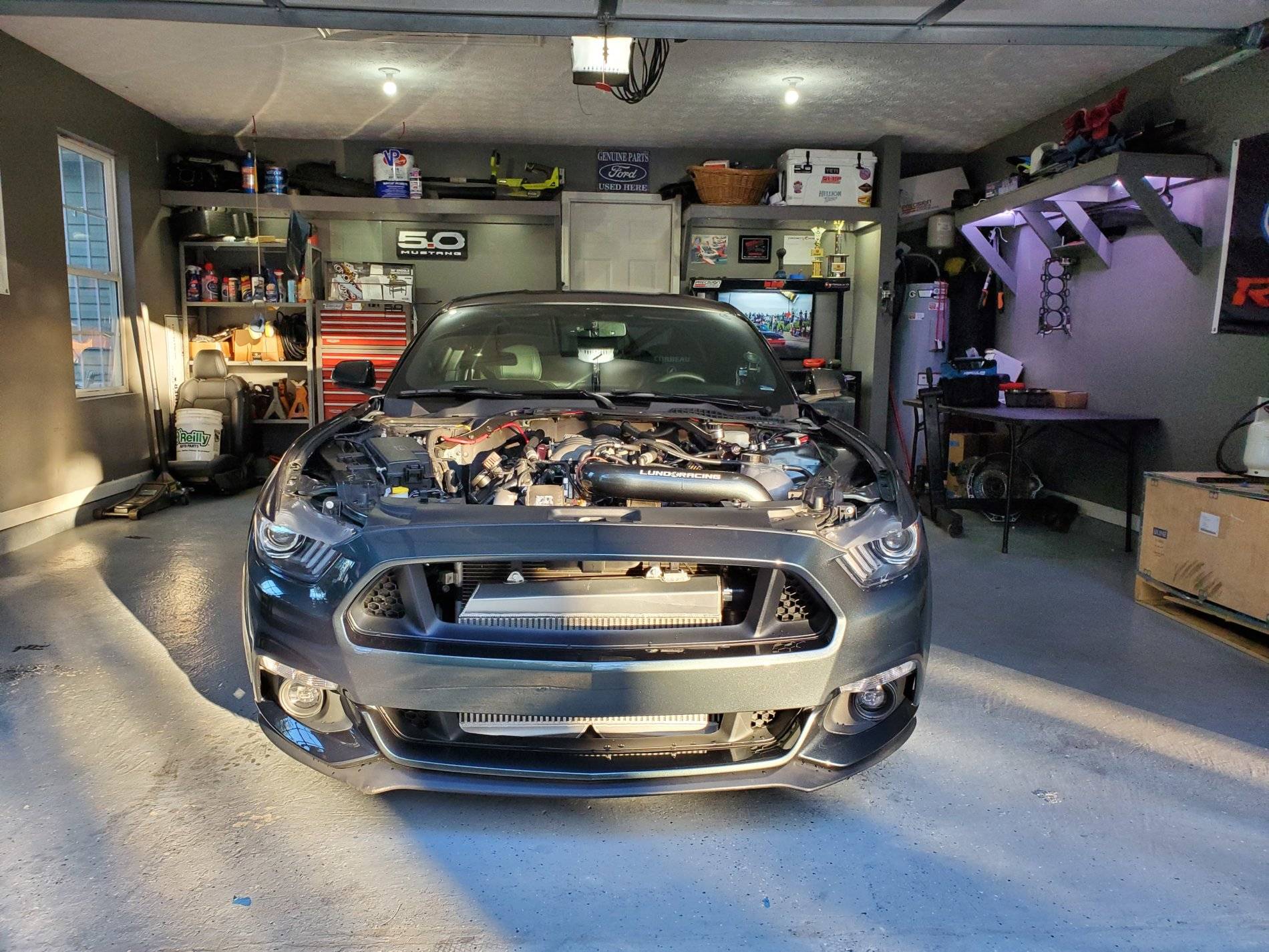

Made a huge amount of progress, got the motor built and in the car all in 4 days... Jan 2 was a bare block to in the car running on the 5th!
Here's all the pics from the build!
80FoxCoupe
Mar 28, 2018
52
5,536
6,298
Cincy, OH
16 GT, 80 Fox
What head gaskets did you select? Nice build!!

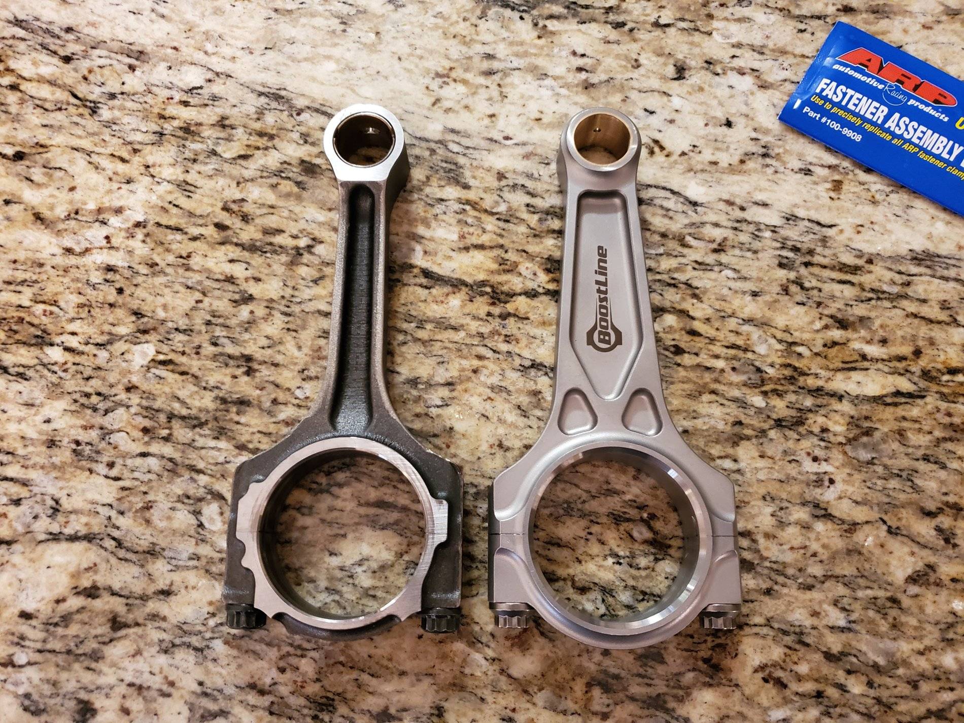

LOL at the OEM rods. Like tiny lil toothpicks compared to boost line.
