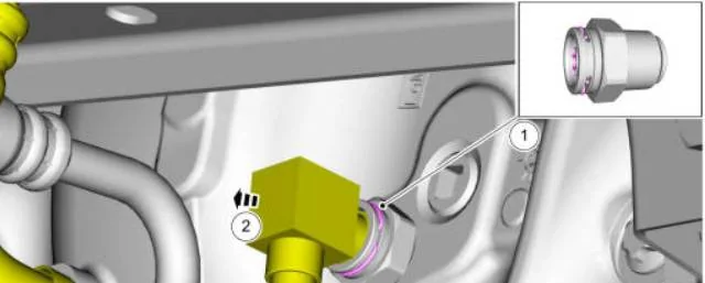

Here is a picture showing the fitting from Mitchell.
Yeah, this type of fitting (called "Quick-Connect") a few other domestic OEMs like Chrysler use it for various hydraulic line fitting attachments, just like transmission cooling, for e.g.
The clip is what ensures the line in stays in - it doesn't seal the fluid in. The line has a lip that matches the clip and the part that is indexed/keyed. The clip pops out either with a special tool, or a correct-sized pick.
Meanwhile, the Quick-Connect or hex end of the fitting, attached to the diff cover, has o-ring(s) usually, which is what actually should seal the fluid in, on this side of things.
Can't say for sure, but as Lee said, based on the pics, the leak is coming from the hex "Quick-Connect" segment of the line, as that is the component that usually has the o-ring(s). Perhaps an o-ring became out-of-spec or if they are actually in there to begin with, crushed, or who knows what.

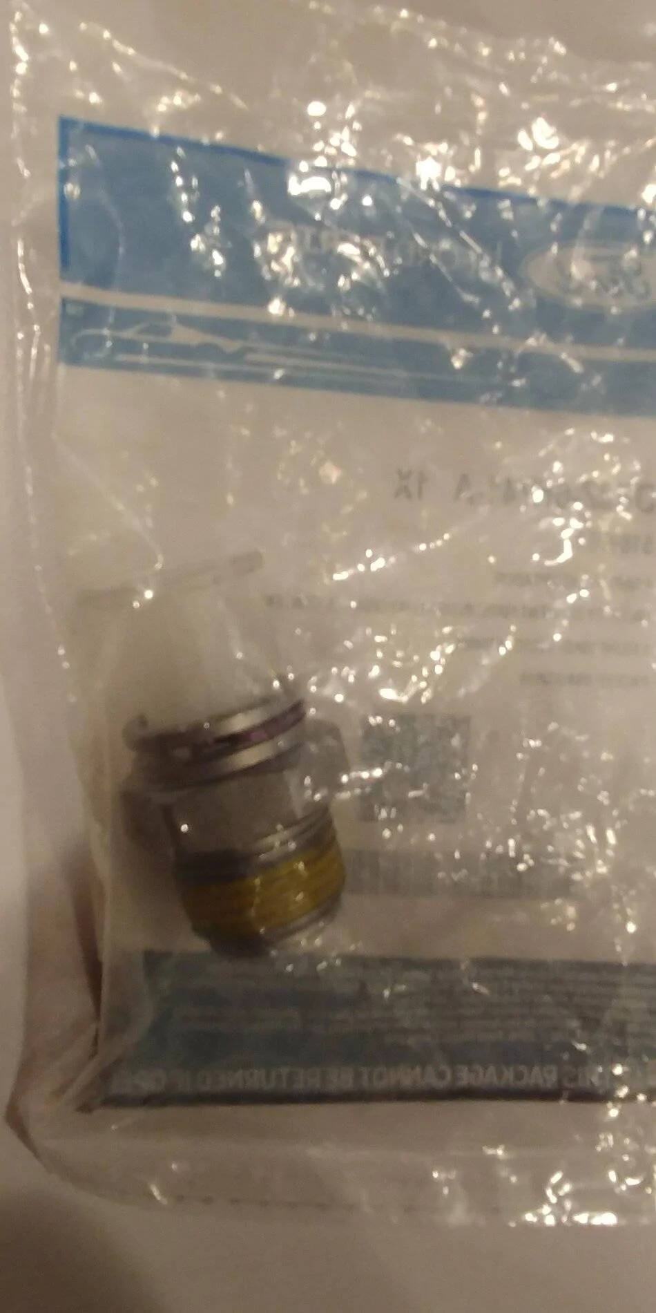

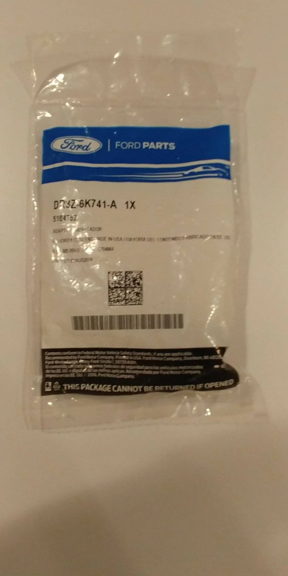

I found this. The o ring is inside this part the clips just keep the nipple in place.

Trip to dealer went as I suspected. They looked "yes it is leaking we need to order this part". It will take four or five days. I had them top off the the oil. I have a big piece of cardboard to put under it.
