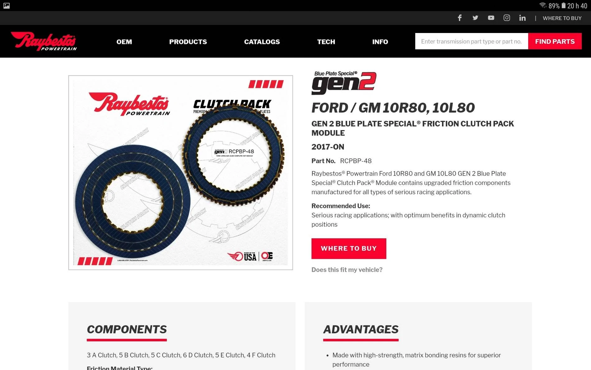

This seem new for the 10R80!
Don't know if this blue friction material is better than the GPZ !?

I've increased the clutch count on mine by machining down the steels and pressure plates, I was going to order the blue's but Raybestos didn't have any real world feedback on them. They couldn't tell me if they are better than the GPZ material or not and since I have a new set of GPZ I'll use those.
I have sent a email to Raybestos to see if I get the same answer. It's weird they cannot tell if the blue are better than the gpz or at least a pros and cons in our application has they are the one designing and producing those different clutch liners!

The blue frictions have been around a long time, the Gen 1 material was very aggressive and used to eat up the steel separator plates. This new Gen 2 material was designed to eliminate that problem. The GPZ material is used in heavy duty commercial use and also in high torque diesel applications. The 10R80 is not like old school transmissions where clutches are applied and released quickly, many of it's packs stay applied throughout many gears. The GPZ material is designed for high stress and high heat applications, the blue material is designed for racing which is usually short duration applications. I'm not sure how they would hold up in a street use environment. As for the added frictions I don't want to say too much as I'm in an experimental phase and nothing is proven yet. I will say I've added 2 to some and 1 to others.

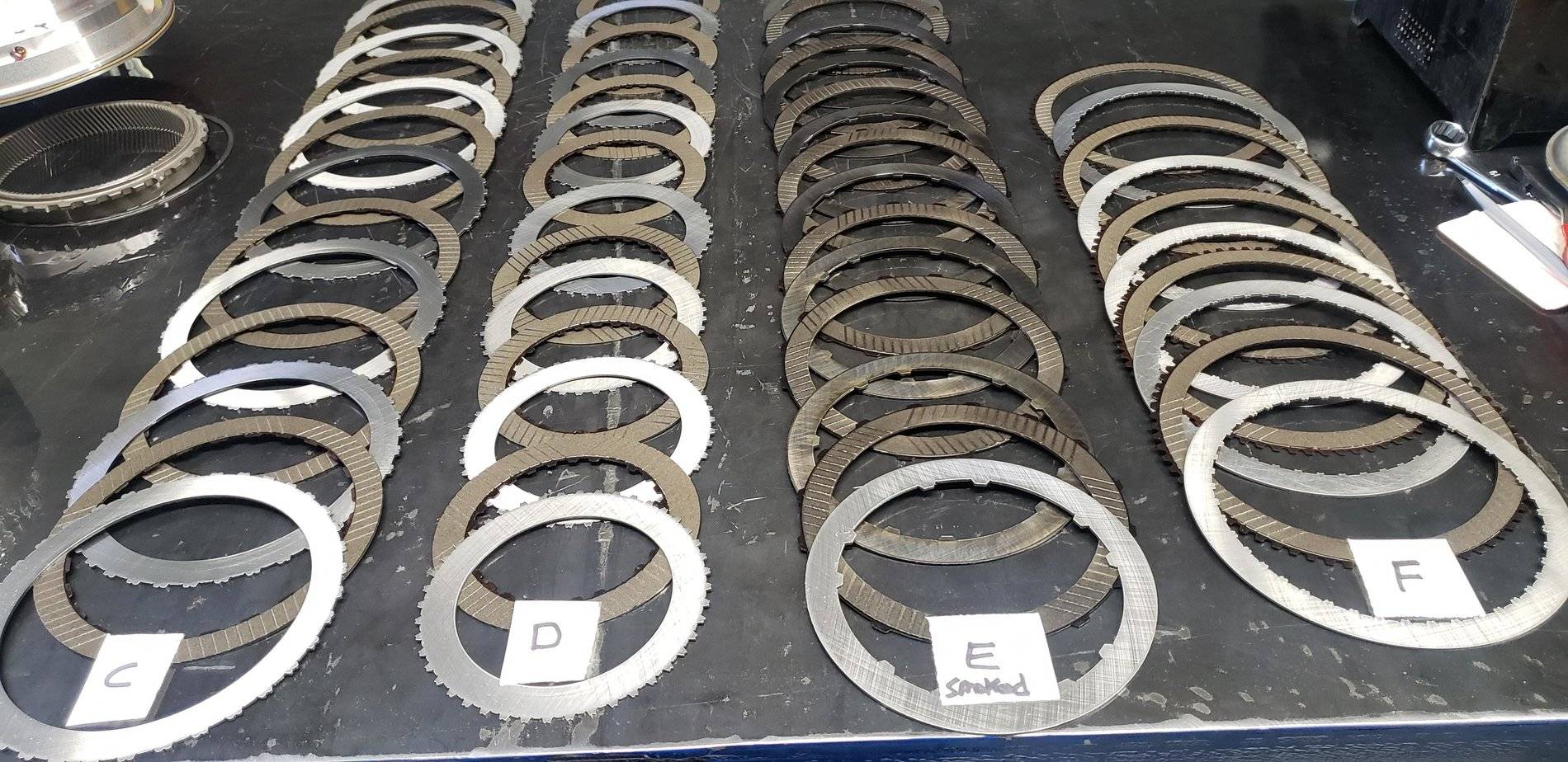

Worked good except for the E clutch pack, with the added frictions the steel plates are too thin to with stand the heat. The rest were mint as per the pic.

The frictions don't like to grab under around 190 deg from what I've seen if the fluid isn't hot enough you will get a flare on shifts. If trans temp was the issue all the clutch packs would be affected not just one, the E pack carries a lot of load hence the heat build up with the thinner steels. I added extra frictions to all the packs and E was the only one that had issues with the thinner steels, from what I know Midnight had issues as well. In the end they only add 1 friction to D & F packs and leave the rest stock count. Honestly the 10R80 is a great trans but if your goal is over 900 whp and a racing environment you will have continuous issues no matter who builds it.
