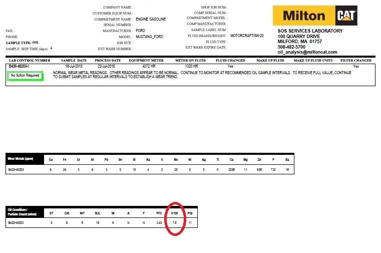

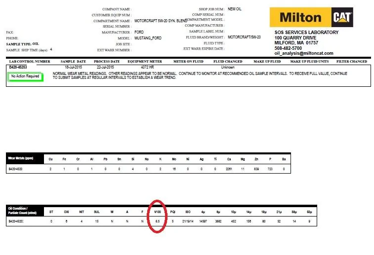

This has been beaten like a :repost: on here. Happy to see more reasonable comments. Our car is a track day car, run in the heat. Hasn't blown up yet.
I've attached my Motorcraft Syn Blend 5W-20 sample results. I know the oil is horrible, look it turned to water LOL :crazy: Complete Junk ;)
We run 5W-20 EP Mobil 1. I come from the industrial engine side (Multi-Million Dollar Engines) So I've seen lots of oil samples in 20+years. I also get very good off-the-cuff recommendations from oil suppliers.
No issues with OE Fluid in our car, no issues with Mobil 1 EP. It was suggested by a supplier to try the modern diesel oils due to their superior additive packages IF I see unfavorable trends.
We use CAT for our samples, because this is just a simple car engine, no need to complicate things. $18 a sample and it tells me all I need to know.
